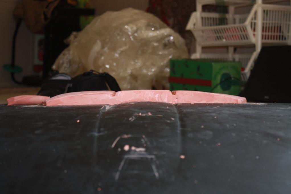

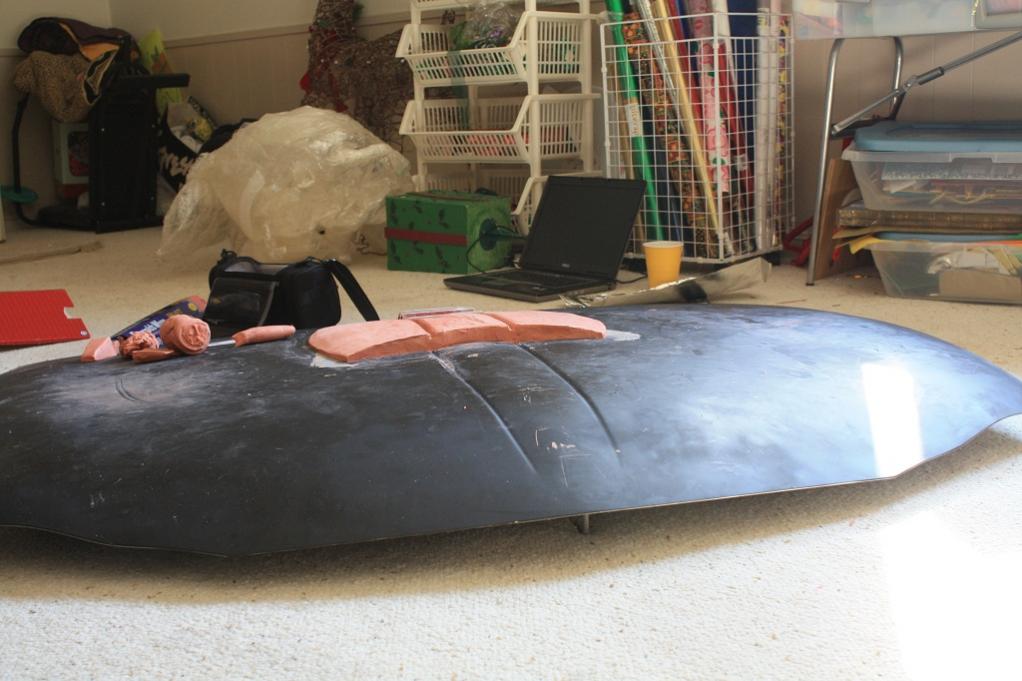

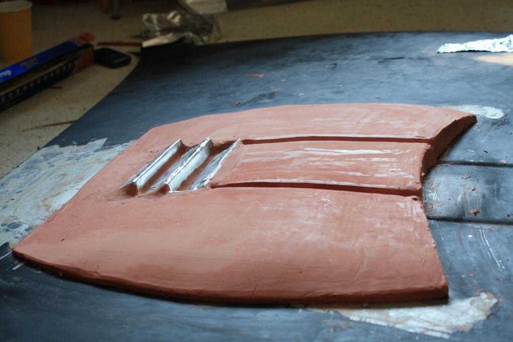

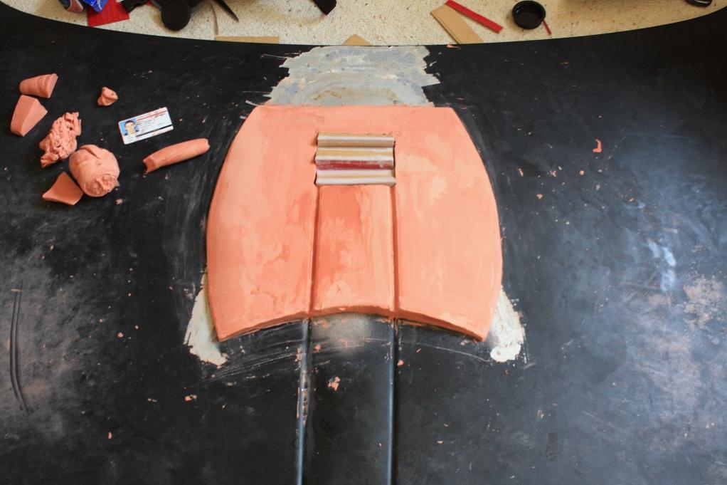

Here's the new hood so far, due to some financial troubles its taking a bit longer than i had hoped. But until then heres a fun fact, a grand prix hood fits on a monte carlo with about 1 inch gaps to the fenders, and it doesn't fully latch because it sits on top of the headlights lol. Anyways the whole mockup was made with some oil based modeling clay and my old probation ID for drag racing (used to smooth everything out the rest was done by hand) The center piece is foil and cardboard because there is a whole underneath and the clay kept drooping. Pretty soon i should be getting enough plaster to make a negative, then I'll be making the whole hood from fiberglass. Any tips or critiques would be appreciated.
Oh and as much as the second picture makes it look uneven, I've measured it from every angle possible in a 3 dimensional universe.
