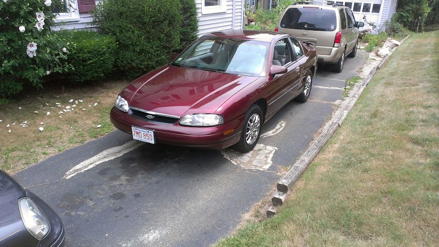

i removed mine painted it black where it was and later lost my embelm when a guy backed into it you barely notice the 2 holes my chrome ring is also plastidipped

this was when i kept the embelm and painted the grey surround black. Wd40 and a flathead and pull the that crap away
