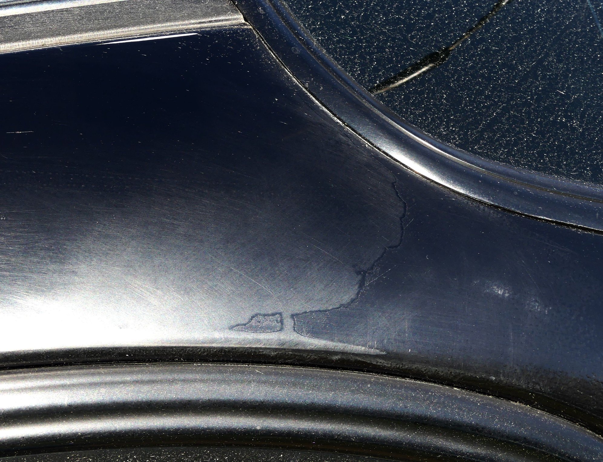

You can see where one paint job stops and another starts. Hard to see in most light, but it feels like I should put something on the duller area to protect it.

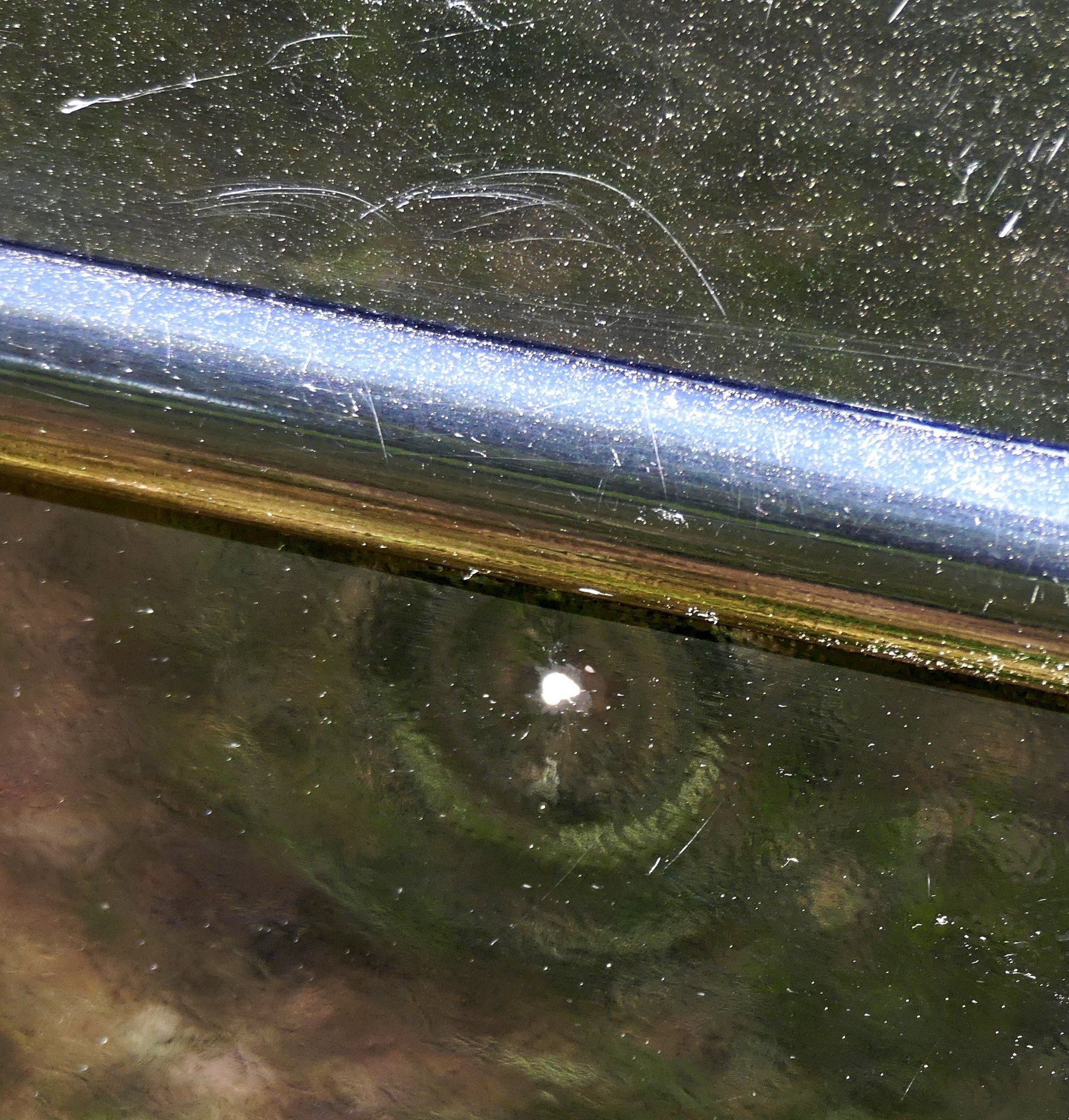

Ping! Here's a twofer--you can also see the scratches above. I am most concerned with protecting the car, rather than making the finish perfect. Tiny specks are dust and pollen.

I have had similar issues because of the black paint, I see little cracks in mine now too.
The first one appears to be a loss of clear coat, most of the others can be touch up paint.
When I was working on some of the issues with mine I went to Auto geek . com and I found they had some video's on how to stuff. The dings can be pulled using one of those little dent pullers that are available you put some glue on the ding and then work out the dent with a puller a bunch on the market. Only do it when it is warm out. Dr. Color chip is another place I found that has paint that will work and they also had some how to stuff.
