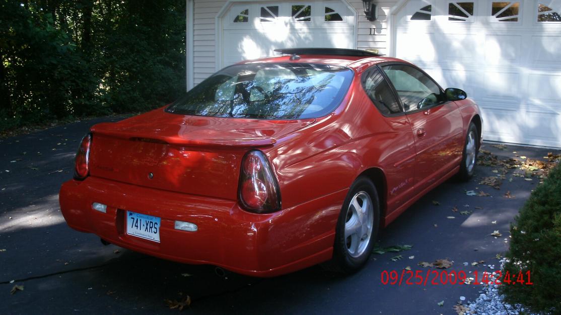

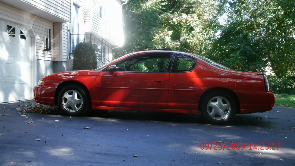

I bought an 03 victory red SS and the monte carlo signatures and the ss's on trunk and on sides are red too!
Looks real dumb..Probrably look better black or chrome..But
1. Can i take off the trunk one woth no holes underneath?
2. I heard the side ones do have holes..is this true?
3. My plan was to get the aluminum big ss's from ebay ($24 for 3) put new bigger SS where (mont carlo ss) was on the trunk,leaving the red bowtie...and the side (monte carlo ss's) weel id remove them and move to both front side quarter panel.
4. OR I would place the larger SS to cover the holes (if any) on rear side quarter panels and trunk if nessacary..

All 3 are on with double-sided sticky tape.
Just take a blow dryer and warm it up, then use dental floss and see-saw it off pulling away from the car slowly and carefully.
Or you can try 3M remover.

Default pics from above post
Attached Thumbnails Another emblem idea..suggestions please!!-005.jpg   Another emblem idea..suggestions please!!-006.jpg

Thanks ..another monte site says "side ones have holes underneath"..i hope its not true!!
Old Sep 28, 2009 | 01:22 PM
Just the door moldings have holes.
Not the emblems.

All SS's and wording monte carlo removed..2 hrs! Only rear red bowtie left.. what a cleaner look!! may put new or available aluminum SS's on upper side of front fenders and remount the red or aluminum SS on one lower left side of trunk ..
