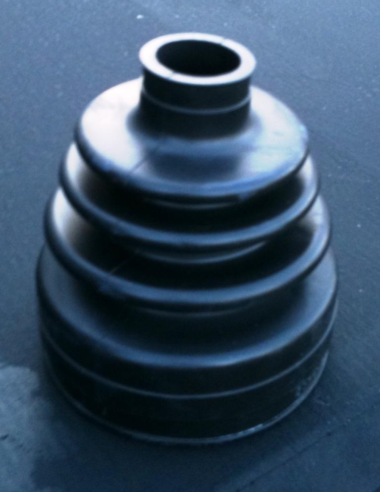

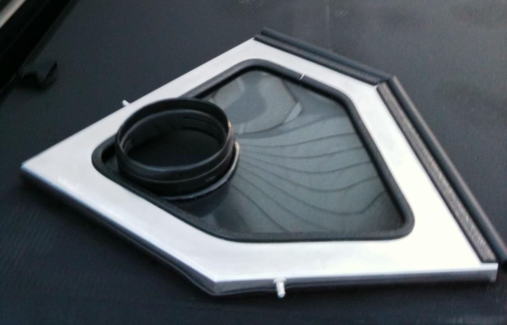

Hey all I hope everyones Monday is going good . Here was my weekend project for the Monte .I have been struggling how to connect my hood to my CAI so we cut a 4" in the new hood and a 4" hole in the CAI but where you have to put them foam was not going to work for me (well that is not true because it would have worked but there would have been only a 2 3/4" hole for air to go in to the CAI with a foam ring and I wanted more air flow than that ) So I went to NAPA and went exploring through there car parts I needed something that was 1 1/4" tall and 4" in diameter and soft enough to make a good seal between the hood and the air box and this is what I came up with. I think it came out good
