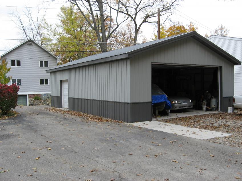

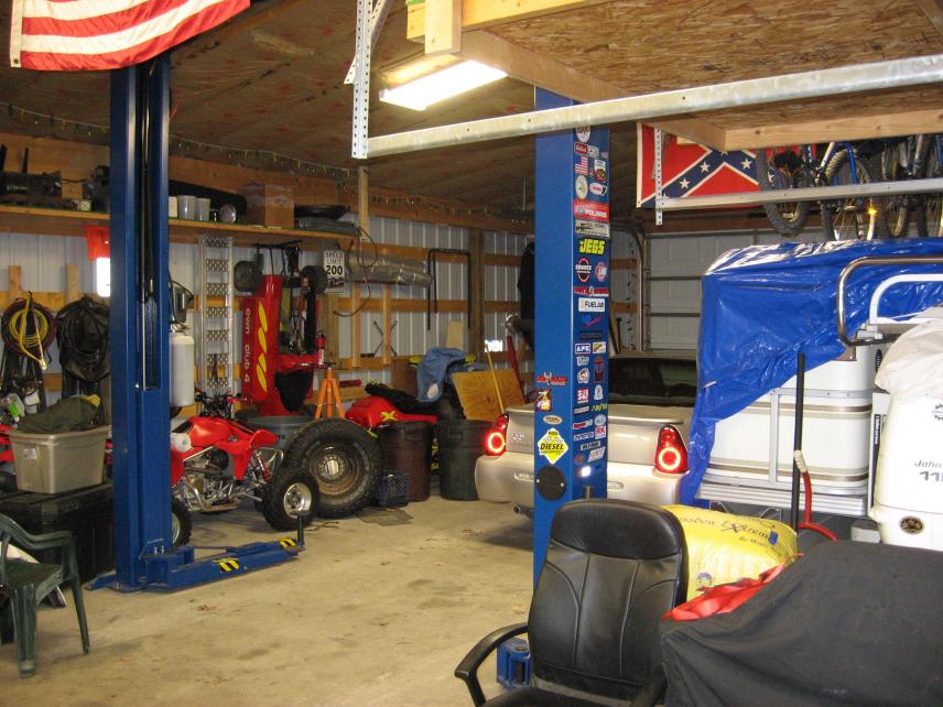

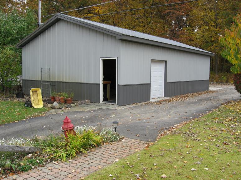

Hi Turbo
Hope these pictures loaded as I am new to this forum.
My barn is 26x40x 10 ft walls with scissor trusses which are 4/12 exterior pitch and 2/12 interior pitch..
This worked out fine to sneak in my 11,000# Lift My son can raise his 1 ton Dodge Ram on it all the way with room to spare. I didn't go 12 ft walls as I have overhead wires that restricted my overall height.
Main door is 9x18 to make entry a breeze for anything
Side rollup door is 7x7 and is wonderful for getting equipment in and out
If I could have I would have gone longer and wider as you never have enough space , no matter what you plan for.
I also put a 16 ft long 6x6 up in the trusses to spread the load for a 1,000 # chainfall and Im glad did
Hope this helps

Thanks for the pics that's exactly what I want I just can't go that wide. I'm hoping 21ft wide exterior dimension will allow me to get 2 cars side by side.
Garage looks great!!
