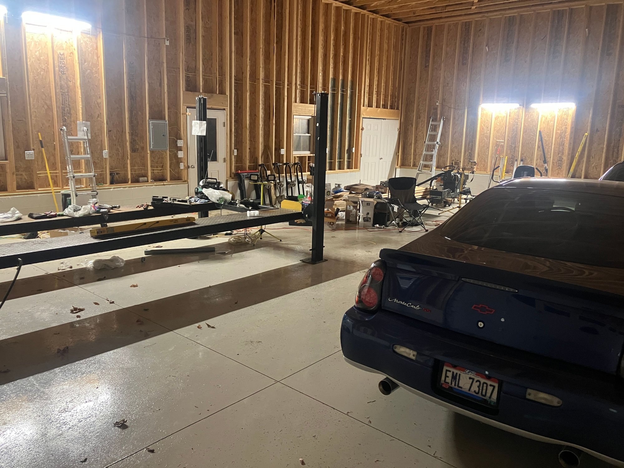

I feel ensuring items on the ceiling can be easily services is very important and a big problem later if I don't plan for it today.

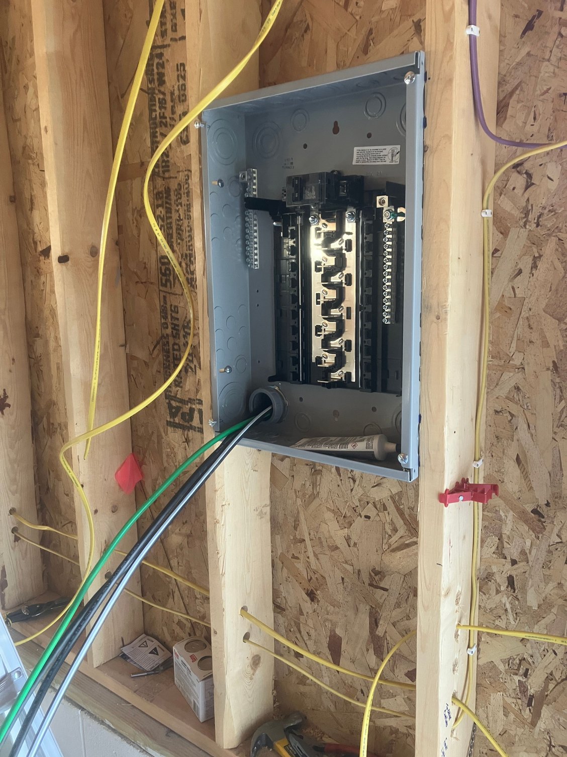

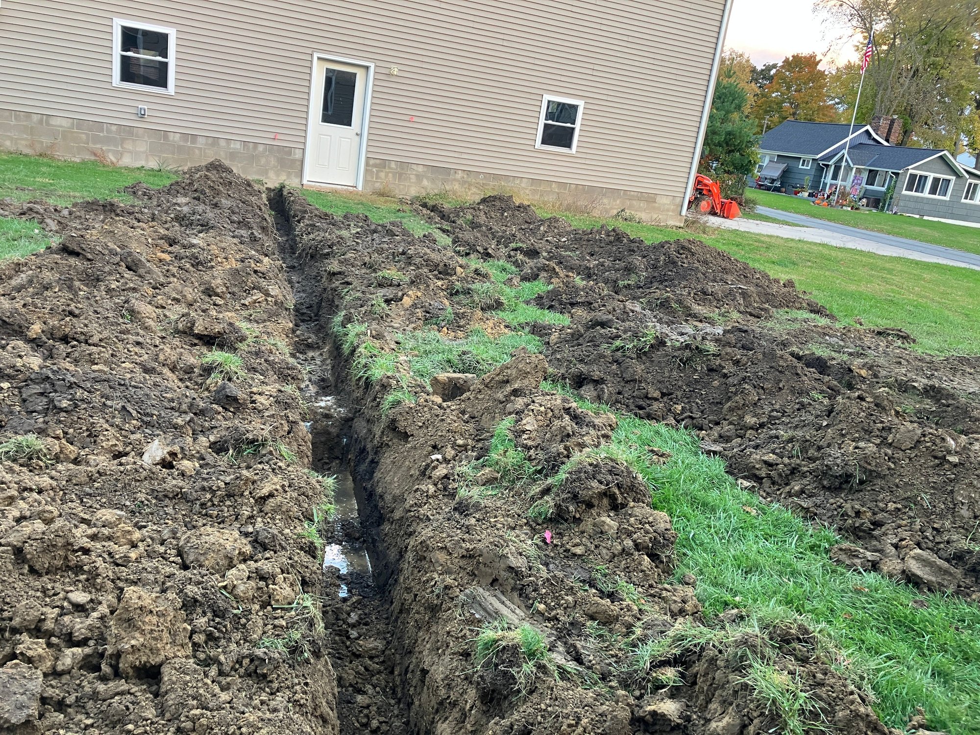

I FINALLY HAVE POWER!!!

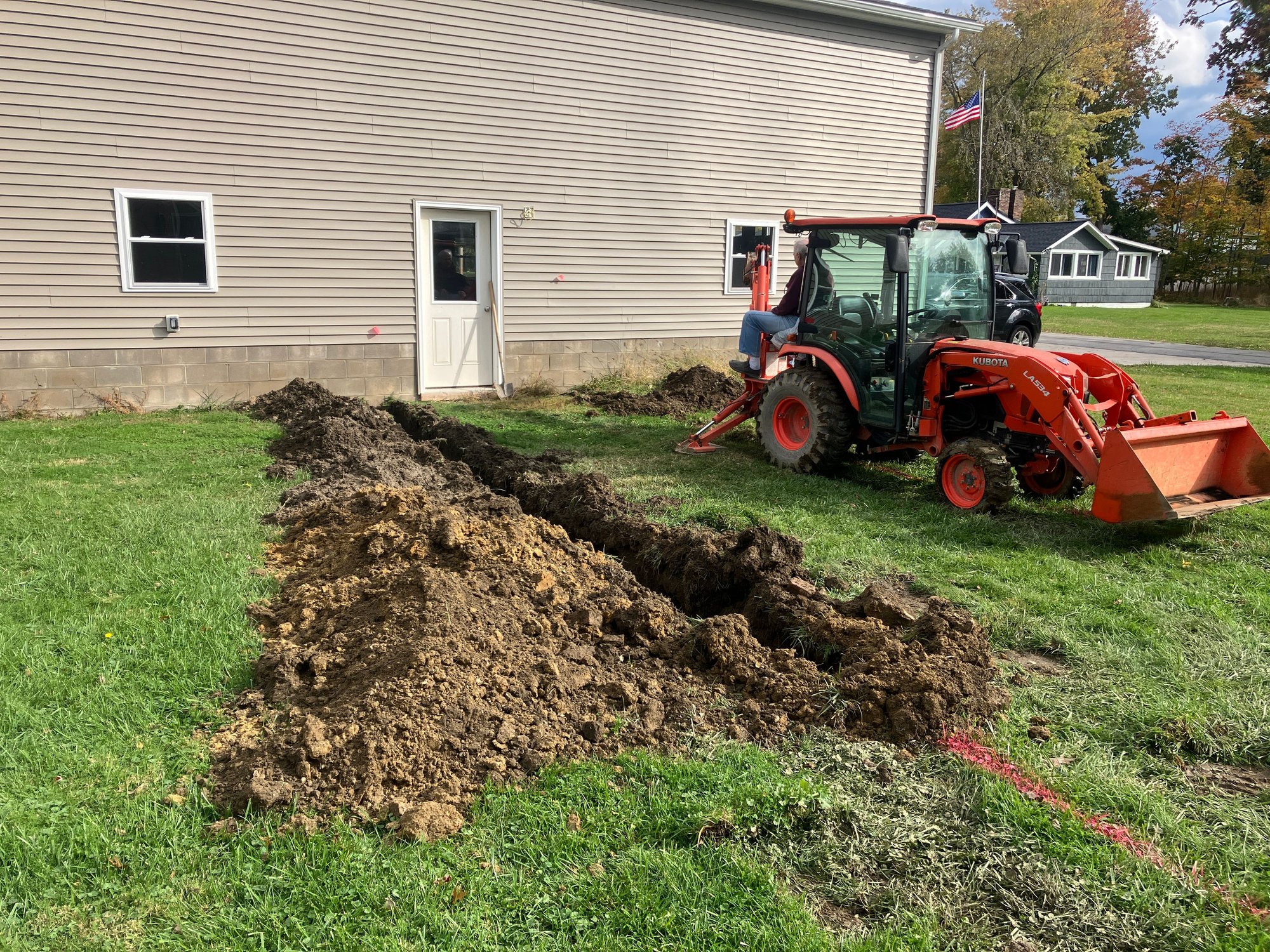

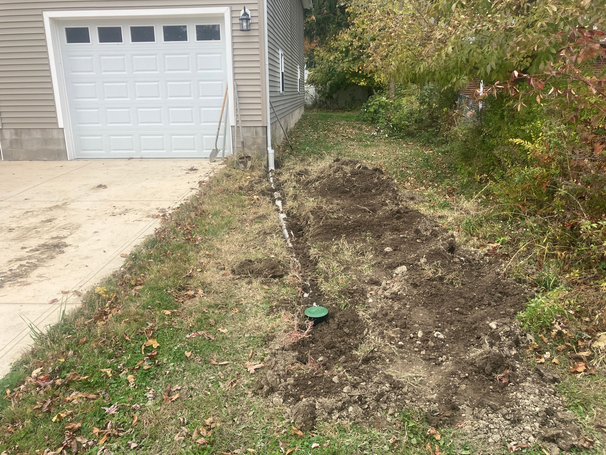

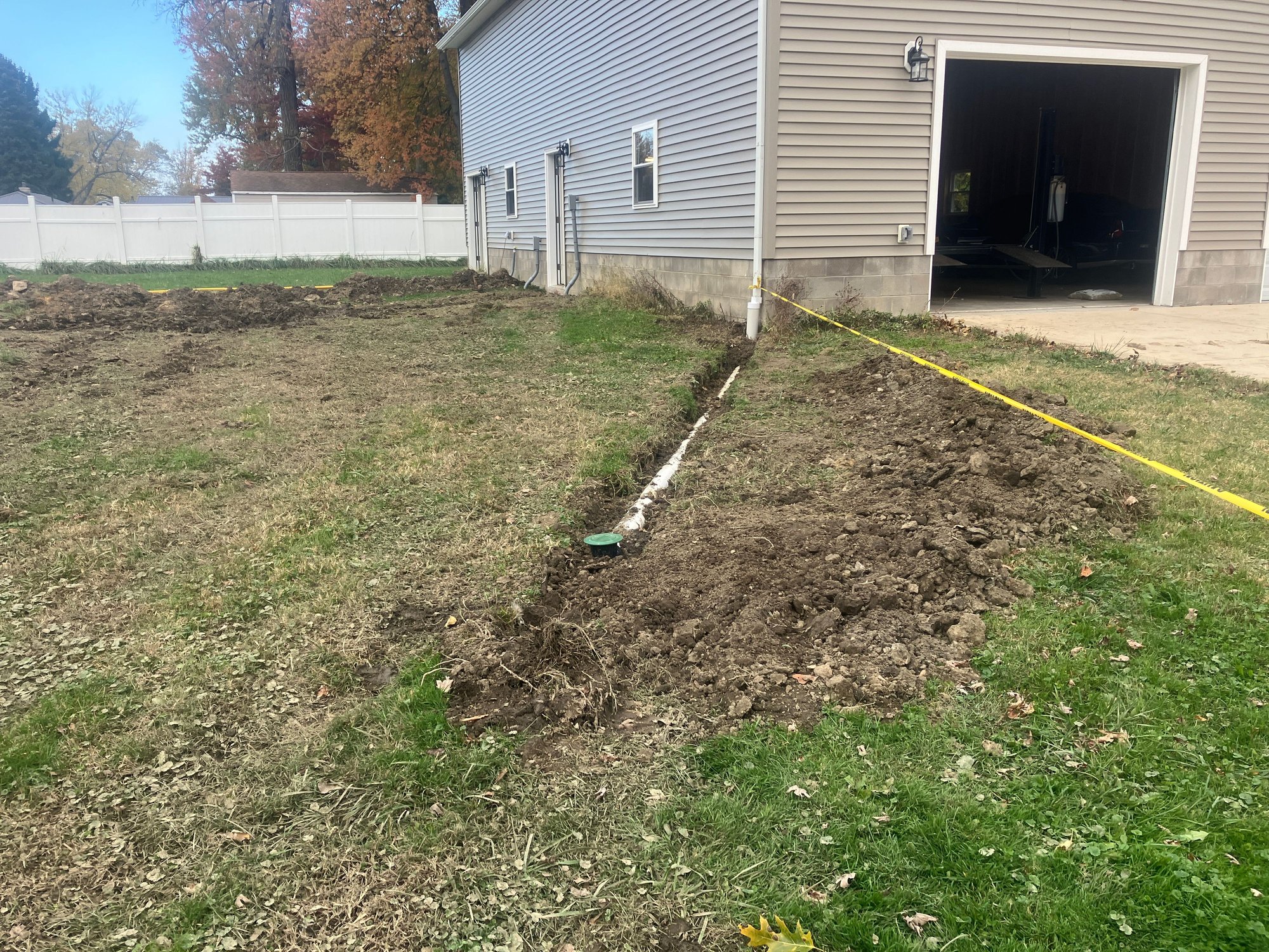

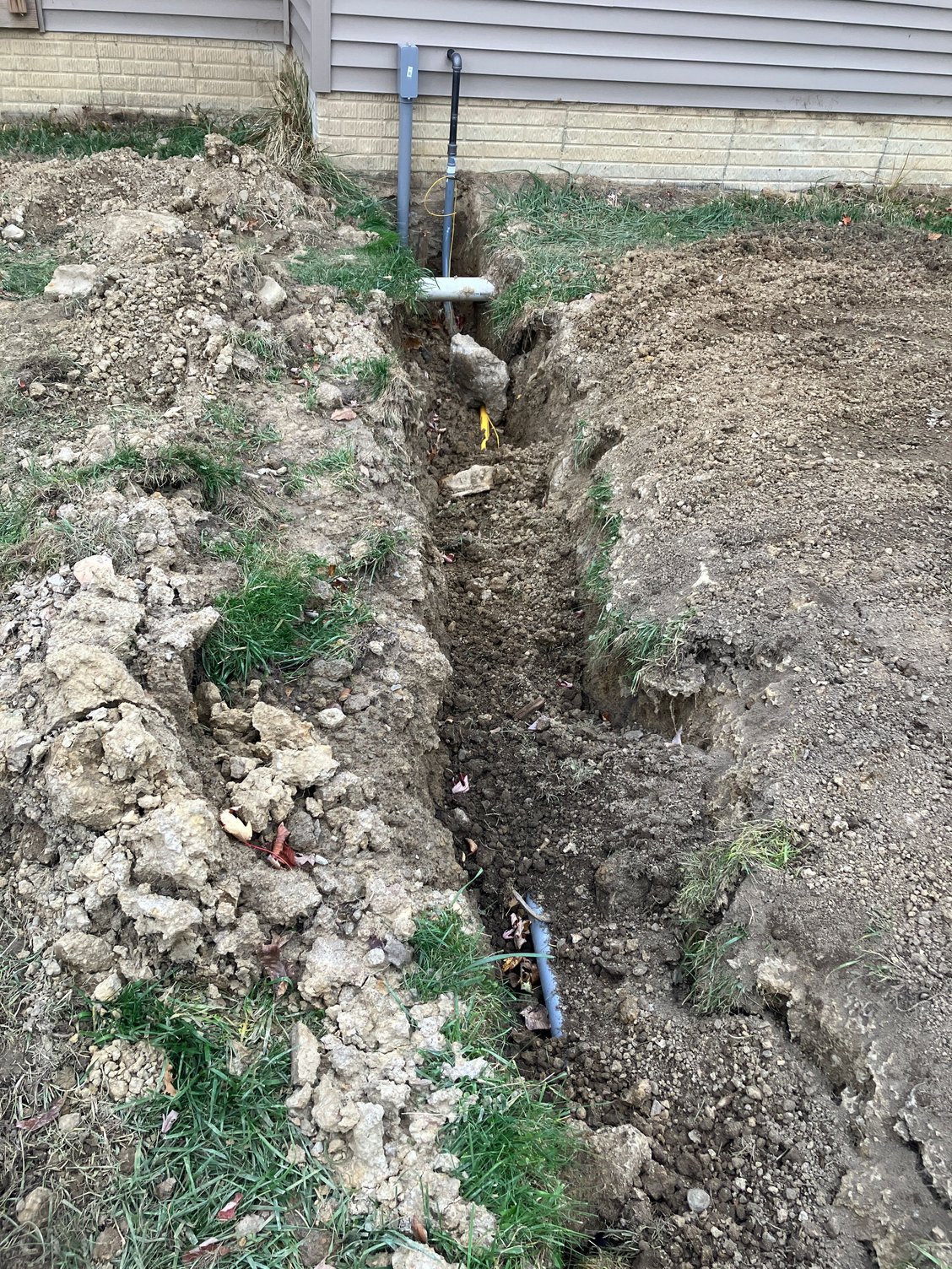

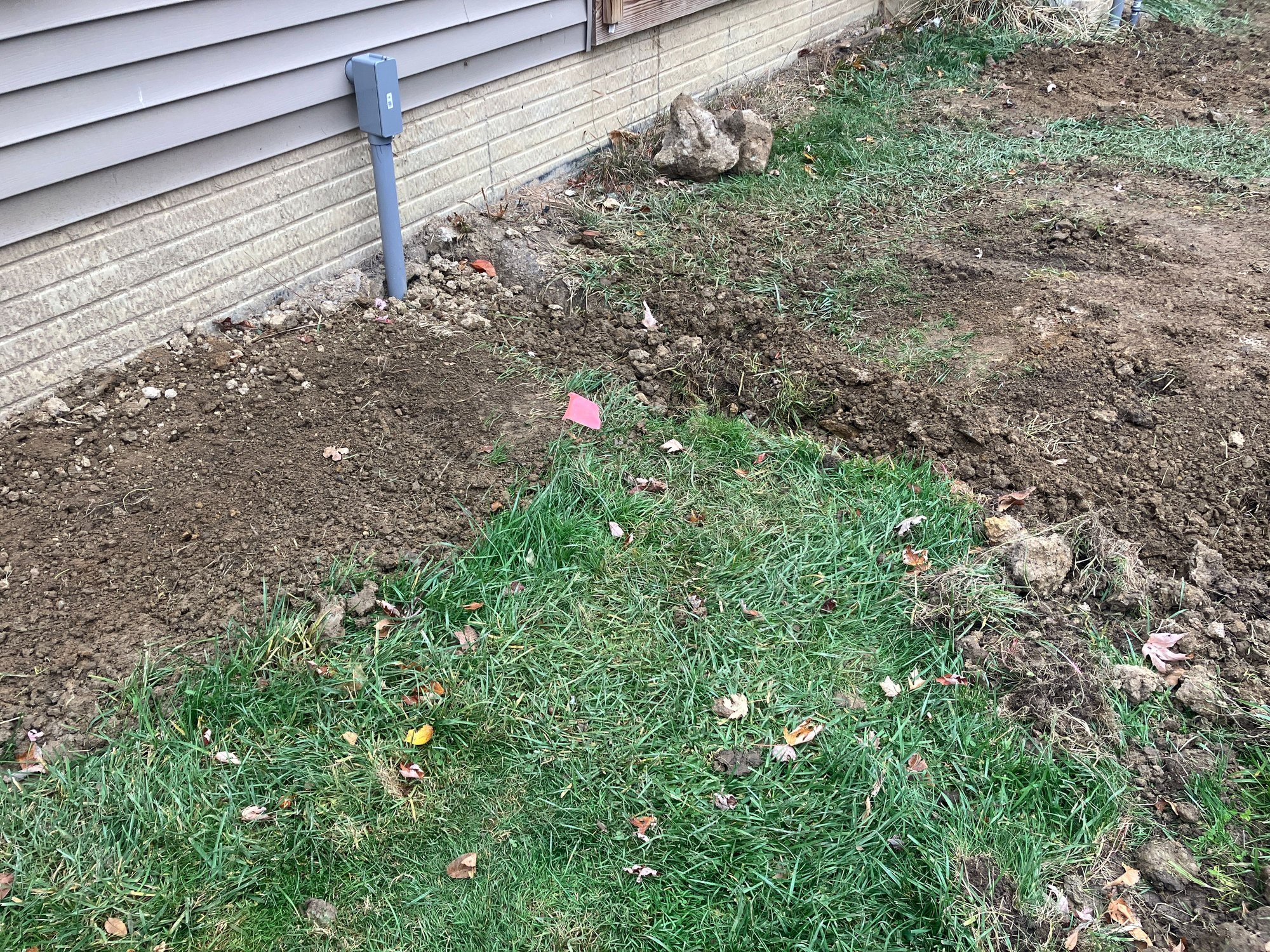

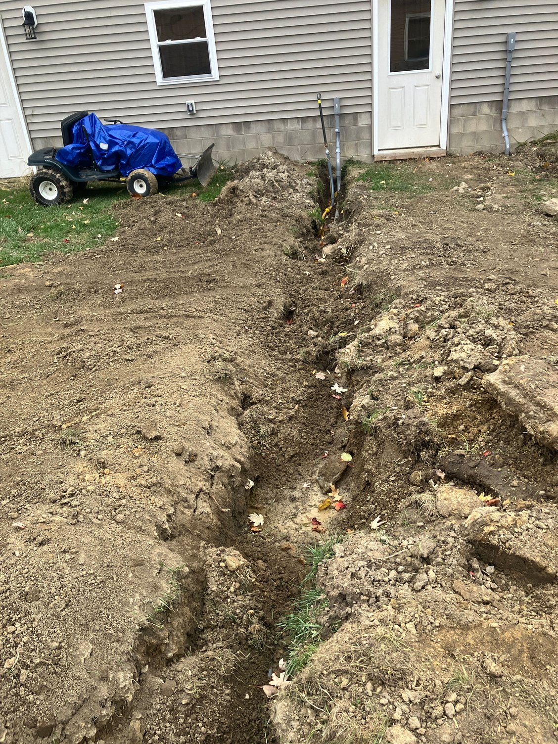

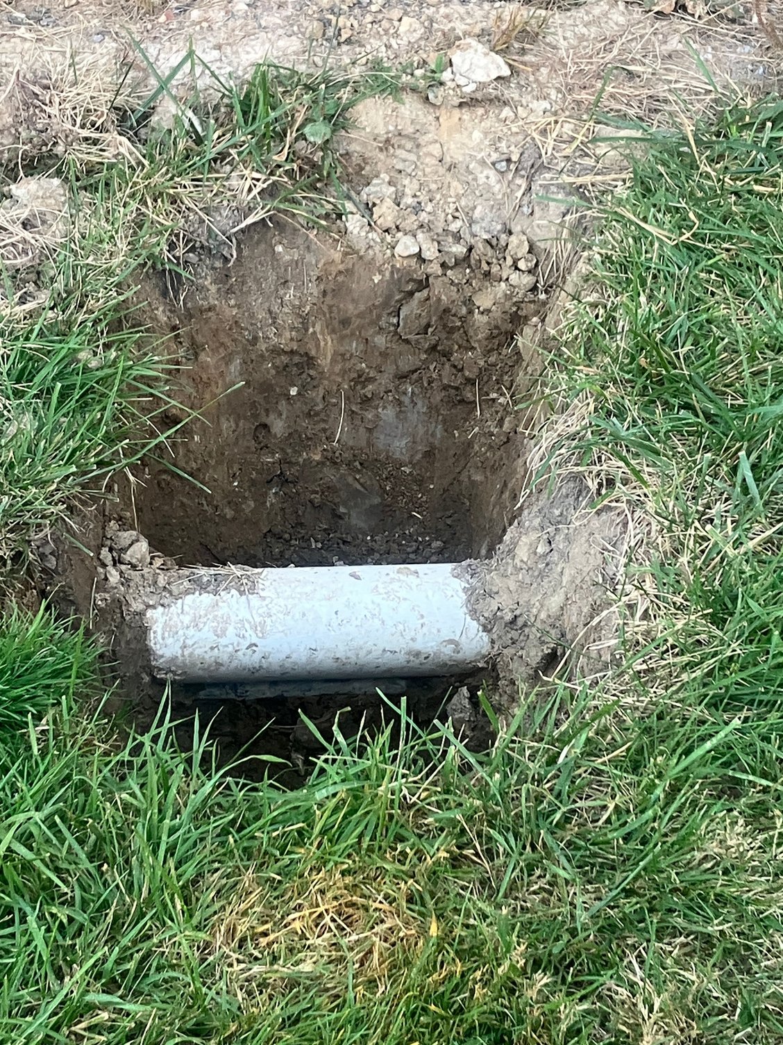

Through out this year, I have been running wiring in the workshop for outlets (indoor and outdoor outlets). And then I had a bunch of stuff going on that said "not the right time to trench the yard". I started planning late August/Early September to get supplies and trench the yard mid-late September. I lined up a trencher from the local Home Depot, went to use it, long story short did not go well, would not dig deep enough and had trouble digging at all. After I returned it, I learned a friend of mine brought his Kubota Tractor that has a back hoe on it from a property he is working on (hour away from here) home for some repairs and a tire. I know it is a pain to load and transport, hence why I did not ask if he could bring it by (him and his wife are there every weekend using that machine). Since he already had it in town, he was able to loan it to me after he got the repairs done and the tire. Took a little while, but was well worth the wait! I still had to hand dig near the house to avoid damage to the sprinkler lines and downspout drainage to the house.
Saturday, 10/25/2025 I got the use of the Kubota for about a week, my dad and I went to work. I let dad have the fun job lol. I wanted to go 24 inches deep, but ran into remaining footers from an old garage or house or something. Fortunately, it was down deep enough that I got 18 inch depth. I have 4 trenches. Two for the down spots to go to pop-up emitters in the yard, one for electrical and the last one for conduit for network wire and a gas line. At this moment, we are working on the gas line (just to get it stubbed into the house and the garage). I am running a pressure test on it so I know all connections underground are good before back filling.

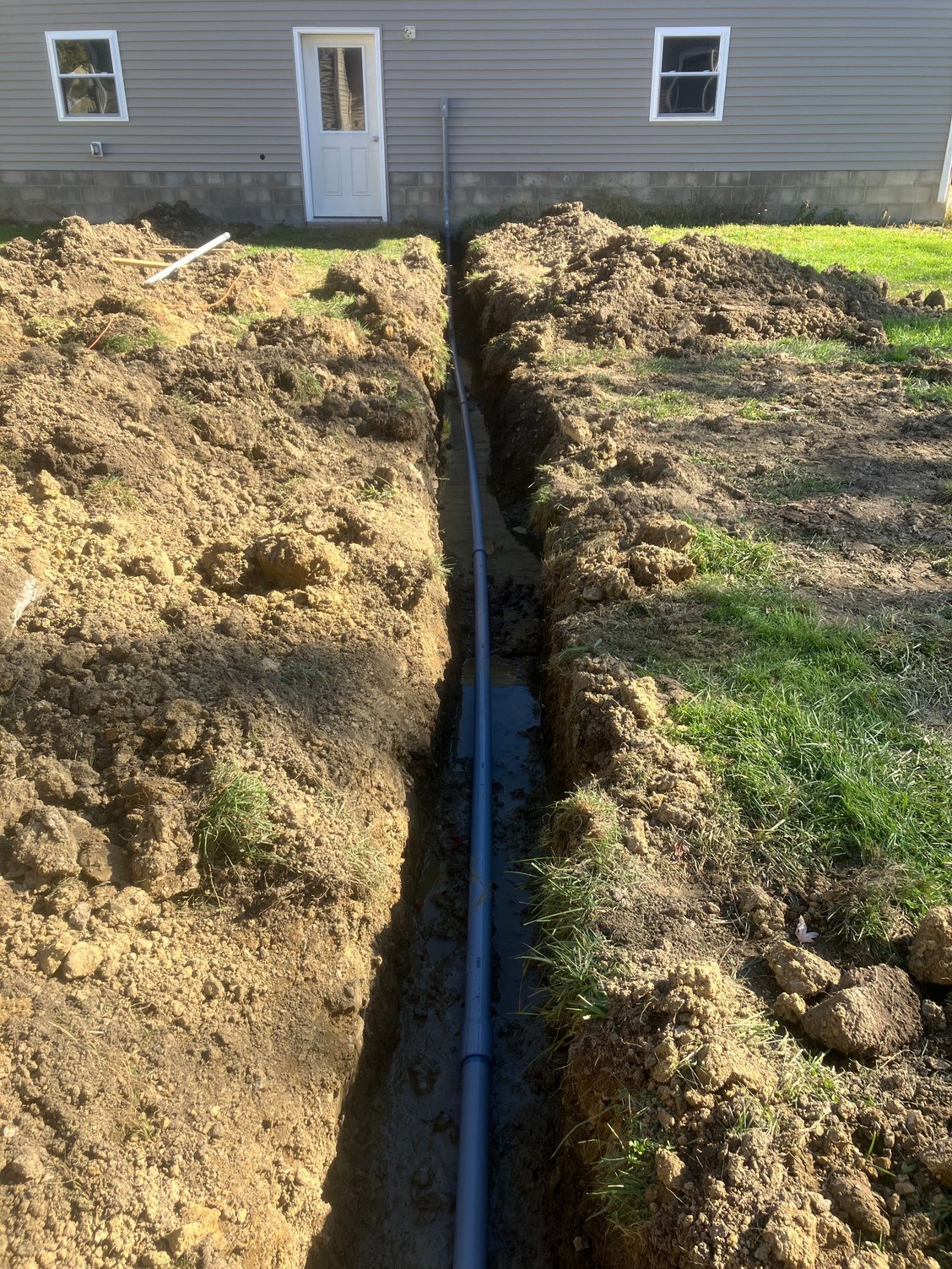

This is a the gas line kit, pretty slick and easy to work with:
Underground 1in IPS New Install Kit (1)1in x 100 ft. Pipe (2)1in Couplers (2)1in Meter Risers, Gas Line Detection
By 10/30/2025, the garage now has POWER!
By 10/30/2025, the garage now has POWER! The lighting I did is temporary, so I have something for now. It actually works fairly well, it will be better if I can spread them out further. Having a 16ft ceiling height, I have been concerned on how to service any lights I hang. But seeing how well these cheap-o LED shop lights work when held on the wall, it might lend itself to a plan to get the lighting I need and making it easy to service.

Thanks! I have a trench with conduit for network wiring and wrapping up stubbing a gas line in the house and garage for future use. For the network wiring, I am trying to figure out what I need. I am thinking 2 for my Lorex camera system, 1 for a wireless access point (bump up my wifi performance), and 2-3 for data (a PC on a bench and an old streaming music player and another "just because")....
I also want to build a mezzanine, then insulate. No drywall, plywood or OSB instead, paint it white. No mudding, no taping.
Old Nov 8, 2025 | 06:36 PM
  #67

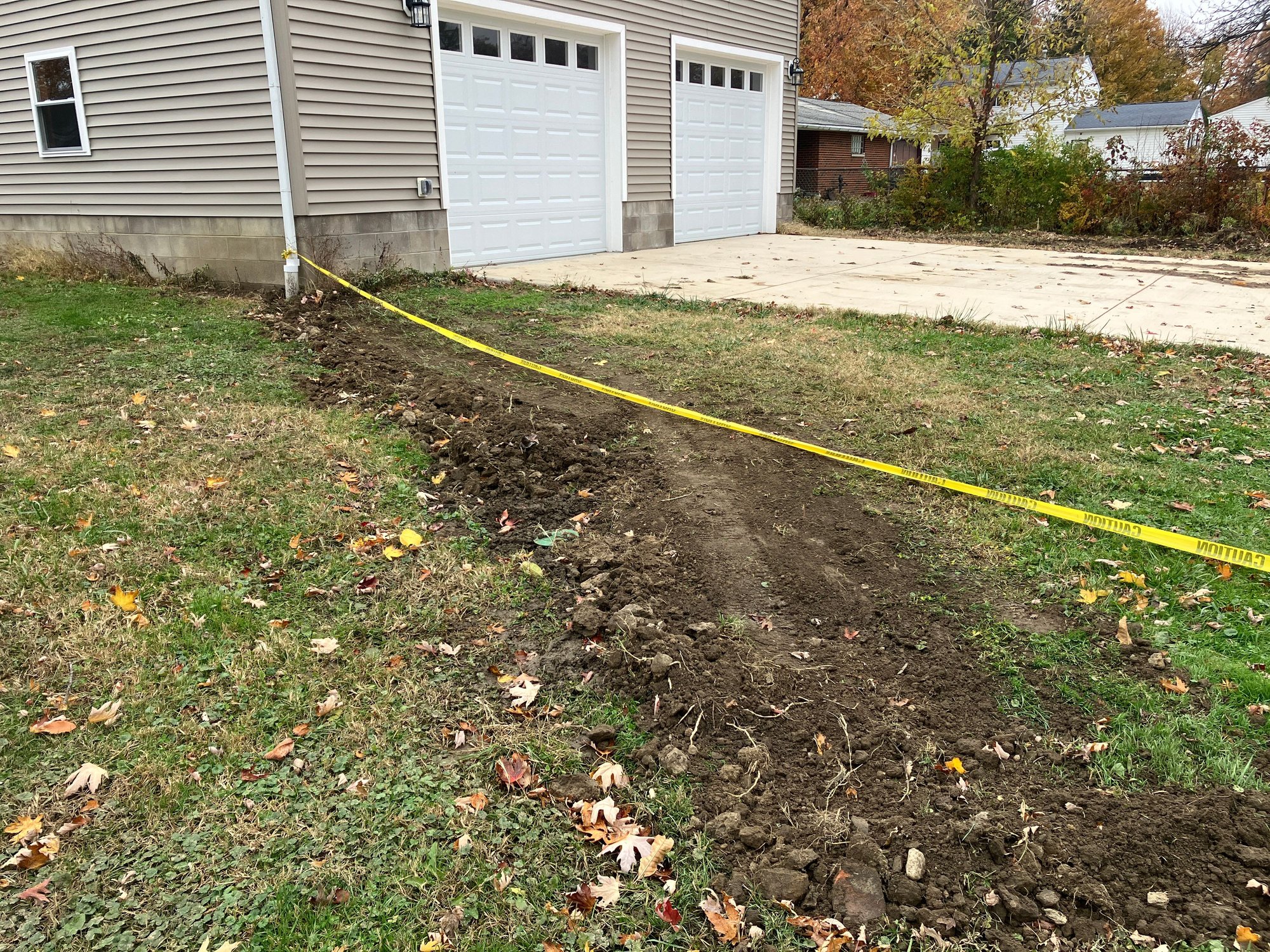

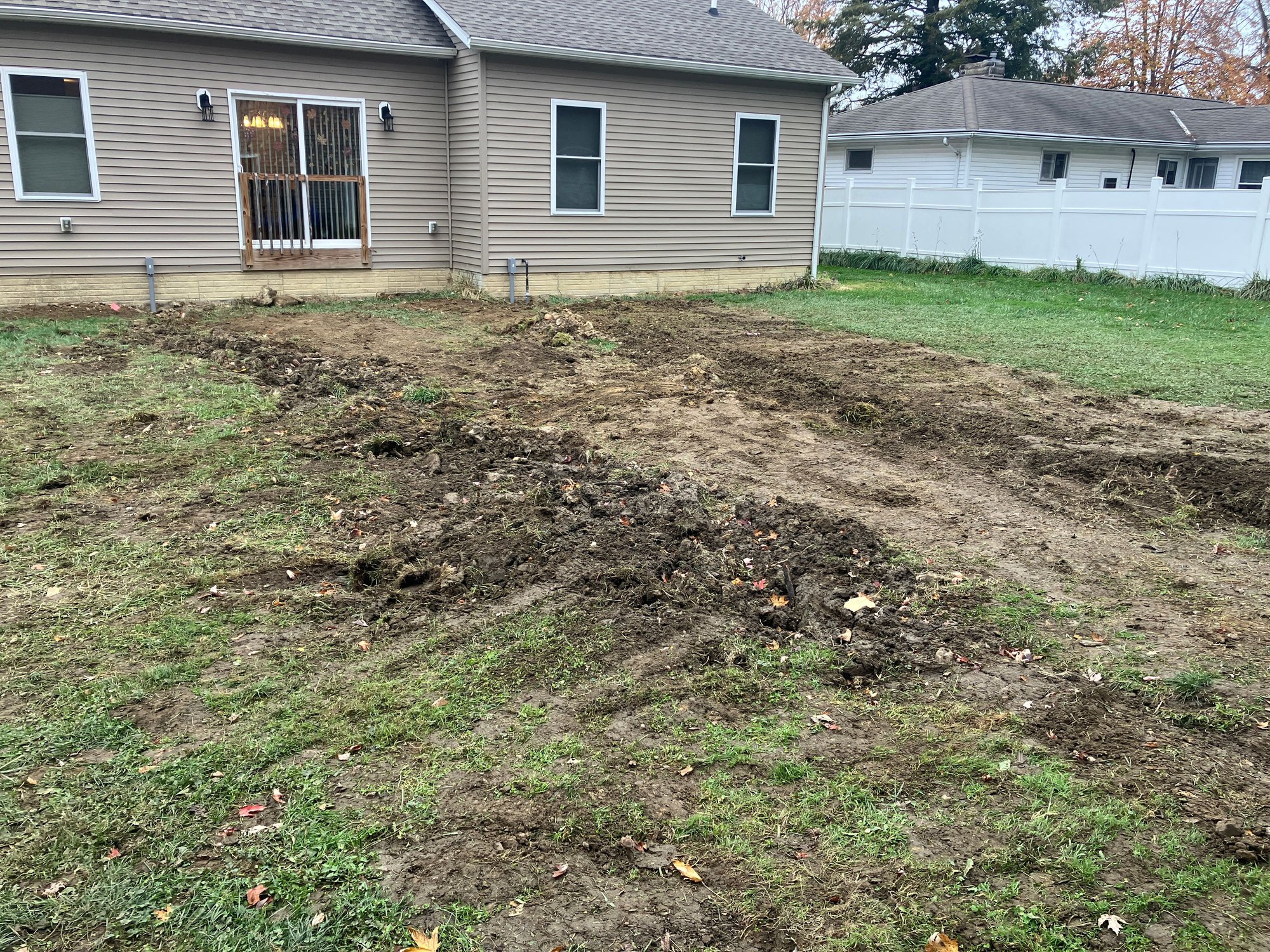

Since I no longer have the Kubota, making use with other tools. Using Dad's rototiller, I ran that to break up the mounds of dirt (and clay, this area has a lot of clay). And then my dad rode a small Craftsman lawn tractor with a plow blade and made a LOT of progress. Today's progress stopped when the tiller started acting up. We did not bury one part of one of the trenches to re-pressure test the gas line under ground (I was going to trim the tubing and started to open the coupler, I want to re-test before it gets buried). The gas line is only being stubbed into the house and shop for use at a later date. THe part of the line in the house is all done and secured, still need to finish the garage side. Once we finish the back filling, the yard will wait until spring to bring in some top soil, fix everything that needs fixed and plant some fresh grass.
