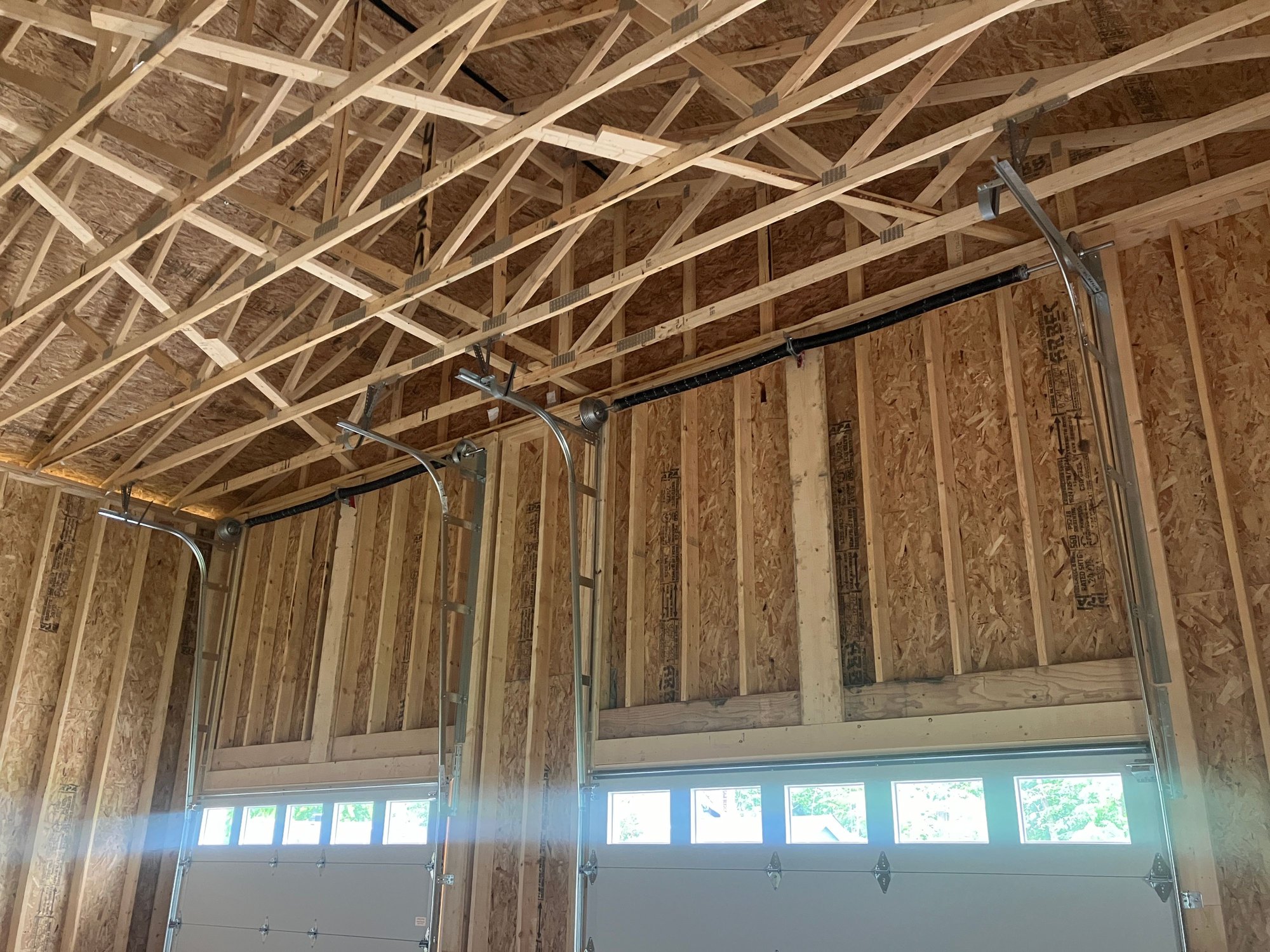

Last Monday, 6/10/2024, overhead doors have been installed. These look great! And they are high lift, go straight up, and only one panel goes horizontal. And it cost me extra, but I am glad I went with windows in them. Just more natural light.

Those are interesting door tracks, don't think I've ever seen ones like that before. Thatll be nice to keep the doors out of your space over the vehicles. I don't envy whoever put up those springs / top track pieces though - thats way up there!
Did you end up getting insulated doors?

Those are insulated doors (I am not sure the rating). And trust me, I look at those springs and torsion bar thinking "that is not fun if it ever needs serviced. Part of my wishes it was an angled lift to put the torsion bar lower (just above the door). But, honestly, those bars ever needs serviced, I think I will be called to have that done. Also, look how much spring is on those bars! I learned that a high lift door requires different springs because unlike a standard lift, the weight of the panels is not relieved because they are not going horizontal.
But I will say, I am VERY happy with these doors. They did cost more than I planned, but they are great! When I add a side mount opener will be even better.

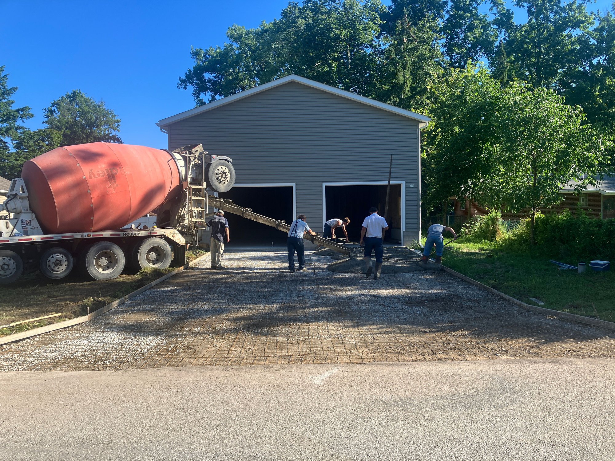

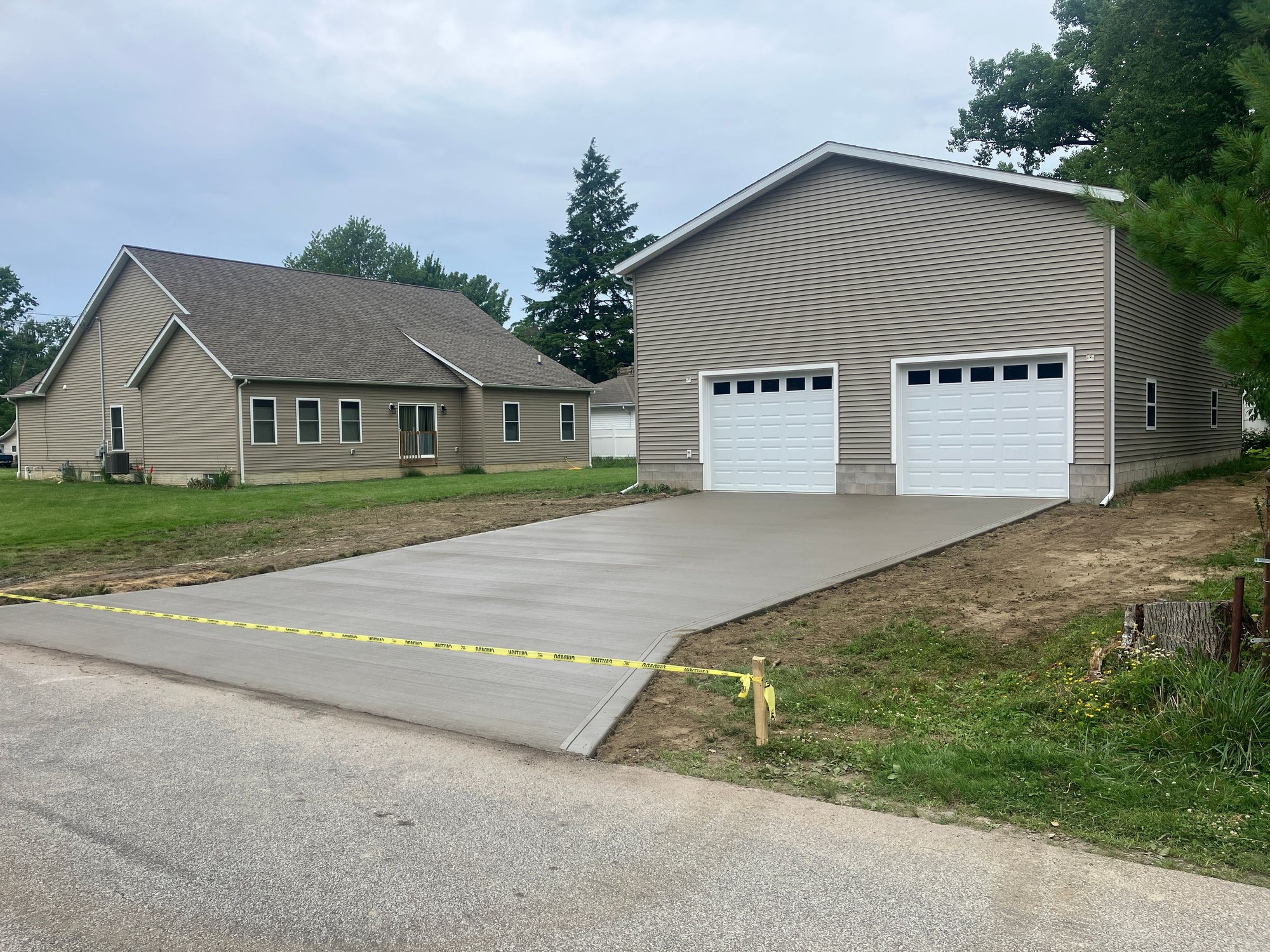

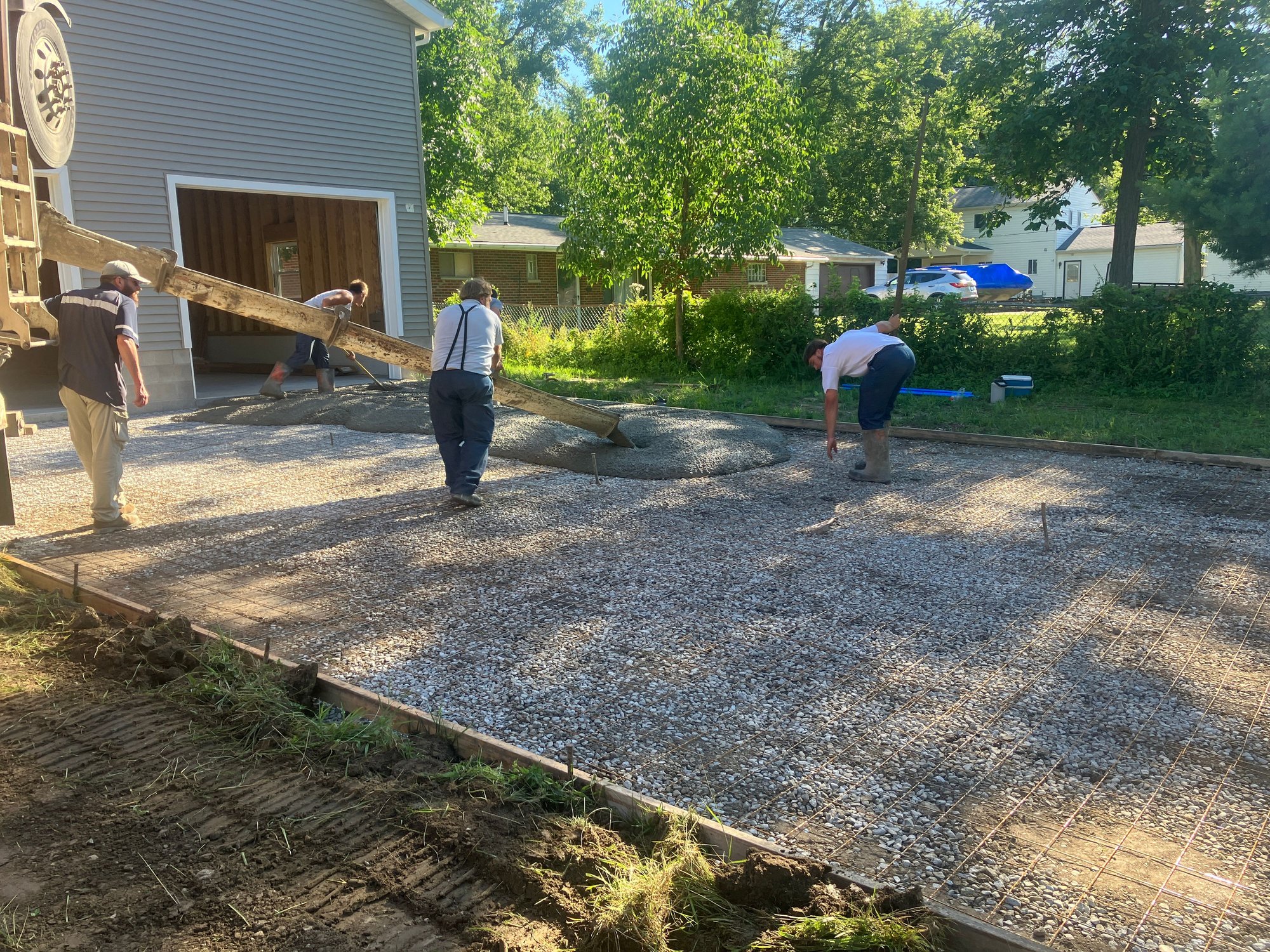

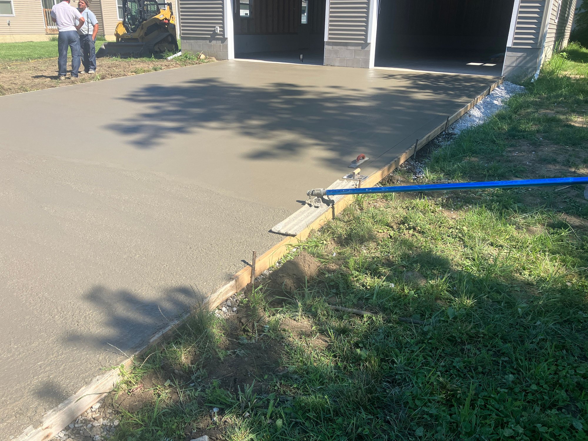

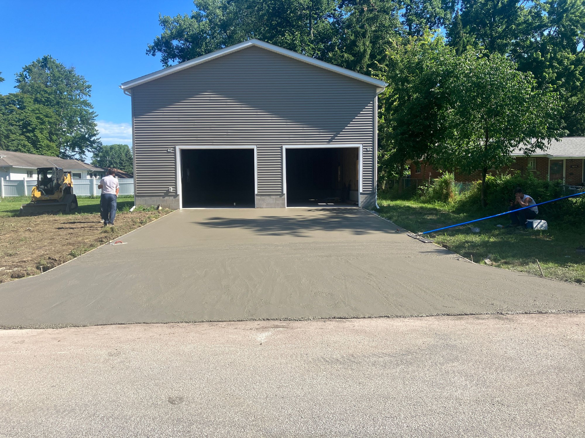

I am behind in updates, not much to provide yet. Driveway was finally poured on 7/5/2024!
At this point everything I hired to be done has been done! I need to work on getting my final inspection. I will deal with utilities later, but my city had me post some money for a Road Bond and I would like to get that back now that this is done.

When I took out my zoning permit with the city, they refer to this as a "large project". As such, they that concerns that the project might damage the road. They made me pay a bond so they have money from me in the event a road repair is needed. Well, no damage was done to the road. So, that is money to be refunded to my pocket.

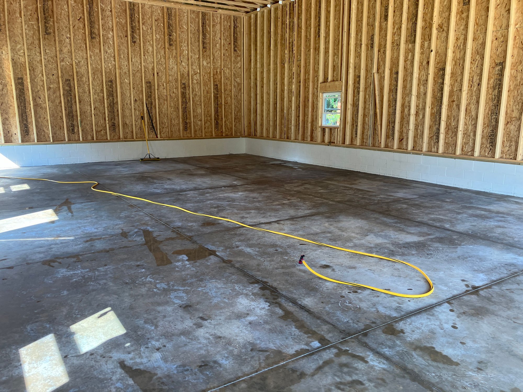

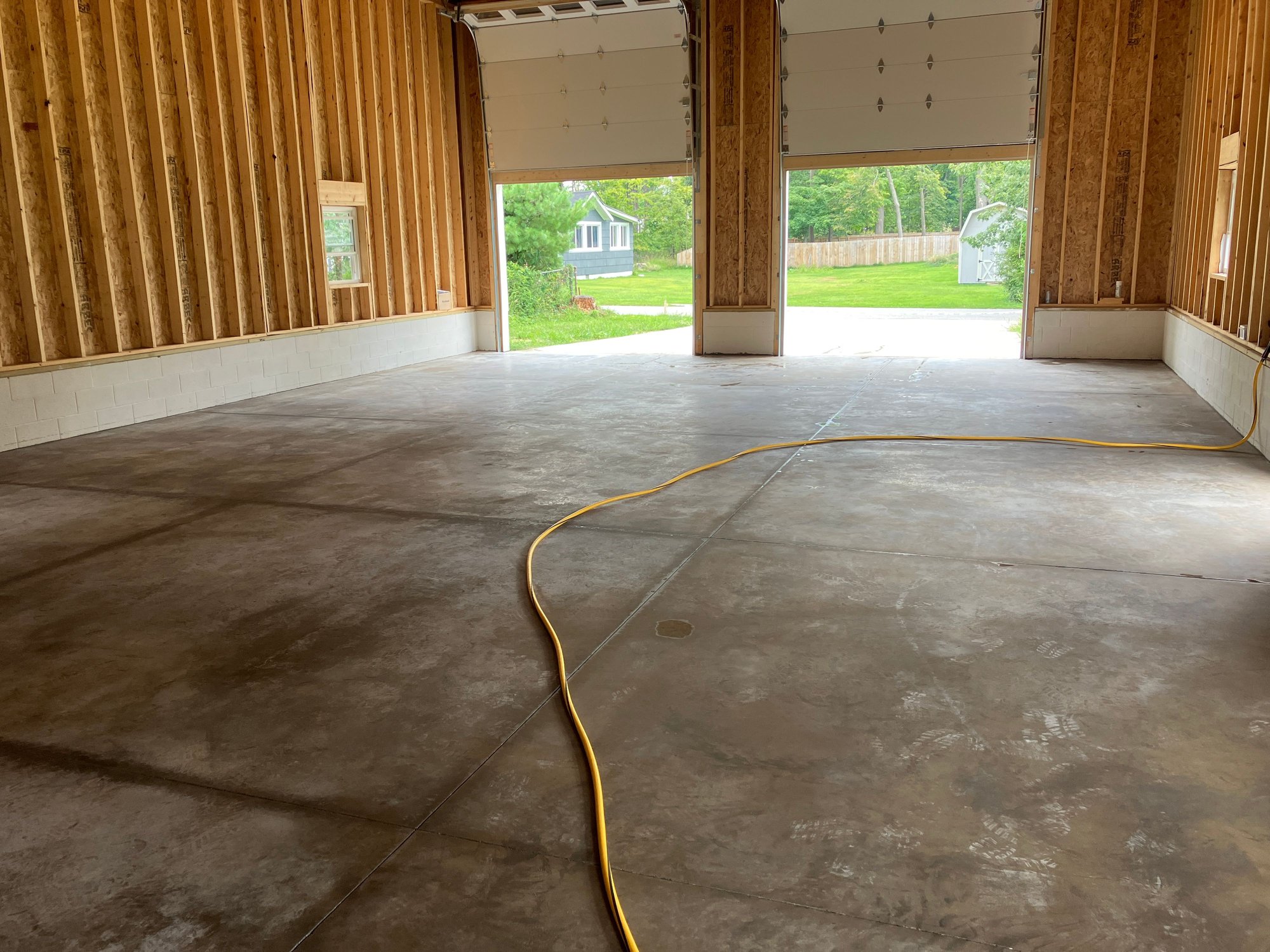

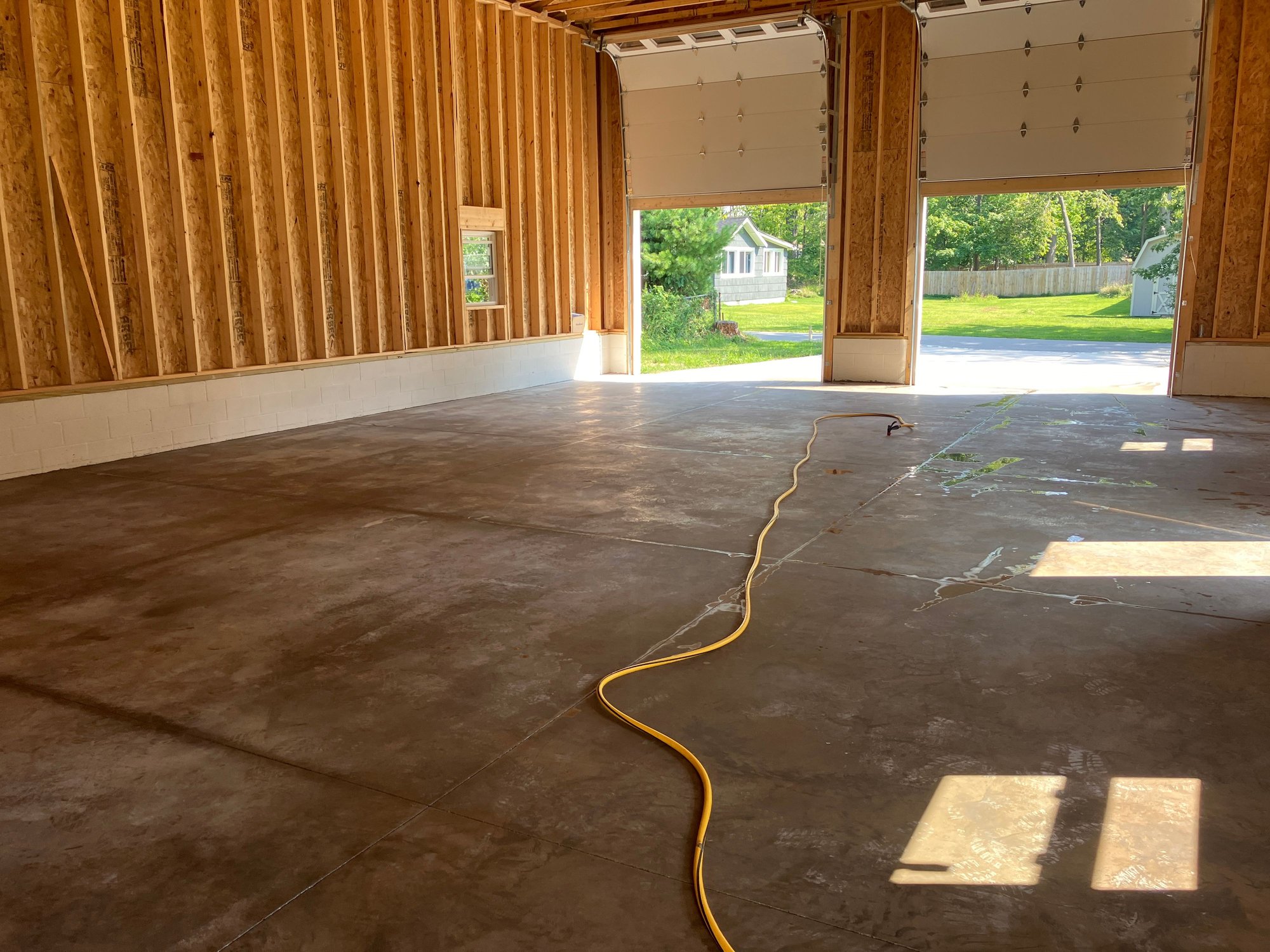

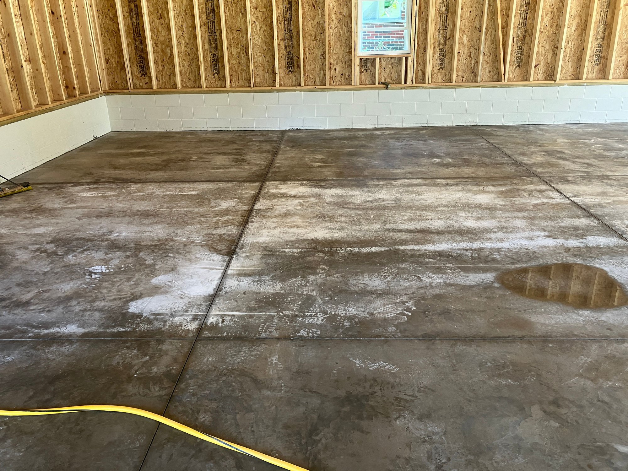

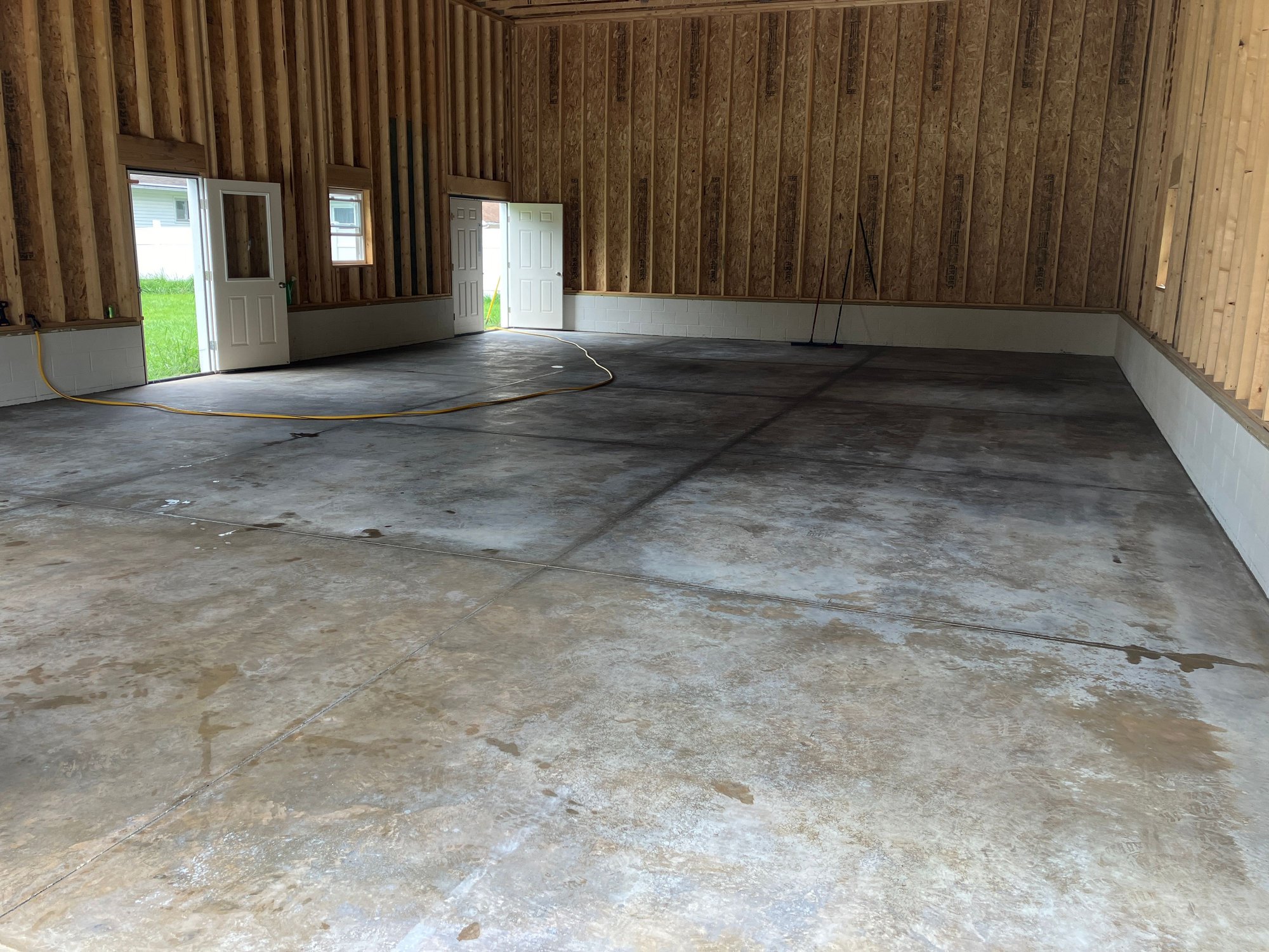

8-24-2024 - 8-27-2024 - I started the prep.
First, I had to rinse and squeegee all the concrete dust out of the garage. That was a mess. Then follow the directions and each kit came with 2 packets of a powdered etch material. You mix one packet of etch to 2 gallons of water in a watering can. Rinse the floor, make it wet, sprinker the mixture out. I used a brush to scrub it in, then rinse and squeegee. This was hurting my back a lot (6' 2" and the handles were not long enough to really "SCRUB", it was close to the end, I bought an extending handle for the scrub brush and a better squeegee and HUGE world off difference).
I worked from back to front. I noticed a couple tiny spots that something was on the concrete and the etch was not working (no bigger than the size of a quarter). I used a wire wheel on a cordless drill and fixed those spots.
When I thought I was done, I found areas of the concrete I thought were still "smooth" that the etch may not have worked. I bought 3 more packets of the Rustoleum etch (this is when I got the new squeegee and the new handle). I did spot touch ups. And then a final squeegee.
These pics are from three different days of work. And the last two were my "final rinse" pics.
