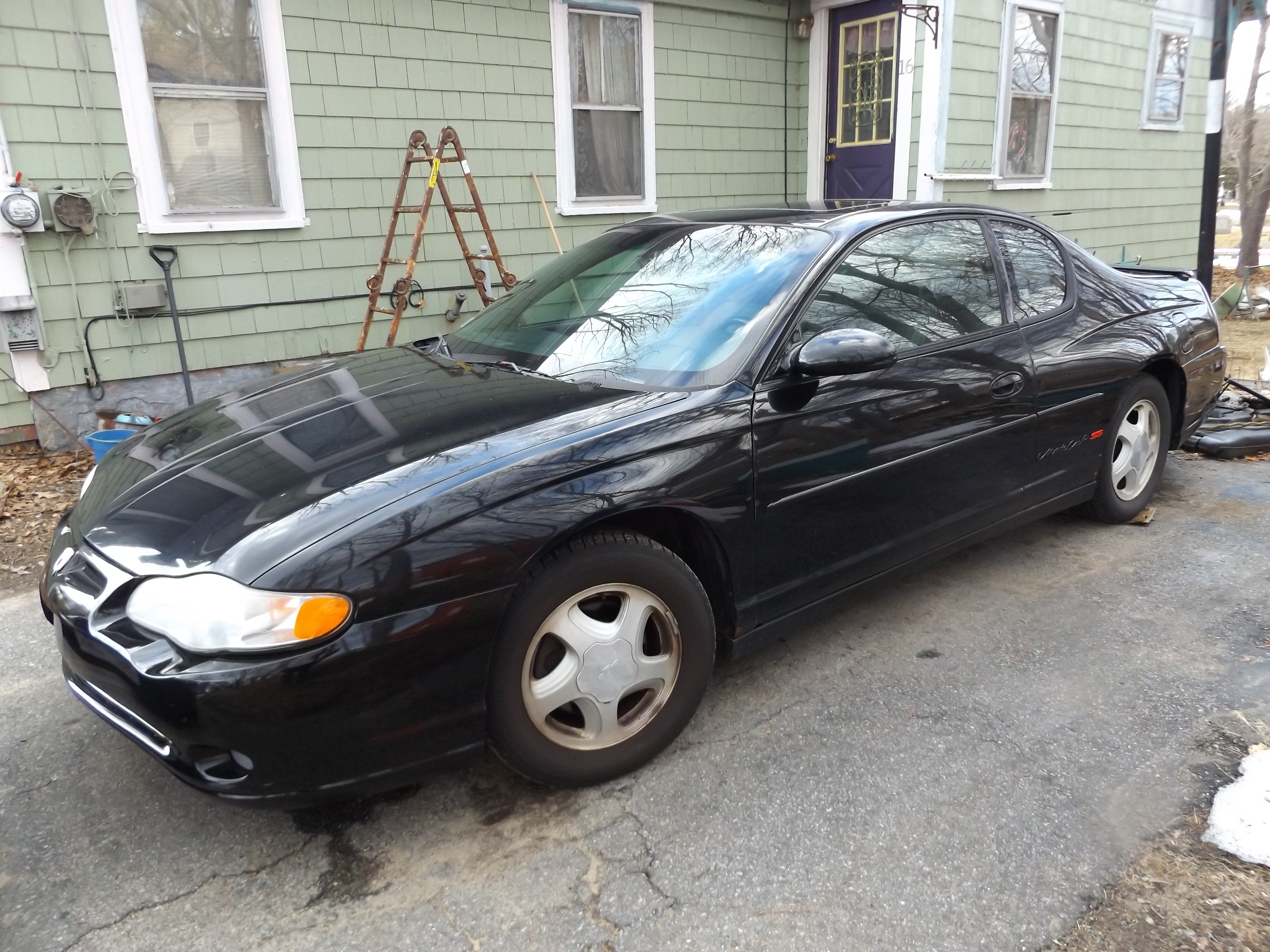

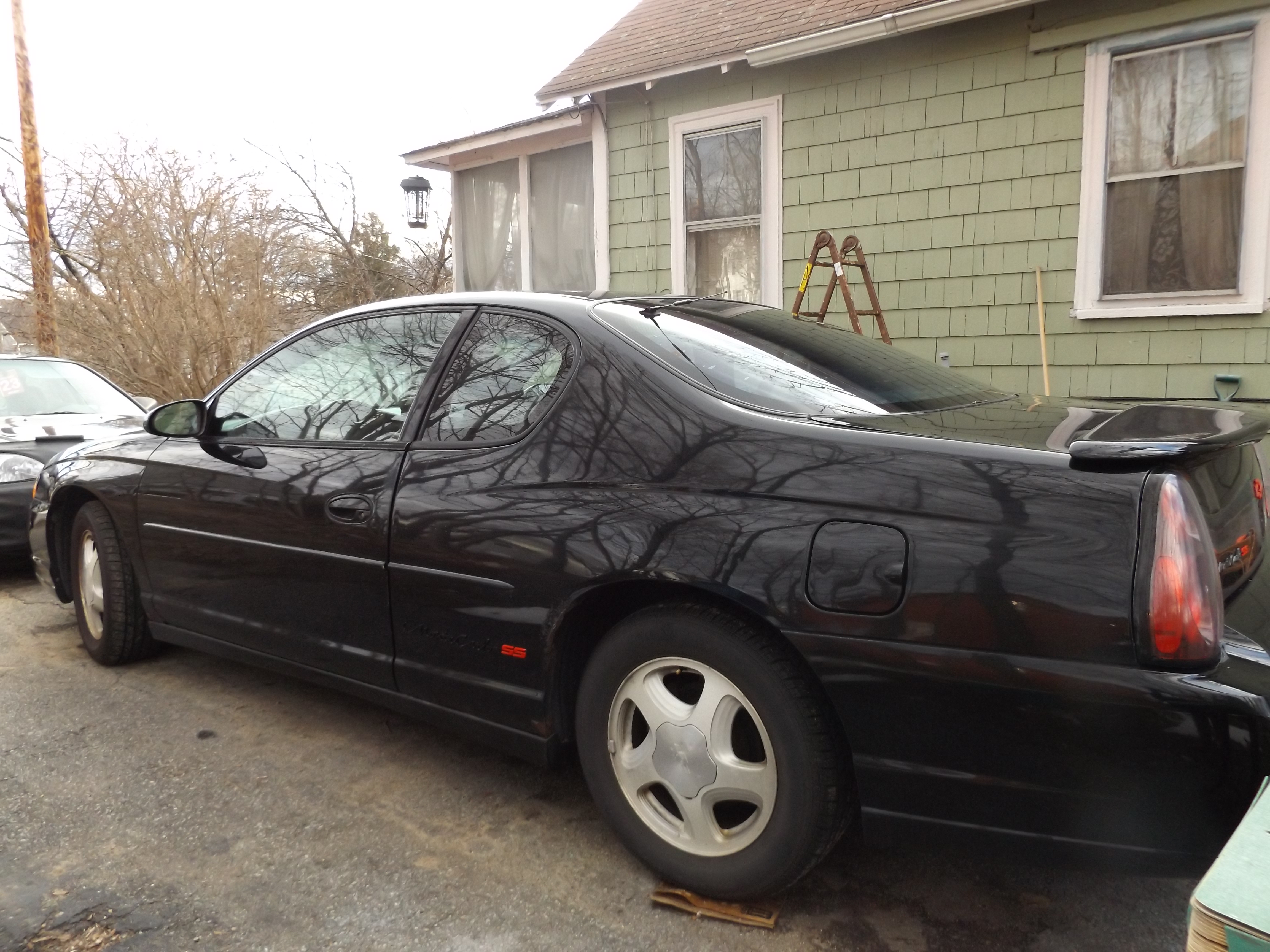

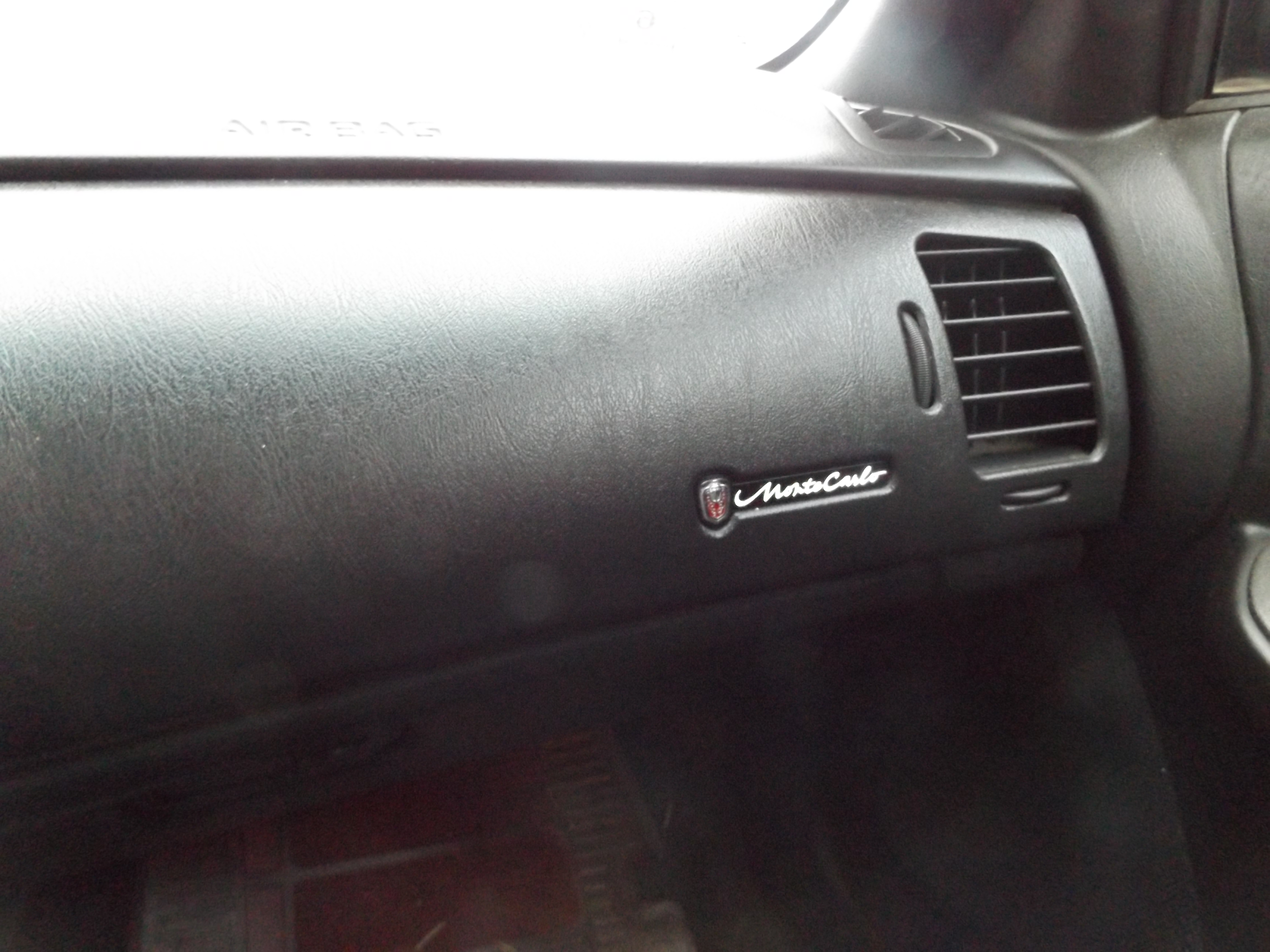

This is my black beast. Ordered a bypass for the amp and driver's side mirror glass this week. Waiting on good weather for the elbows, then I see if the coolant leak is fixed.

Nice ride! Good luck with the elbows. It is not a hard job.
