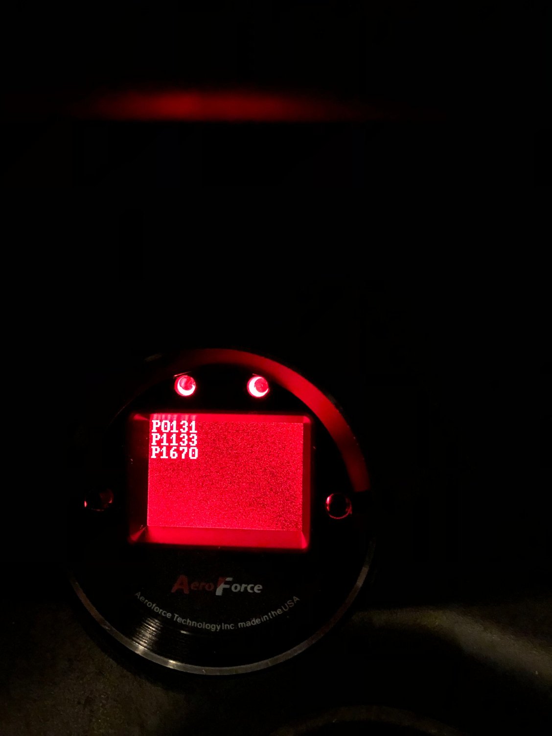

I have an 00 Monte Carlo ss with an L67 and 4t65ehd swap. I have a decent amount of zzp mods on it. Starting this season once it’s warm the car has a rough idle, dropping from 700 down to 200 up to 1000. I replaced the iac, tps, maf, o2 sensors, crank shaft position sensor, and icm. I don’t have codes for the misfires. I have codes for high voltage and o2 codes. Any idea?

Has the car run with these mods and this tune before without all of these codes?
What are you doing for a tune?
2 of these codes are PCM related. Where the car isn't receiving the signal it wants to receive. Do you have a spare PCM? Have you checked all of the wiring to the PCM?

I have a zzp tune. All these problems started after I re did my boost bypass. Zzp didn’t set up my computer to use it so I had no boost. Once I disconnected it and re ran the vacuum this issue started
. I was never able to get the o2 codes off last year.

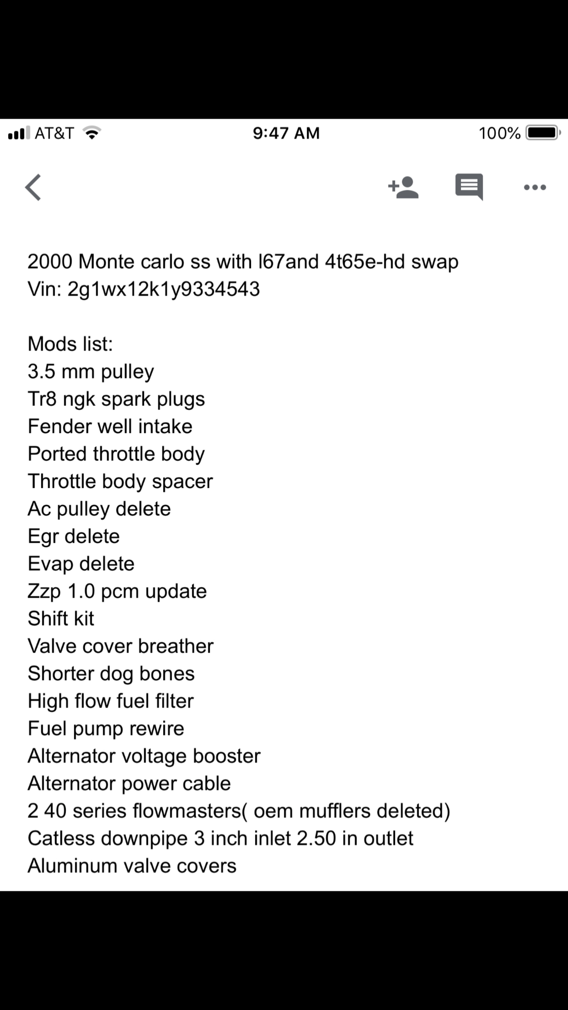

Here is my mods list
