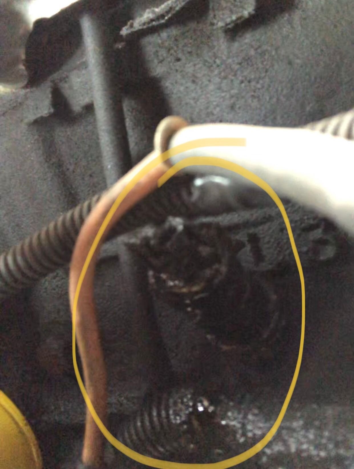

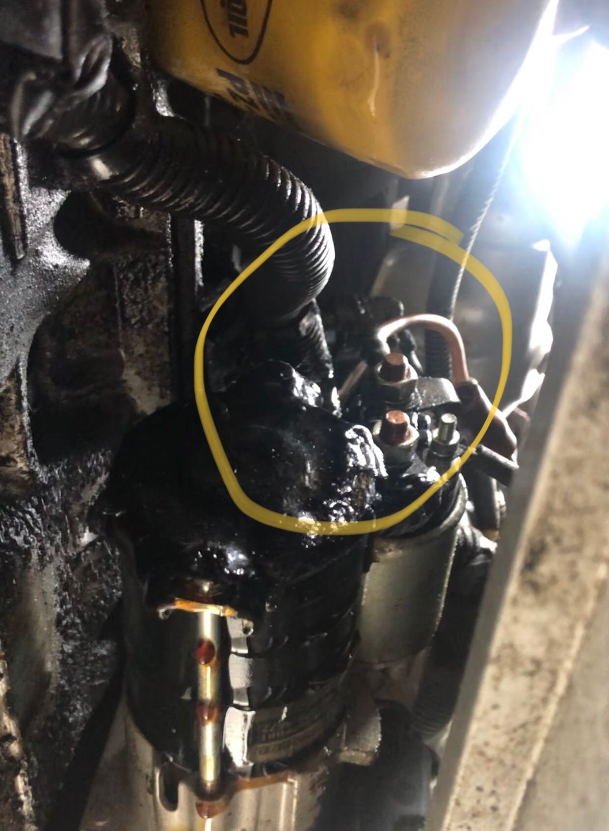

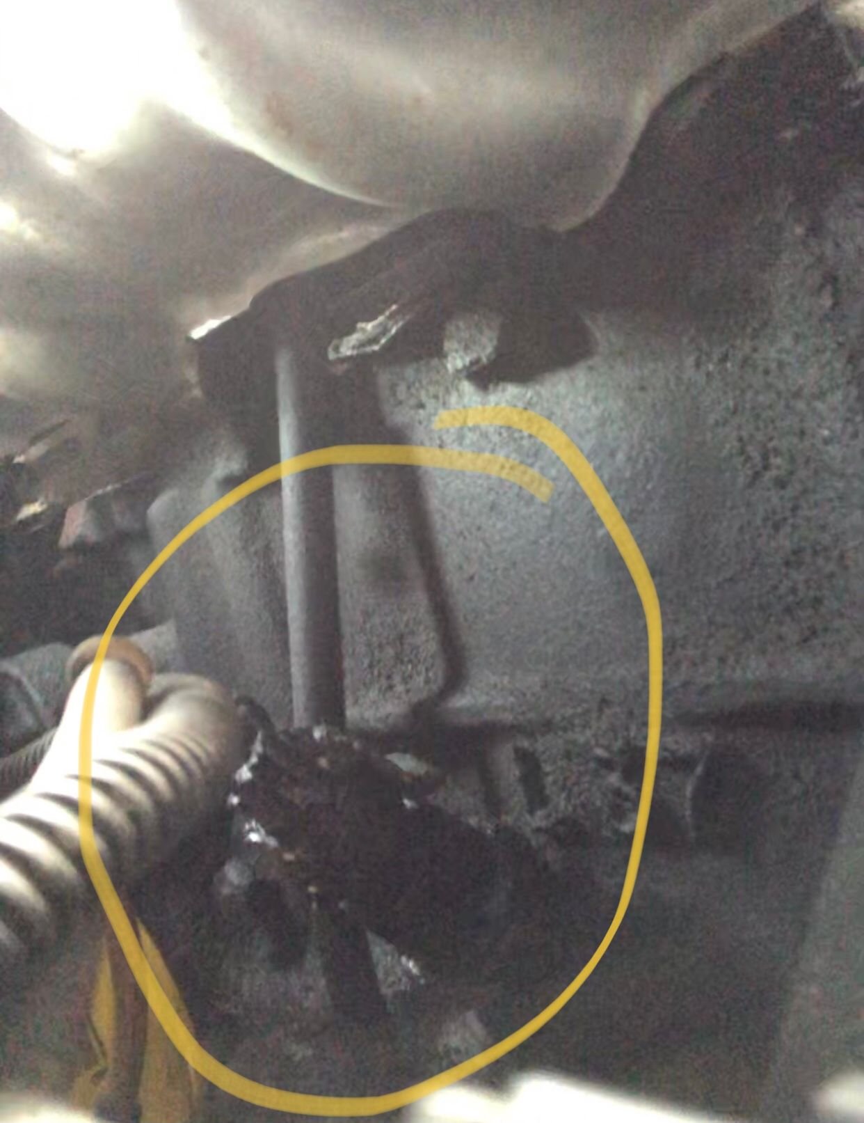

Under view
Seems to dripping persistently from here. Not sure how. Looks like an electrical clip. Tried to upload video but it wouldn’t work.

I think I found out what it is. Oil pressure switch. Hopefully that fixes my issues.
