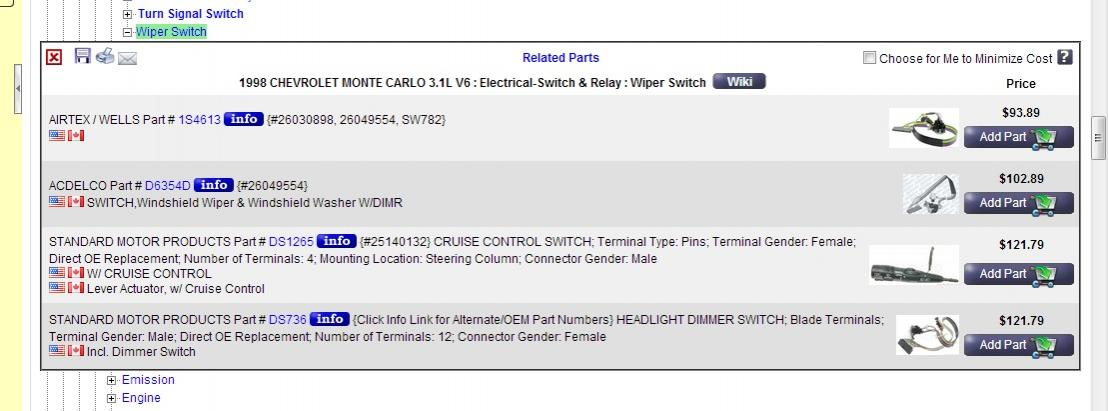

Thats because they want to rip you off! Check out this pic.
Just looked it up on Rockauto.com , the acdelco part is cheaper! (hope its the right part!) Hover over to see~
Its like....the best parts website ever

Rockauto has the multi function switch for $178.
