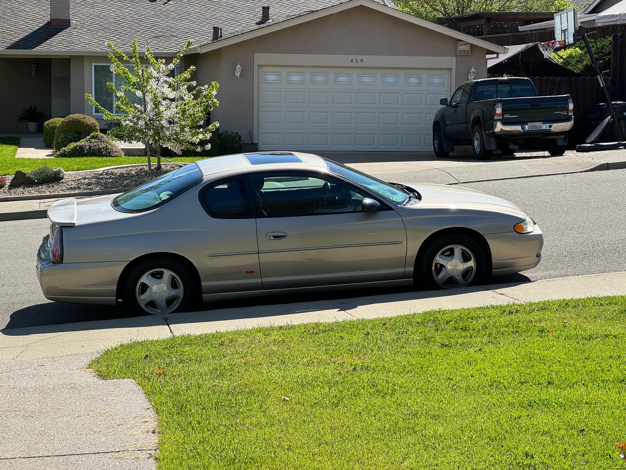

Hi Group,
My 16 yr old just picked up a 2002 Monte Carlo SS. The odometer says 75,000 - Overall it is in good shape no dents or real scratches.. I just purchased new rear lights.
However, I am curious about any kinds of mechanical issues to be on the look out for? Overall the car looks to be in good shape.
