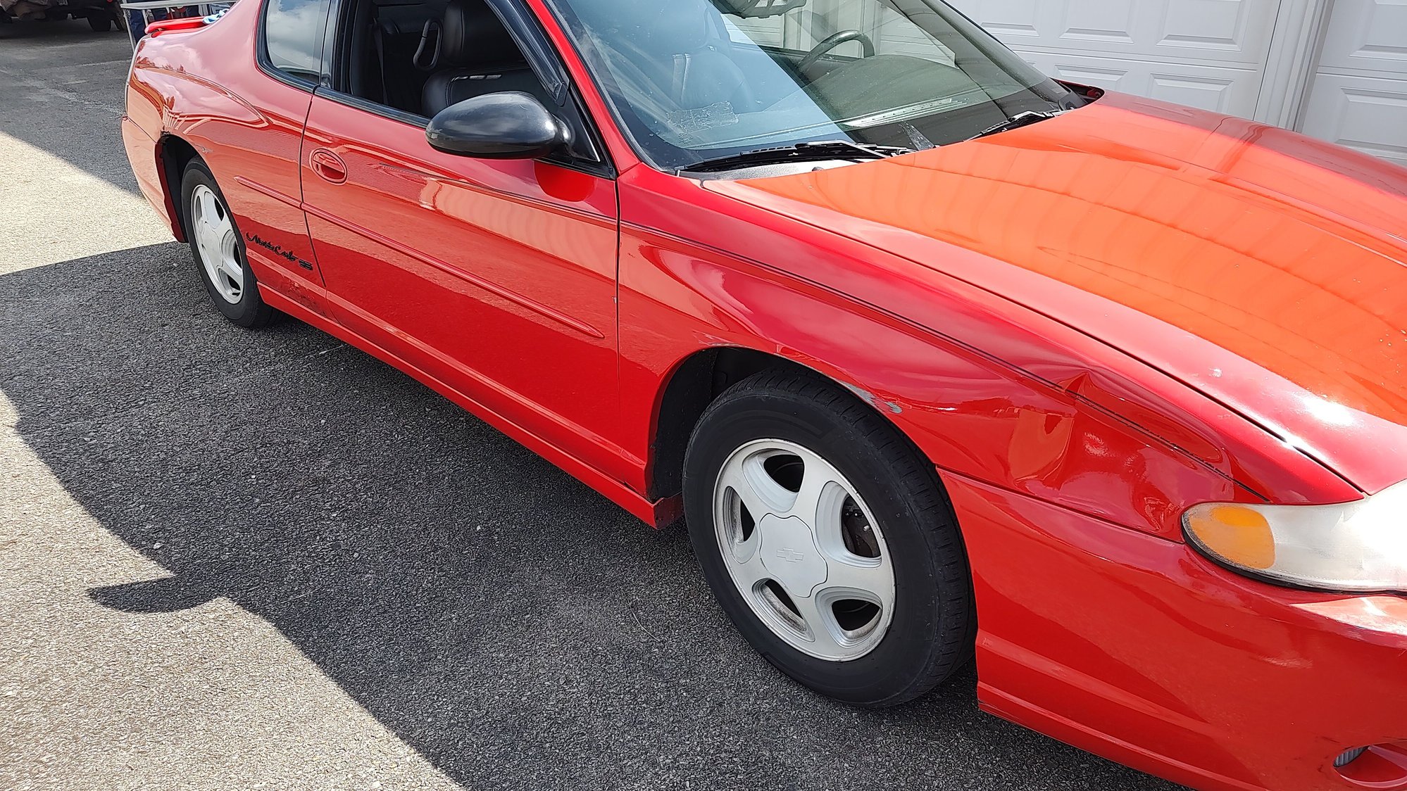

Got a 01 monte SS cheap I know it needed work had coolant leak and oil but long story short kept pressure off the cooling system hollowed out thermostat to get it home oil leaked not bad got money bought parts fixed cooling system put back in dexcool antifreeze everything worked fine temp pressure tested passed with flying colors now that's fixed leaks oil like it's going out of style stuck old hollowed out thermo took pressure off system again and back to leaking oil like before (not much ) I know it's not good to drive like that but it's currently my only ride a deer did in my pt cruiser in looks like oil pan leaking but can't really tell if it's something from above that sorry for long post just wanted to cover all basis btw I'm more of a fix it not figure it out when it comes to car repairs

Yep Bumpin96monte sure is now on to the fuel level sensor cause it works for like 2 min then quits but when it works it's accurate I got it as acheap as a fixer upper I'm the second owner only paid 800 and no rust underneath cause the leak must have been going on for some time let's just say it's well oiled under there
