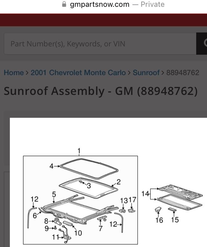

Thank you to everyone so far for the wealth of advice and assistance!! We did finally find and track the route of the back drains and cleared those out as well with compressed air machine and very hot water. All 4 drains definitely clear now as the water we pour in does not hesitate to exit. However, I’m still getting water dripping out from the homelink overhead buttons/console inside the car after every time it rains. I’m convinced if it’s not the drains now then it has to be the sunroof glass/seal itself?? We’ve even pressure tested the windshield to be safe/thorough and it’s completely fine.
Does anyone know if the seal/gasket around the sunroof glass is replaceable? Even an aftermarket one if not an OEM replacement? Or does it have to be found only attached to an original preexisting glass pulled off another Monte (junk yard?) I found a schematic online of the entire sunroof assembly but naturally almost all the parts are unavailable and I can’t find a part number for what looks like the seal (#4.) For some reason all these dealer parts websites skip over that part and a few others (like the tracks themselves) in the list, not even to list them as discontinued. Any additional help is greatly appreciated!!
