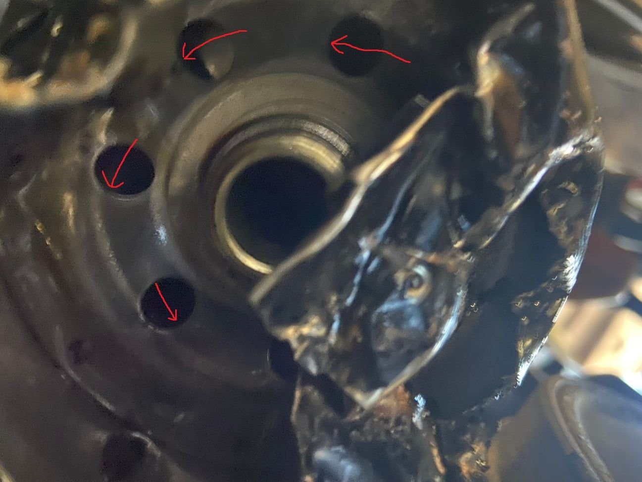

Well, I think it’s over. Pretty much the entire filter broke off after I put in a long tire jack for more leverage and it only got loosened a quarter turn before it broke and now it’s just the ripped top portion. That also won’t twist off and is completely seized. I’ve tried PB blaster on the top and nothing. Here are a few pictures. Is it possible to remove the oil filter adapter housing off of the block? Let me know, this car is frustrating me.
Old Jan 1, 2024 | 08:26 AM
Posts: 4,160
Last thing you can try is stick a flat head into the edge of one of those holes and tap it with a hammer, see it it will start to rotate... Obviously be careful to not damage the adapter.
