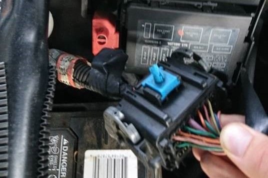

- One "fix" we have found, after an incredible amount of trial and error trying to diagnose the issue, is to disconnect the engine wiring harness from the battery at the connector pictured below and then reconnect it. This allows us to start the car immediately.
Spoiler
This is the harness connection I toggle that allows me to start the car again without waiting.

After rereading my initial post, I understand that saying "disconnecting/reconnecting the wiring harness" was probably overly vague/slightly inaccurate. I've edited it for accuracy and included the following information:
Spoiler
This is the harness connection I toggle that allows me to start the car again after stalling without waiting ~20 minutes.
I also added that there's been no check engine light since driving it enough for the pending codes to clear.
