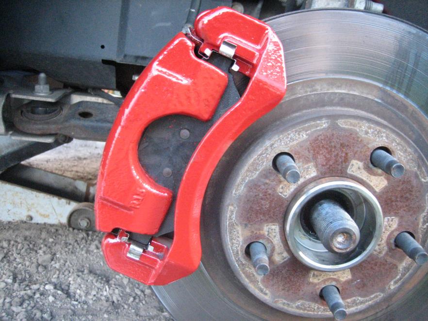

Old Jun 24, 2012 | 10:51 PM
If they look like this they are ok.
Old Jun 25, 2012 | 10:19 AM
Just minus the grooves on the contact surface!
Where the pads make contact...
Old Jun 25, 2012 | 11:33 AM
None of the grooves are deep they just look bad in the pic. I didn't want to replace it with a stock rotor tho because I want to get drilled slotted rotors
Old Jun 25, 2012 | 12:04 PM
Mine are a lil rusty on the edges, even alot of new cars if they set awhile they get a lil rusty & drilled & slotted is the way to go Lou & Lou i think ur missing the nut on the hub
Old Jun 25, 2012 | 12:31 PM
First, the rippled grooves on rotors are fine (so long as they are consistant). Any groves/marks that are not consistant and circular all the way around the rotor will cause issues.
FYI - From what I've read, slotted rotors are best. Slotted rotors that are drilled or dimpled are not always as good as they seem.
I just slammed on a set of AC Delco Advantage Performance rotors, Bendix performance ceramic (low dust) pads and Goodridge brake lines all the way around my Monte. I am 100% happy with the braking performance. All of this adds up to great feel and response in the pedal. I have NO interest to go any further. OH and I also rebuilt and stayed with the stock calipers.
And Lou, JGMonte is right, you best get a replacement axel nut (unless that was part of a repair you were doing).
Old Jun 25, 2012 | 12:39 PM
Ive had great results with my Drlled & Slotted on my GTO, i need to invest in some good rotors for the monte went with carquest & i think there tired of me bringing em in all the time to exchange em cuz they warped
Old Jun 25, 2012 | 12:51 PM
I just didn't have the nut on yet
