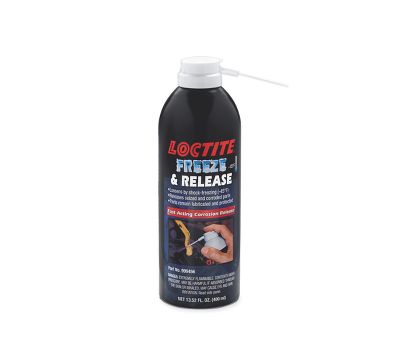

Try some kinda freeze lube too. The stuff I have is made by Loctite. Its basically penetrating oil, but they put butane in the can as well. That actually freezes the surface its sprayed on at the same time.
I bought some cuz I heard it worked well enough to chill a room temp. beer instantly, but it doesn't really work that well. And, predictably, it made the can greasy
