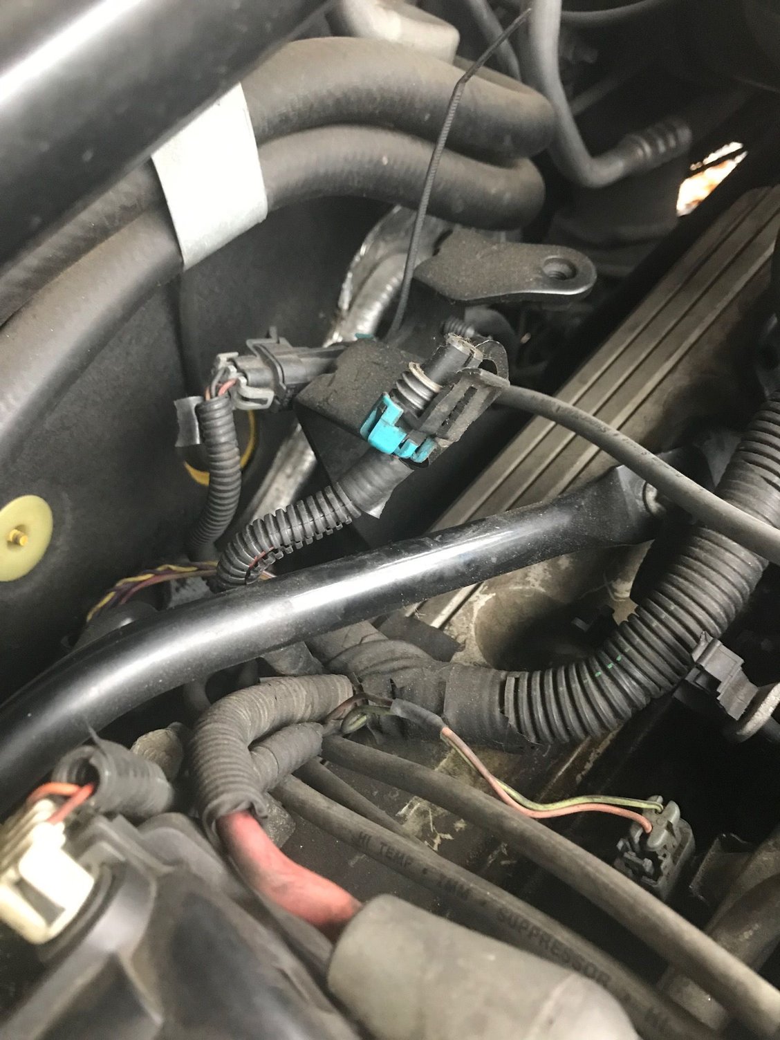

Hey everybody! I hope you can help me identify where this 2 pin connector
plugs into, between the engine and the firewall?
The CEL isn't on, so I'm really not sure where it belongs.
...And whats the purpose of that unused black bracket there too?
2002 Monte Carlo SS 3.8
Pict attached,
Thanks!

Ignore it, its not needed. Thats for California emisions. It plugs into something that attaches to the rear exhaust manifold on California cars.
The black bracket holds the MAP in the supercharged engines.
