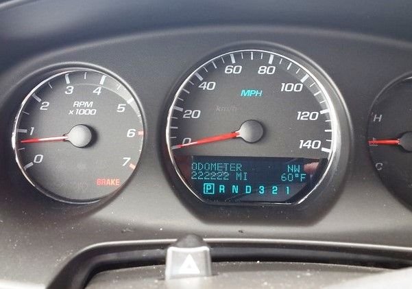

Just the P R N D 3 2 1 and not the Odometer/Compass/temp/other DIC display? Old picture for reference.
