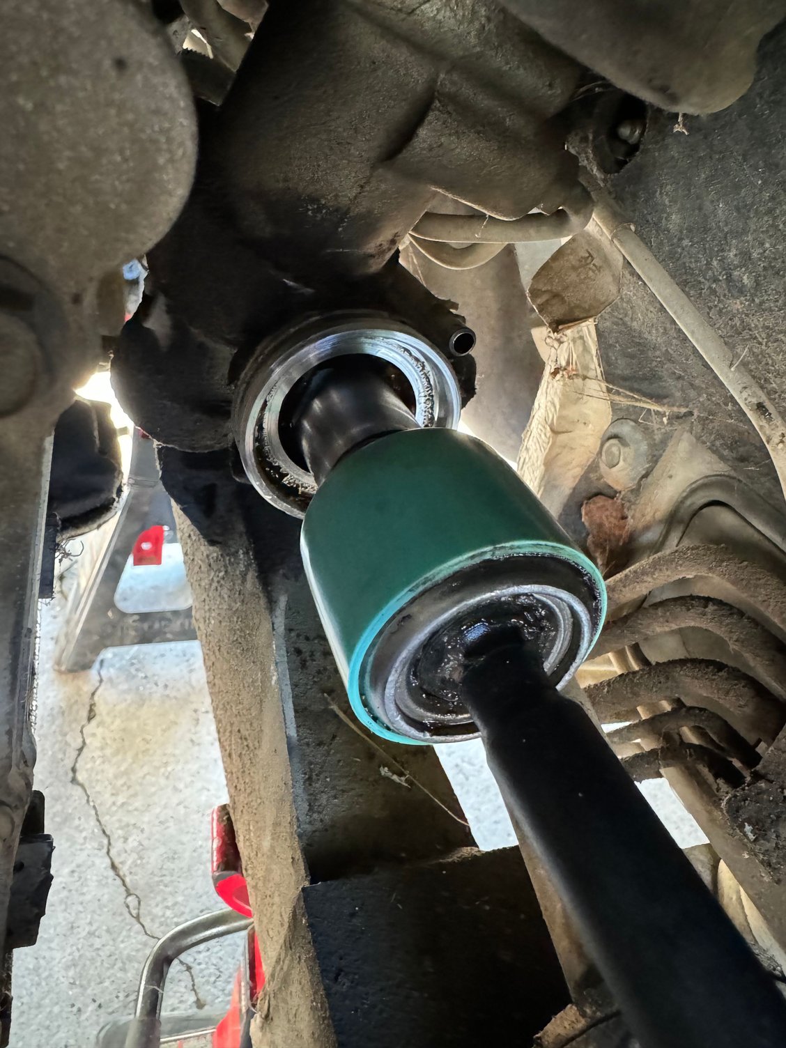

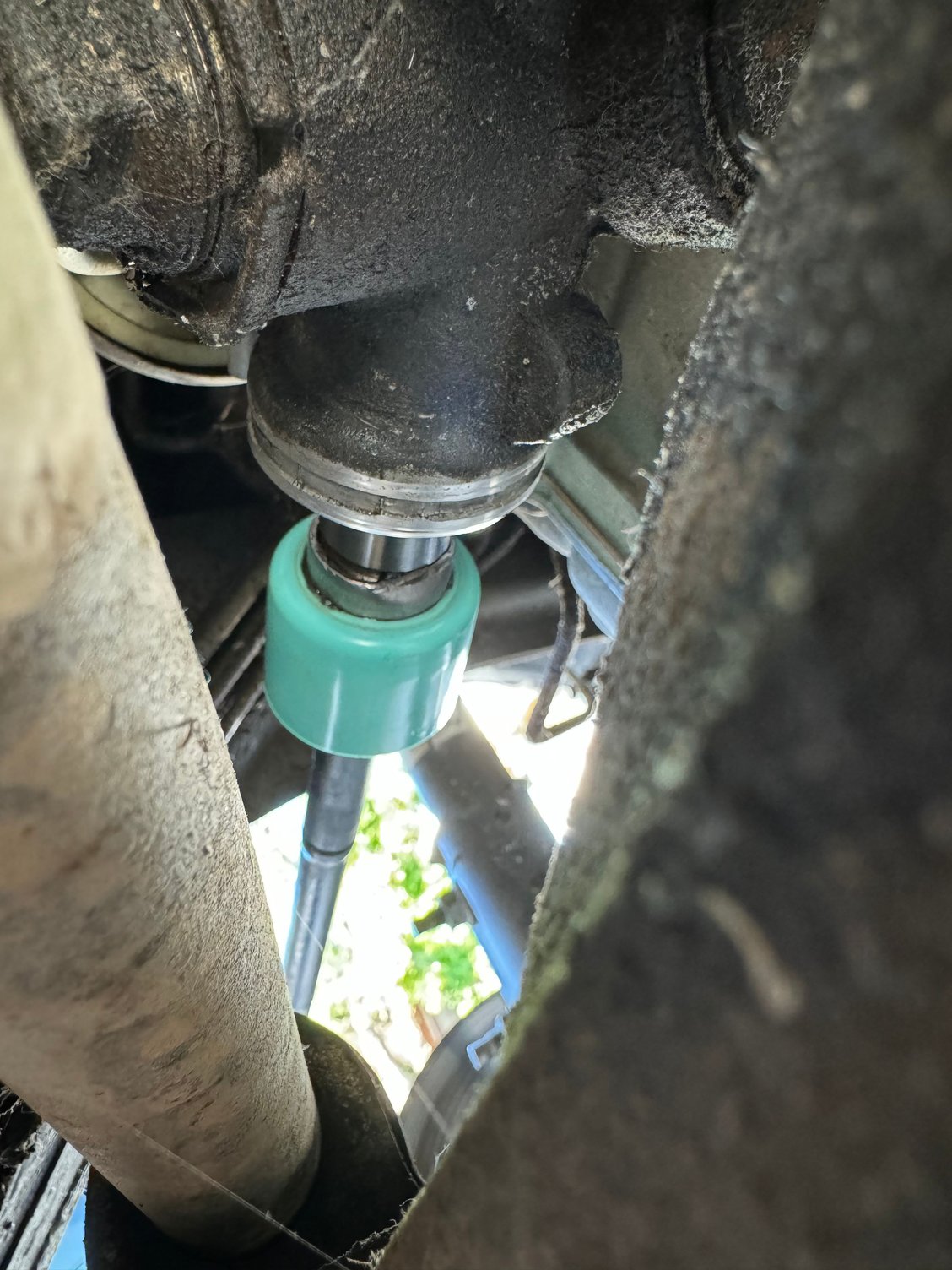

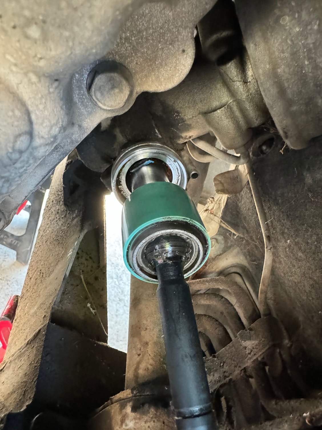

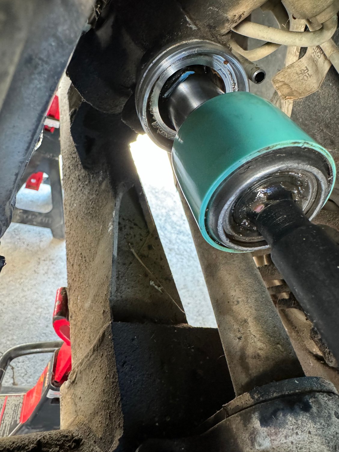

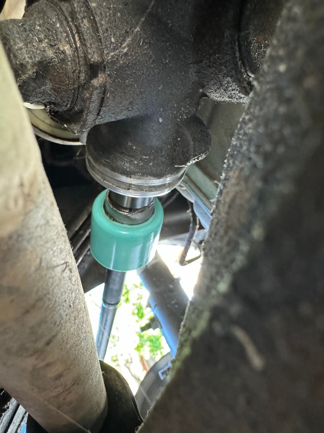

Default Picture of In we Tie Rod - very strange looking
Hi Group - I did find that the inner tie rod was broken.. however while trying to replace it - I found an inner tie rod that appears to be missing the connection nut that typically connects the inner tie rod to the steering.. it has what looks like a straight steel connection. Any ideas on how to remove a connection like this?
Does anyone know how to remove this piece?
Old Jun 19, 2024 | 02:20 PM
Posts: 4,160
The nut youre looking for is under that green plastic collar. Slide it towards the rack and youll see it. You also need the tie rod removal tool. I made my own with some socket extensions and an exhaust clamp.
The part I circled in red, that dent... That is the very end of the threads of the nut. Its dented like that to prevent it from backing off. Remember to redo that with the new tie rods. Youll see a couple flat spots on the rack/screw that mark where they go.
Getting that dent to expand back over the male threads is gonna be a pain but its necessary.
Old Jun 19, 2024 | 02:26 PM
Posts: 4,160
So basically, the tie rod has the big, built in nut while the rack/screw has the built in bolt to screw it onto.
