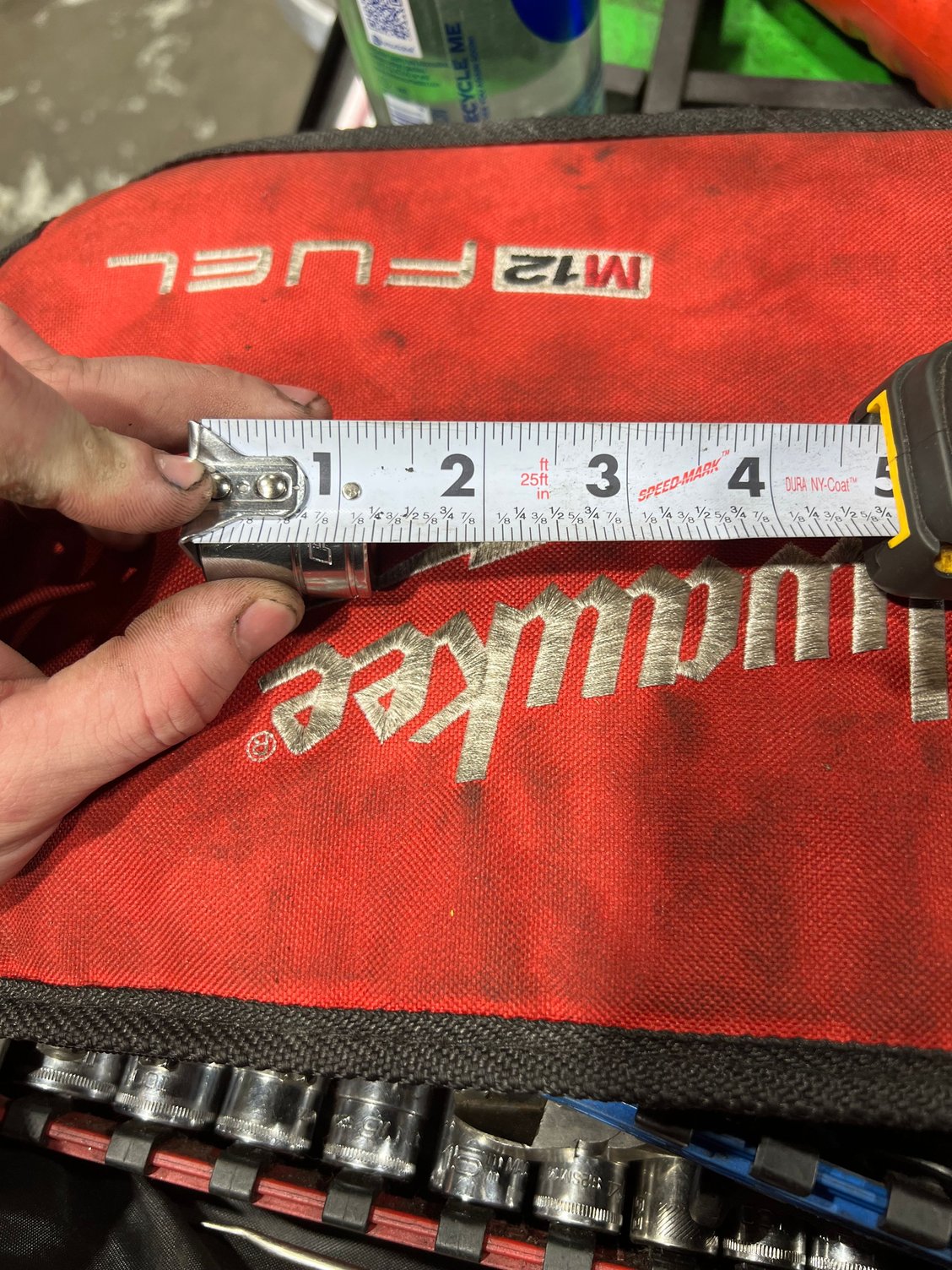

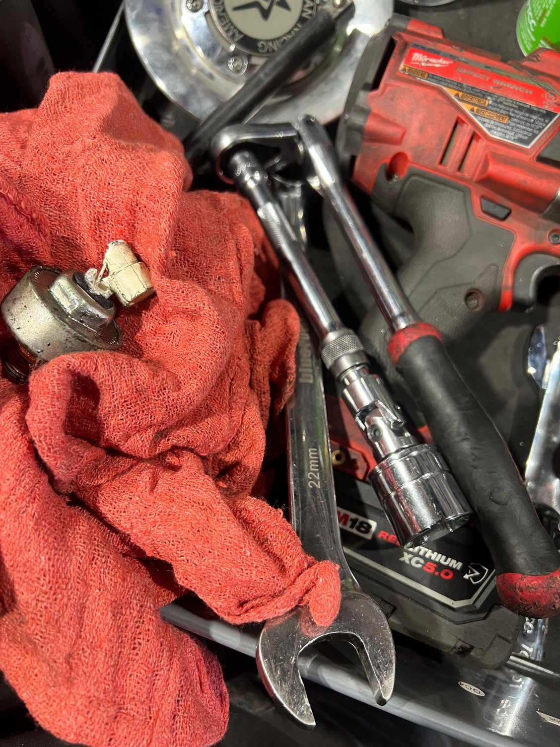

I found if you break the top of the connector for the sensor, use a chrome 22 with size in the photo, you can break it loose then take it out using a magnet from the back and install the new one doing the reverse but with a 22 wrench box end that is cut to be shorter
