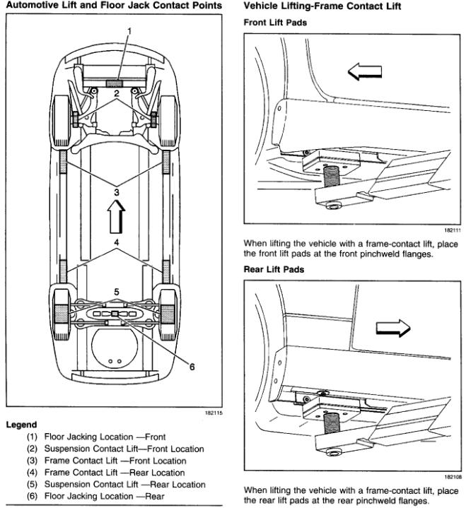

I am about to jack up my 97 MC first GM after 20 year of Mustangs and Tauruses and I do not know where to put my floor jack. Car came from michigan the tire jack groove is gone!

Thank you! Thank you! Thank you!

Chris:
Nice Diagrams!

Sorry so late at getting back to you, I'm more of an evening person..... Actually I found the diagrams on here by doing a "search" and I knew I've seen them on here before.......
