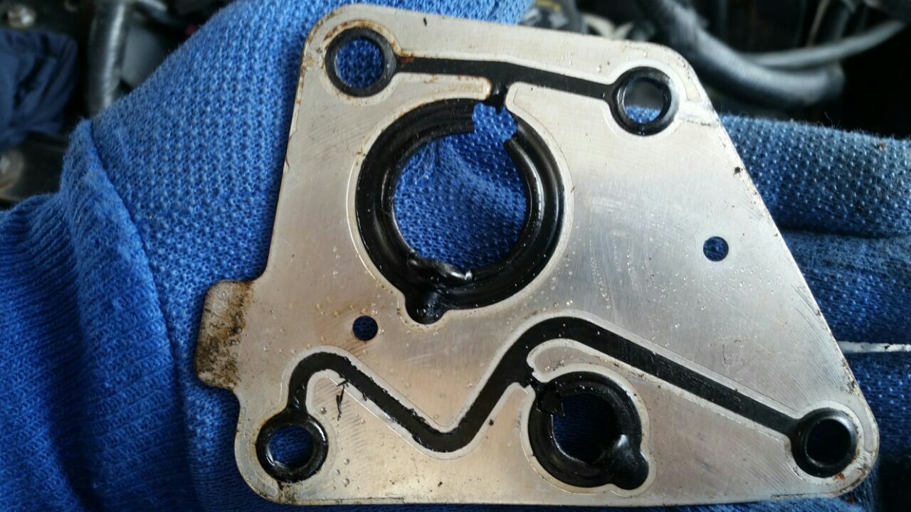

Well I replaced the crossover pipe gaskets AGAIN this time with Felpro gaskets which seem like a slightly different design. The gasket failed in exactly the same places as last time. I attached 2 pics the one on the work bench is the gasket i just pulled out and the one in my hand is the one i pulled in 2017. So what you guys think? Design flaw or warping caused this? The mating surfaces were clean (seem fine) but i don't know. If so I would need to buy a new crossover pipe. I just put it back together as is and so far no leak. If it does fail again I will replace the pipe next time.

I was completely on the wrong page. I saw crossover and immediately assumed exhaust crossover pipe (ie the pipe that connects the front bank of exhaust into the rear manifold / downpipe).
I've never dealt with the part you're showing.

Yeah I guess I should have specified coolant crossover pipe didn't realize there was another one on the car Anyway seems fixed for now hopefully the Felpro gaskets don't fail in 5 years like the AC Delco did. Seems like a design flaw to me since it failed in exactly the same place/same way. They changed the design the next year so that tells me something. I looked into the 3.6 since I am considering trying a swap (don't know if it will fit). Its basically the same motor just lots more cams and valves on it. But I hear that one stretches chains. Maybe I need a toyota engine lol.
