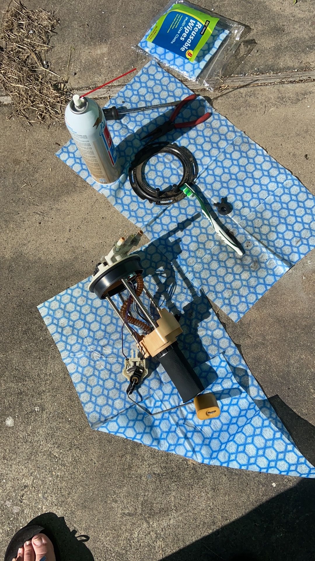

I’ve replaced the fuel filter, pulled the fuel pump and cleaned the tank and the pump. Replaced the MAP sensor (per diagnostics) and cleaned the air filter. I’m guessing it’s the MAF sensor. I’m curious to see if our problems are related.

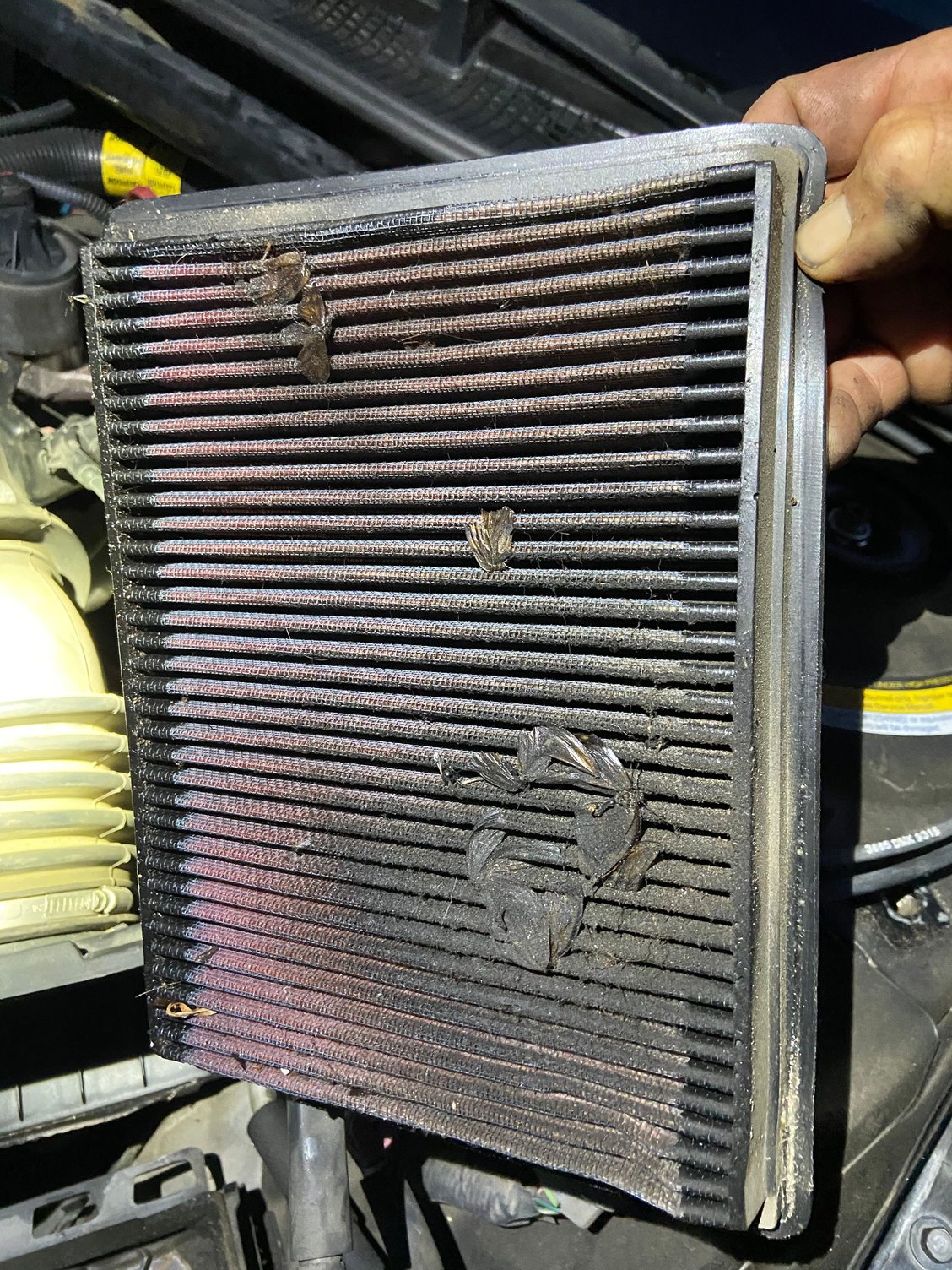

5. K & N filter is the only one you want to clean. Replace the rest of them.
My 2000 SS comes with a K&N... cleaned and reinstalled.
Pulled all the spark plugs and replaced. New MAP sensor, fuel filter, pump pressure checked and good.
here’s a question- had diagnostics ran and MAF read 10.1 - guy said it should match 3.8 engine so it’s either to high (3.8) or too low (38) he couldn’t remember.
thanks for the help! Much appreciated.

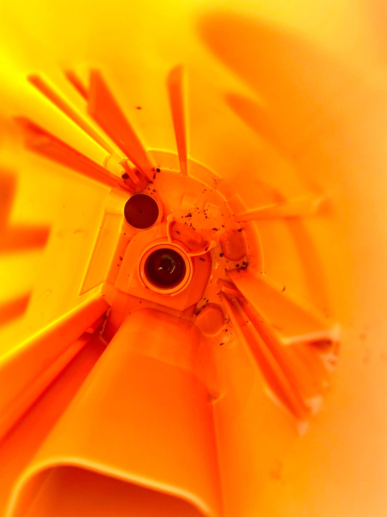

Cleaned and replaced but car died open to air
Cleaned and replaced pump- boiling water soaks with dawn and several rinsed then air dried in the Texas sun until all dry
Clean tank!
Debris in fuel pump

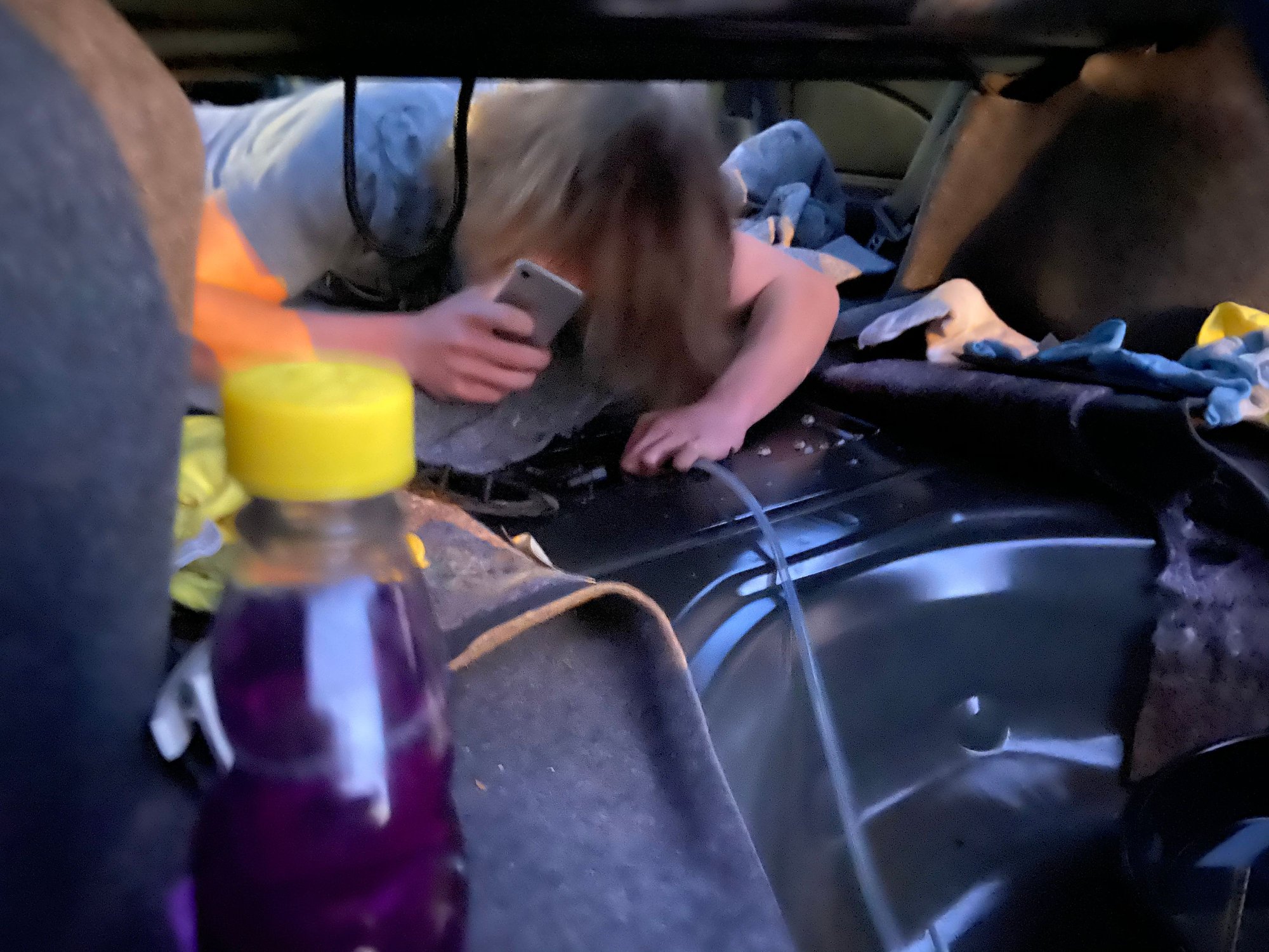

Thank God for fuel pump access in the trunk. Love not having to drop the tank- my son learning!!!
