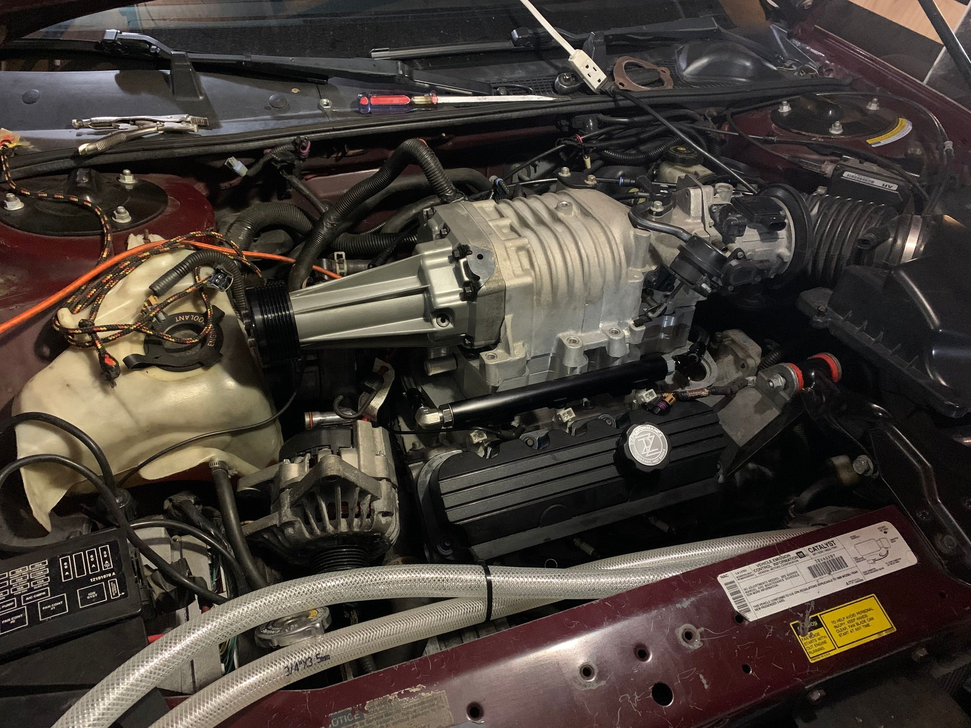

Hello, I’ve searched an haven’t come across a clear solution for a ARP rear manafold bolts that interfere with clearance of exhaust manifold. I’m running a factory rear manifold. I’m stuck in the middle of putting my Top swapped Monte back together.

I re-read my post. Maybe, I wasn’t clear. I’m referring to ARP Head Bolts. The studs block the path for proper mounting of exhaust manifold.
There’s a YouTuber called TerrellSmith who just recently broke 572whp with a highly modified 3800. He uses ARP studs. He has custom headers though which is why I’m sure he’s not having the same issue I’m having. I didn’t know the studs was an issue until I started putting the factory exhaust manifold on.

I’m also having hood clearance issues with the intercooler I’m installing. I envisioned a factory hood with this build but it’s apparent that I will have to have a modified hood. Do anyone recall a red 5 Gen With the supercharger poking out the hood from the past. In the past I did not understand why it was sticking out the hood like that but unfortunately I understand now. Lol I have an hood modification idea that I’ve never seen done on a 5th Gen to solve the clearance issue. Once I get the Monte Carlo back running. I will begin fabricating a hood.
The red 5th gen was a DOHC 3.4 with an M90 on it IIRC...
I never had a stock hood with this engine so I'm not sure what the clearance would have been. Don't get me wrong, my cowl is not functional or cut out. Have you removed the hood's heat shield to see if it fits?

Thats cool that you knew what I was talking about. Yes, I removed the heat shield. Unfortunately it’s still not enough space. I’m in the process of brainstorming a way to make the hood I have in mind. I plan on making a custom hood.
