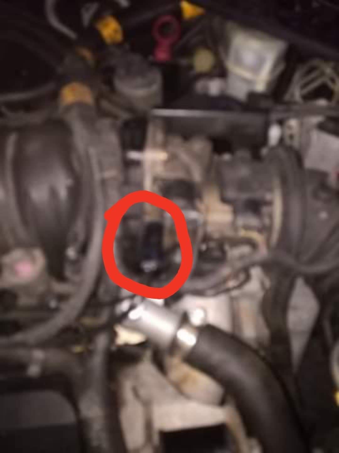

So i have this vacuum line with a small fuel line attached to it where it connects. Looked at quite a few diagrams but none of them seem to have a label for it. Its cracked and currently being held on with duct tape which only lasts a few days. Code when it pops off is P0446.

Pictures very blurry but that looks like the line that goes from TB to MAP? I redid all those vac lines with silicone and stainless T splitters.
There was a topic some months ago where someone was asking for the same part and someone posted it, I cannot find it tho.

To Blurry!!
Old Oct 1, 2020 | 09:02 AM
I believe it is this piece, you get the whole connector and tube at once.
GM Part #24506671

Chibi got it, thanks so much.
