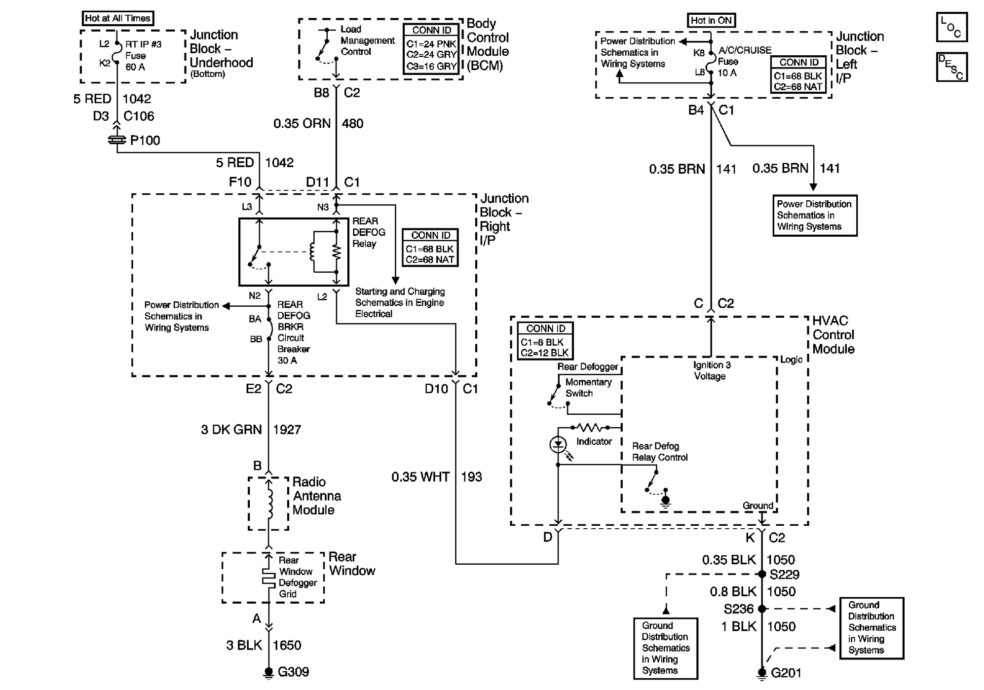

I can see if I can dig up some schematics for it. What year Monte is this (to ensure GM did not have a mid-year change)?

Ya I switched the breakers behind the fuse panel. (Dumb place to put them)🤦🏼♂️I had another relay of the same part number placed it in but no change. I ohm tested it and seems good, but with the voltage being low on the other terminal points, would that more likely be where the issue might be coming from? I would guess from my little knowledge that if it is not getting the full 12 volts it won't pull the relay over to connect....?

Awesome! Thank you so much!
I do have 12v on the L3 but nothing on the other terminals with the button turned on, am I to have voltage on another terminal?
Sorry I really do suck at fully understanding how power is routed through this relay and how each symbol reads.😑
If I am reading the wiring diagram correctly, the power for the rear defroster (what is actually going to the glass) is coming from the junction block under the hood, to the relay, then when the relay is switched to the "on" position, it goes to the circuit breaker, next the antenna module and finally the glass (and connecting to ground on the other side of the glass).
When you press the button on the HVAC controls for the rear defroster to activate the defroster, it will activate the indicator light, it then grounds out the control of the relay (this grounding is what causes the relay to activate and pass voltage to the circuit breaker). But, the other control pin of the relay is getting battery positive voltage from the BCM (looks like the shop book says if the battery is too low, the BCM will not allow battery positive voltage, basically, preventing you from activating the rear defogger).
Checking your path, my thoughts are this:
- you should have 12v on one pin for that relay at all times.
- next check the control pin from the BCM for voltage (should be no voltage with the car off and then voltage with the car on, not sure how much voltage, but I assume it doesn't need much).
- car on, check when you hit the "rear defroster" button on the HVAC controls, does it activate a ground on the other control pin.
- If all the above works, check that the relay is activating and outputting 12v.
- After that, you will need to check the circuit breaker. Is 12v coming in? Is 12v going out?
- Then check if you are getting 12v to that antenna module.
- last is 12v to the connector.
And if all that checks out, inspect the ground pin on the glass, make sure the ground is still good.
I admit, I am not an expert with reading wiring diagrams myself, but I believe that should follow.
