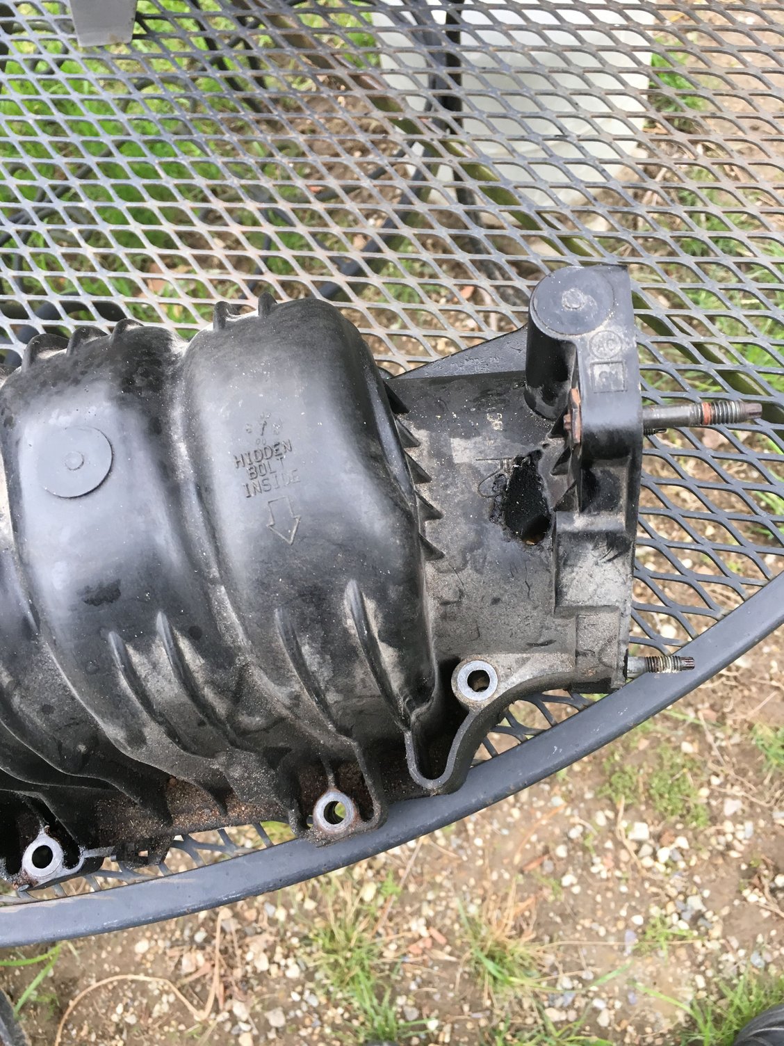

Solved:
A hole has melted in the intake plenum. Right above the EGR port.

Old May 1, 2019 | 04:27 PM
pajama01504's Avatar
Joined: Nov 2013
Posts: 3
From: 01504
Old May 1, 2019 | 05:09 PM
That is a new one for me. Never seen a hole melted in the top. Makes me wonder if the exhaust coming through the EGR is way hotter than it should be OR is this just bad luck. Hopefully just bad luck and replace the UIM and off and running again!
Old May 1, 2019 | 08:04 PM
Posts: 6,478
X2, that's crazy!
