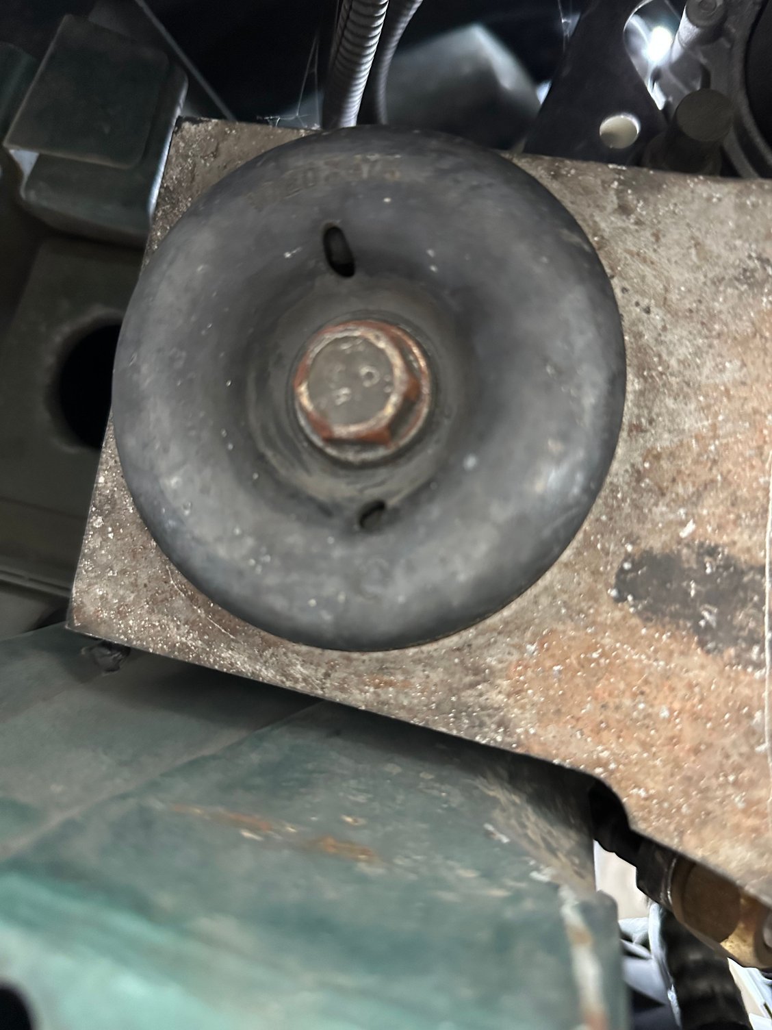

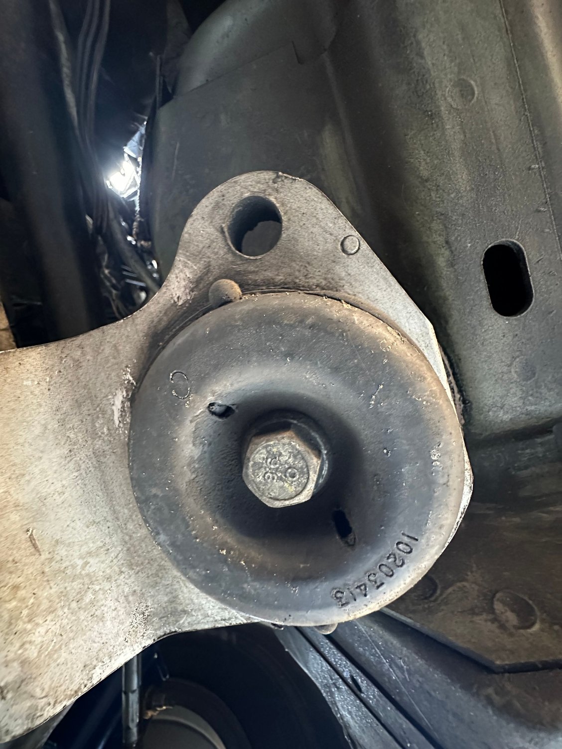

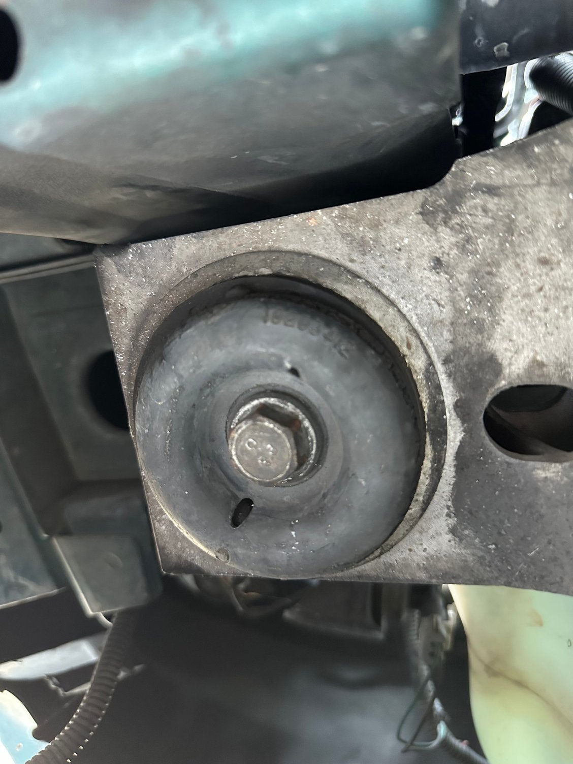

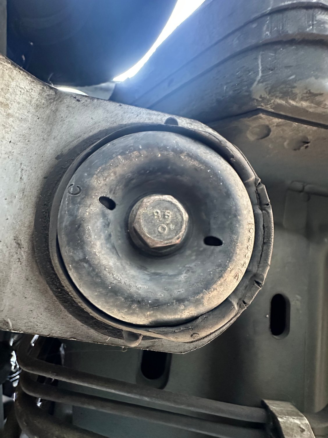

Below are images of the cradle bushings. The one that appears damaged is the rear, driver’s side bushing.

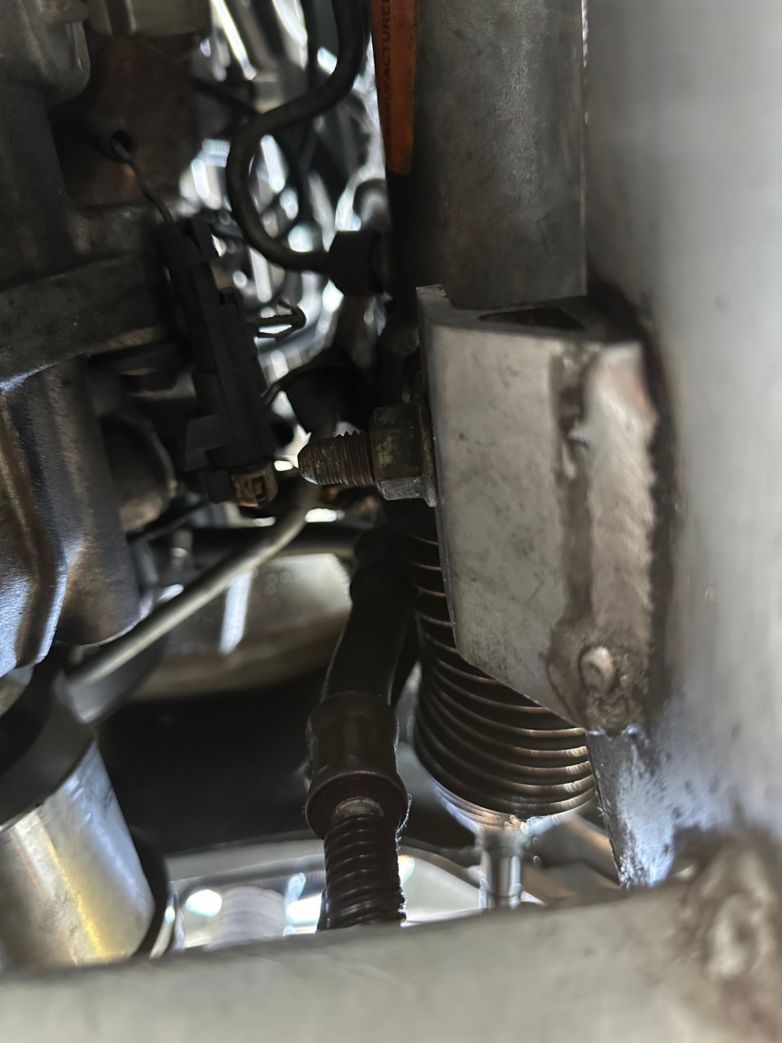

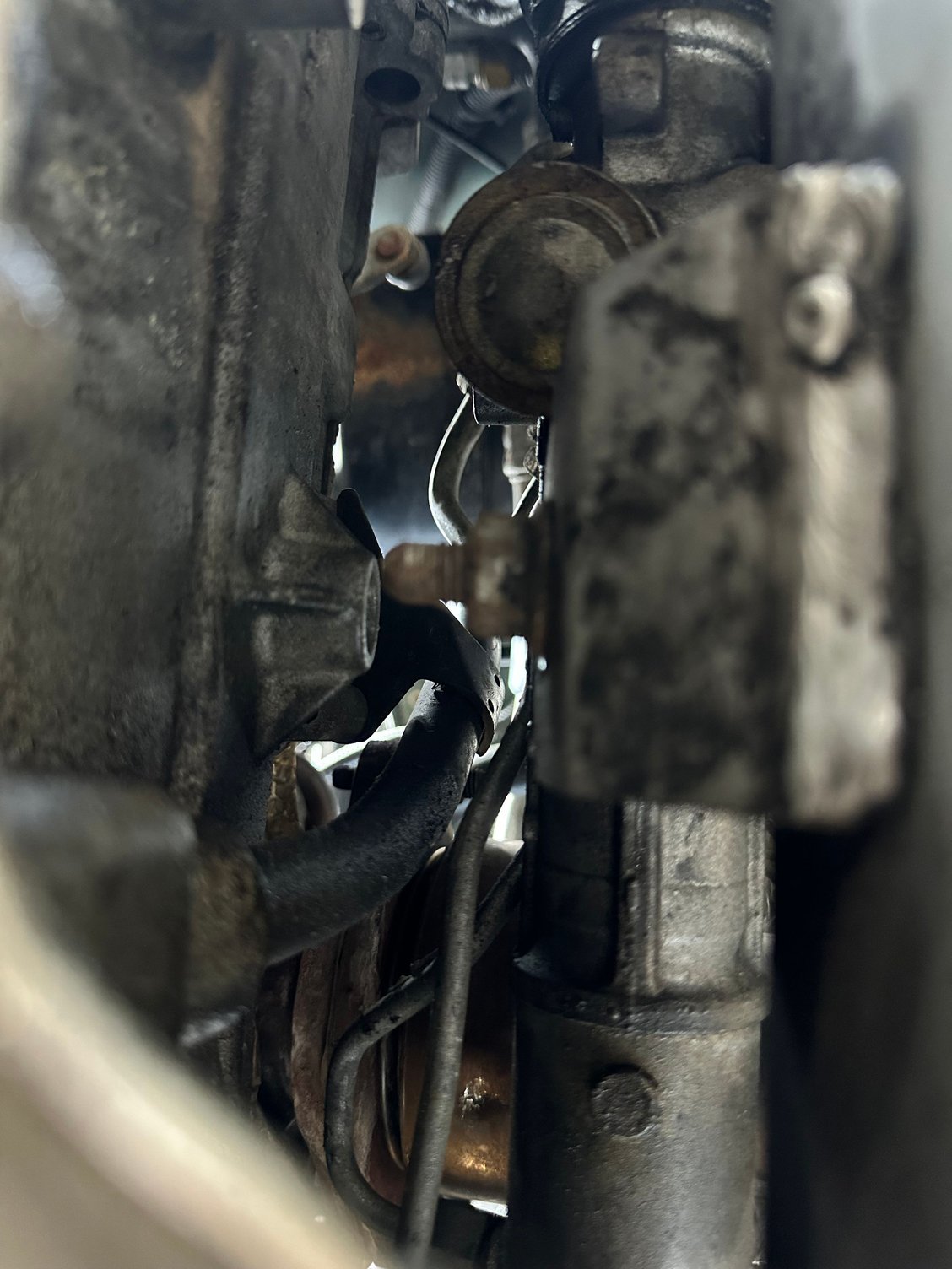

Something is clearly wrong around the rack. There are two bolts to hold the rack to the subframe. I see one of three-four problems:
- Broken/missing bolt
- Broken subframe mounting point
- Broken mounting point on the housing for the steering rack
- Rack was not seated and the bolt is just passing through the subframe mounting points (and not the rack's mounting point).
The side that appears to be the problem is the passenger side. I would get under there and see if I could get my hand on the rack and move it by hand. Perhaps get some mirrors and see what you might be able to see around the mounting points.
