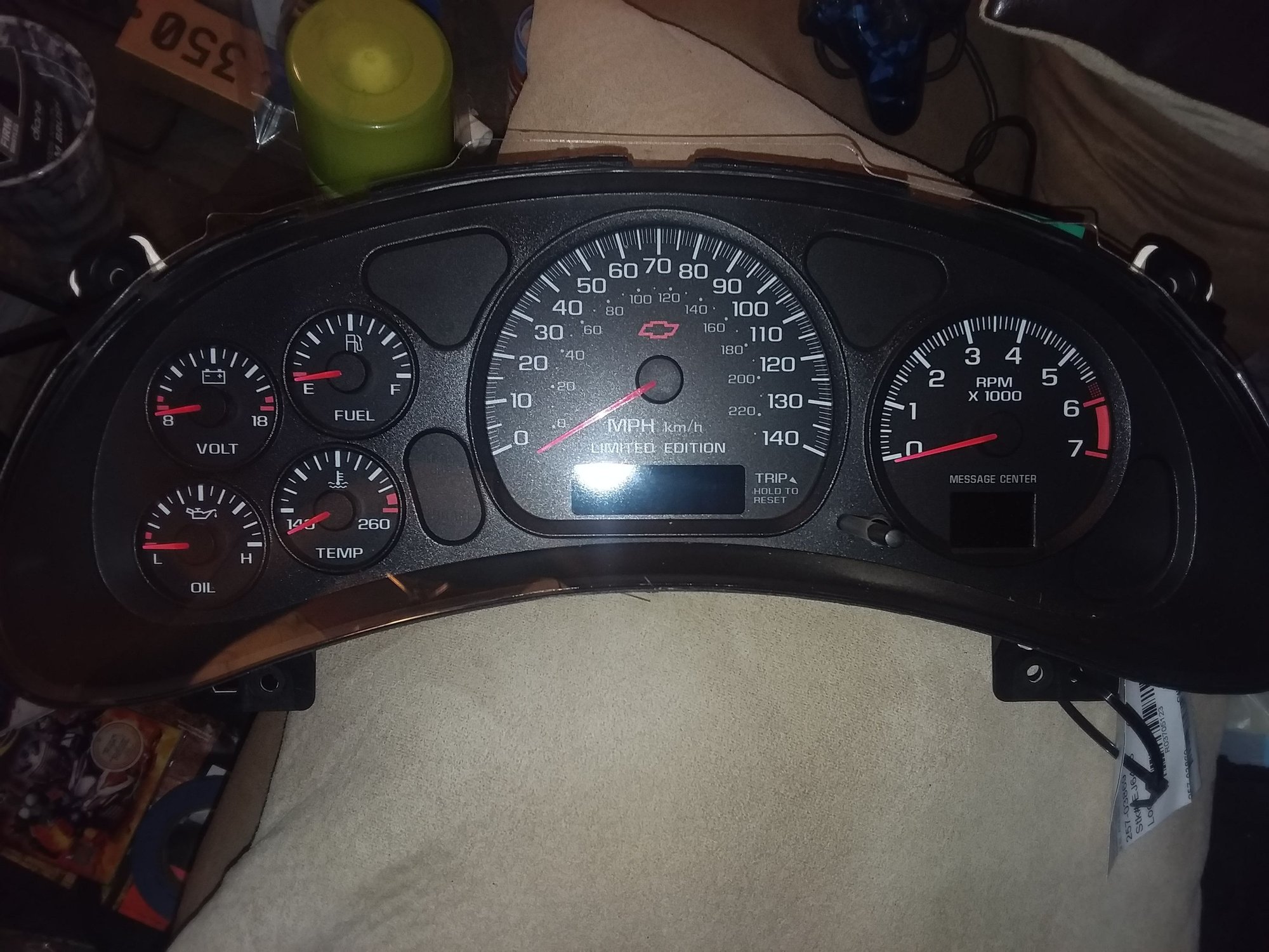

This is the cluster I wamma put in, in case anyone is wondering

The Mileage area is typically a group of failed solder connection to to some resistors or transistors (somewhere there was a write up on this). It's a simple re-touch with a soldering iron in most cases.
And as you said, the bulbs are a job that requires soldering.
I have not had to do it on the Monte, but the work is the same, I have soldering new bulbs and step motors on a cluster for a Sierra and a LeSabre. If you are OK with basic soldering, the job is really easy. If you are planning to keep the car for more years, you may want to invest in repairing a cluster, otherwise, you are installing another aged cluster with potentially the same problems coming up. Just food for thought.
I looked at the connector pin outs for the 2000 and 2002 Monte. It appears they are a match. So I might be wrong about the comparability. But something is telling me I read someone with an issue before. You already have the cluster, so worst that happens is that you plug it in and it does not work.
