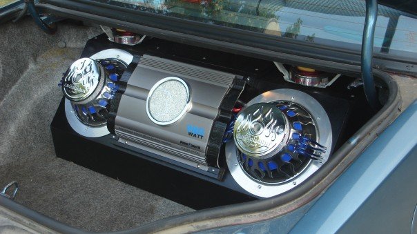

Brothers old subs and amp, they get transfered from car to car as we go because I can't afford to buy newer ones and these do the trick. The SS will be the 3rd or 4th car they will be used in.
Attachment 28798
Attachment 28799
