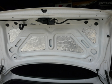

What did you use for sound deadner? just curious...

get robbed in the ghetto. jk most ppl have roadside assistance
i like the sound deadener that you used. i used dynomat xtreme and i like the way it works, but yours looks great on the trunklid. very clean. i havent done the trunk lid yet, cause i want a cover from bob. just debating on what to get on it.

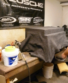

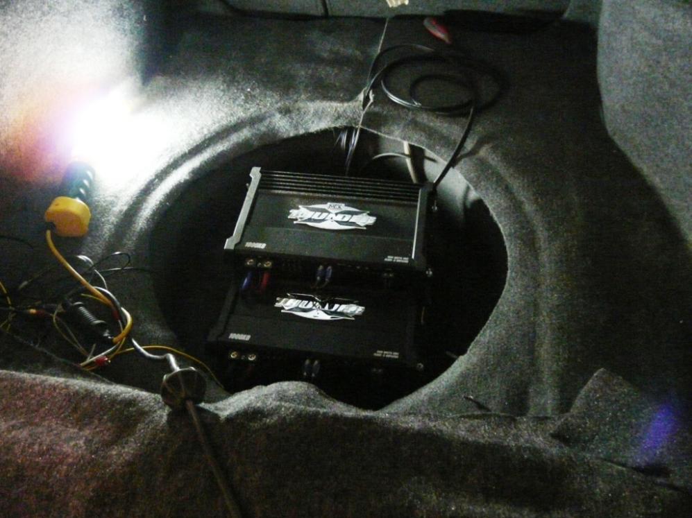

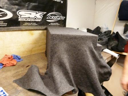

for the record I have AAA with the 200 mi towing range I have been dooing this for years (12)and only called a tow truck once

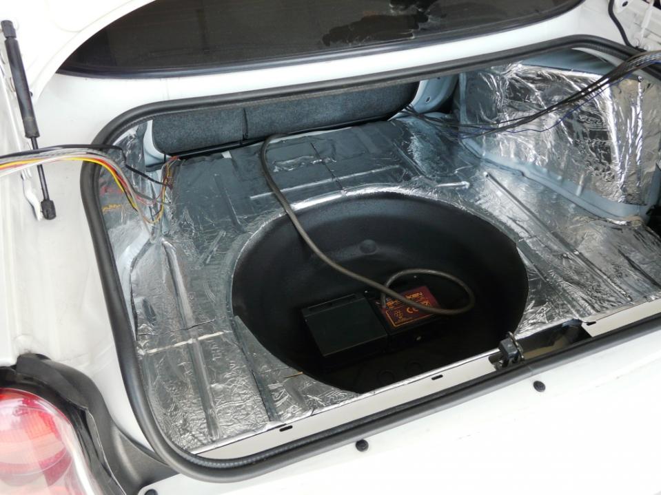

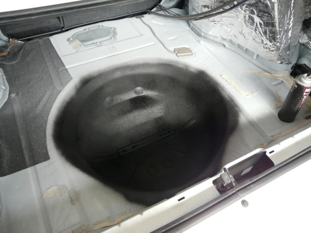

In the wheel well we used the cascade sound dampening spray in sound deadner and 2 layers of Scosche Amt060hf Accumat Hyperflex Sound Dampening Material in the truck and 1 layer on the doors and 1 in the trunk lid I made a down firring sub box so we put it on thick on the trunk floor so it would not rattle we also took out the 6X9s and factory amp and used those locations to port the subs into the car we will be testing the car for Slp in 2 weeks after the subs are broke in we are guessing some where around 162 db when I called my Mtx rep with the 6 cubic foot box and the sub and amp combo I have
i like the sound deadener that you used. i used dynomat xtreme and i like the way it works, but yours looks great on the trunk lid. very clean. i haven't done the trunk lid yet, cause i want a cover from bob. just debating on what to get on it.
Thank you I just went real slow and Used a rubber push tool to get it in all the cracks to help it from vibrating the main deck lid against the structural supports below bob is making mine now I can't wait to get it on we are making my leather cover panels next week to cover the the 3 amps and sound processor and 1 main to go over the box just to clean it all up
