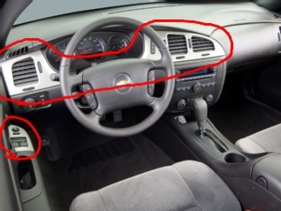

I need help removing these pieces on my 06 Monte Carlo. They're circled in the image... Im going to paint them and need them removed. Does anyone know how? Ill also need help on how to paint it so if anyone knows that as well to help me. Thanks

Highly doubt they come off that easy lol, heres a video for 00-05, but i would imagine its similar for 06-07
How to Remove a 00-05 Monte Carlo Dash-red04montels-HD - YouTube
Thanks Ill see if it can be done
I knew I kept these pictures for a reason. It is all one piece and it all snaps in. Adjust the steering wheel all the way down and carefully work the tabs. The pictures show where the slots are - it helps to know where to put pressure.
Wiggling the gauge cluster part takes patience. Weak spot is to the right of the gauge cluster. I used a plastic car interior prying tool.
For door panels, see http://www.barovelli.com/projects/ca...edoorpanel.htm
Dash with trim removed:
Right side
Left side
