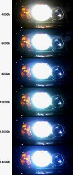

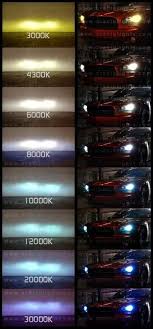

Here are some different color charts to give everyone some idea on the Kelvin temperatures
