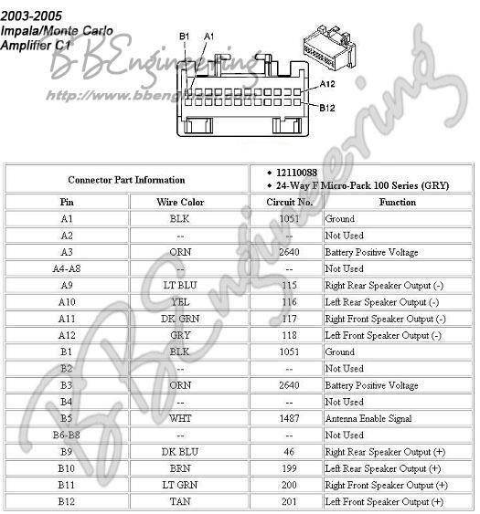

Old Oct 17, 2019 | 02:22 PM
Steelbizkit's Avatar
Joined: Jul 2017
Posts: 154
