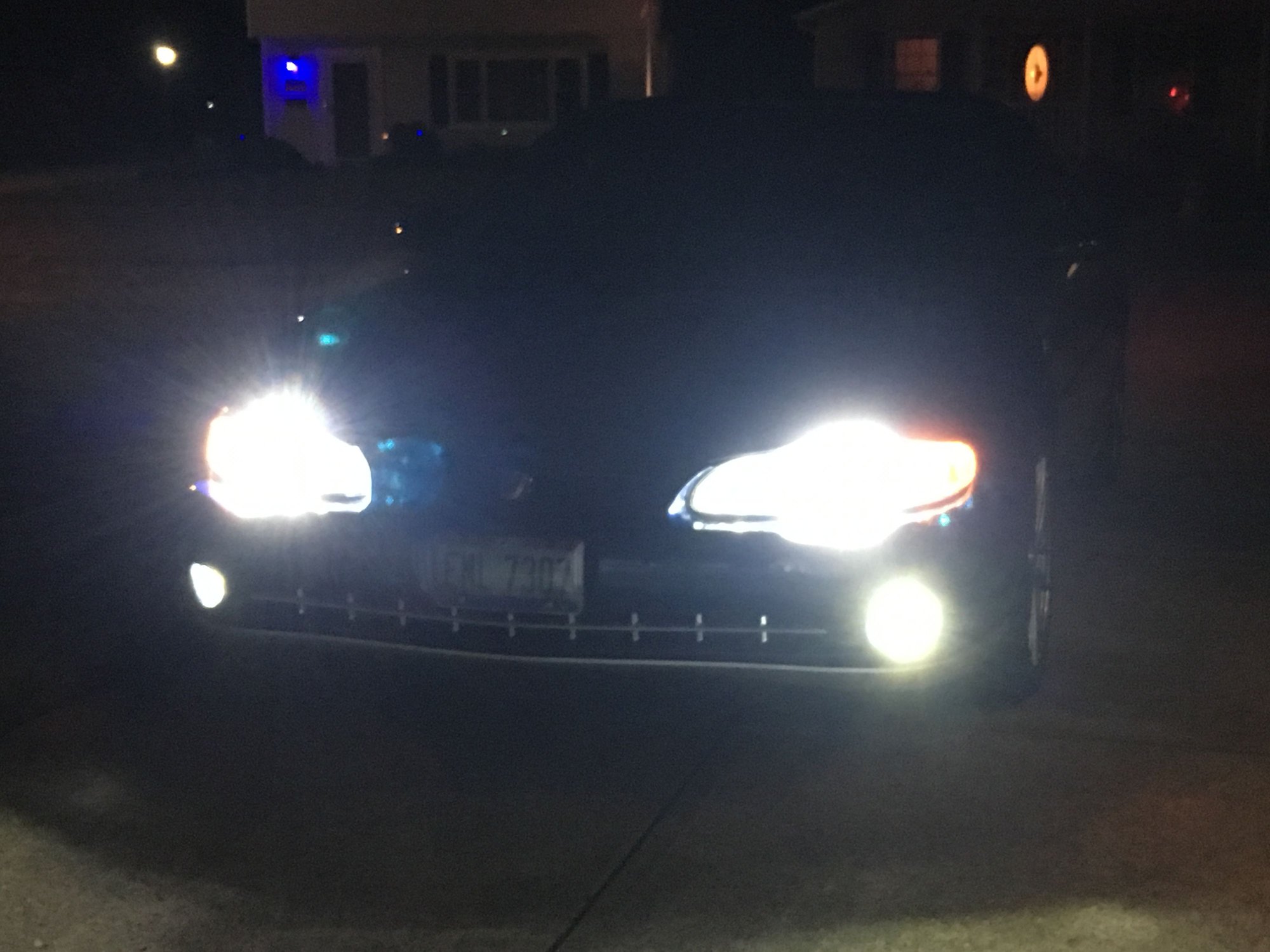

Here are some pics of the LED head lights and fog lights. Piece of advice I have read. When installing LED headlight bulbs, re-point the head lights a little towards the ground. The LED lights broadcast out so far you are not loosing anything, by pointing them just a little down you help avoid blinding other drivers.

Those things are BRIGHT!

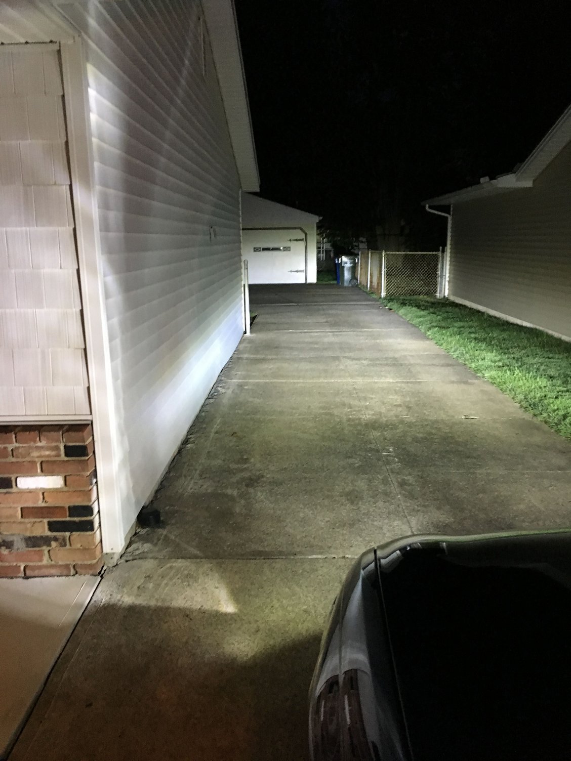

Windsheild veiw of LED headlights
LED 9006 9600LM 6k temp
Don't have a shot of high beams but run 12000LM 9005 bulbs.
Hikari 9006 led 9600LM

LOL! They definitely are. I have only used this brand in my Monte. I tried this brand and two others in my Grand Am (which uses the same bulb for low and high beams). In the Grand Am, this brand had the best light output. I sadly did not keep LED lights in the Grand Am, as I found all three I tried messed with my radio reception (but I have not had any issues in the Monte).
Honestly, in the Monte, only reason I changed out my high beams was to get LED DRL.
