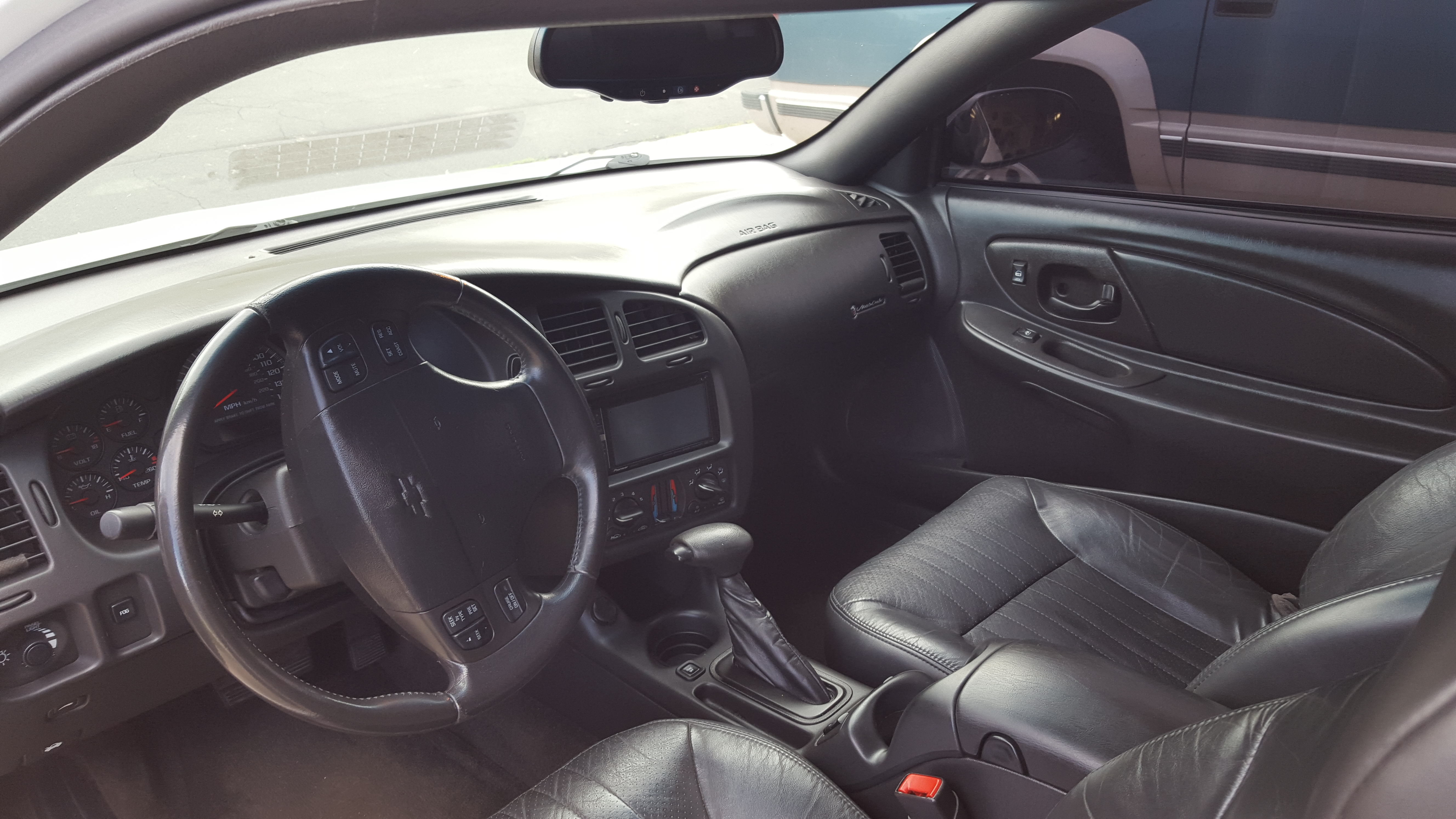

I did this on my 03SS and it wasn't that bad you do need to get a harness for the new radio but then there are a few items to keep in mind. If you have the factory amp there are some things to know. Your front speakers are a component system and the amp send highs to the tweeter and mids to the woofer. If you replace with a 2 way speaker it will sound off. Plus the factory system uses 2ohm speakers so if you use 4 or even 8 ohm speakers it wont sound as good. Also onstar runs its volume through the factory amp so if you swap it out you cant hear them, but they could hear you. Personally I yanked it all out and started fresh, A pioneer dvd nav head unit with a 5 channel amp with new 6.5 components in the door and 6x9 in the rear, with a custom sub in the trunk. It took some work but you can't beat the sound. Oh and if you want to keep steering wheel controls that will be a pain I never did get the mode button to work, but everything else does. I added some pics so you can see how I mounted everthing. In the second pic you can see I mounted the new amp in the stock amps spot and the crossovers for the front speakers are right there it all fit perfectly with a little work.
