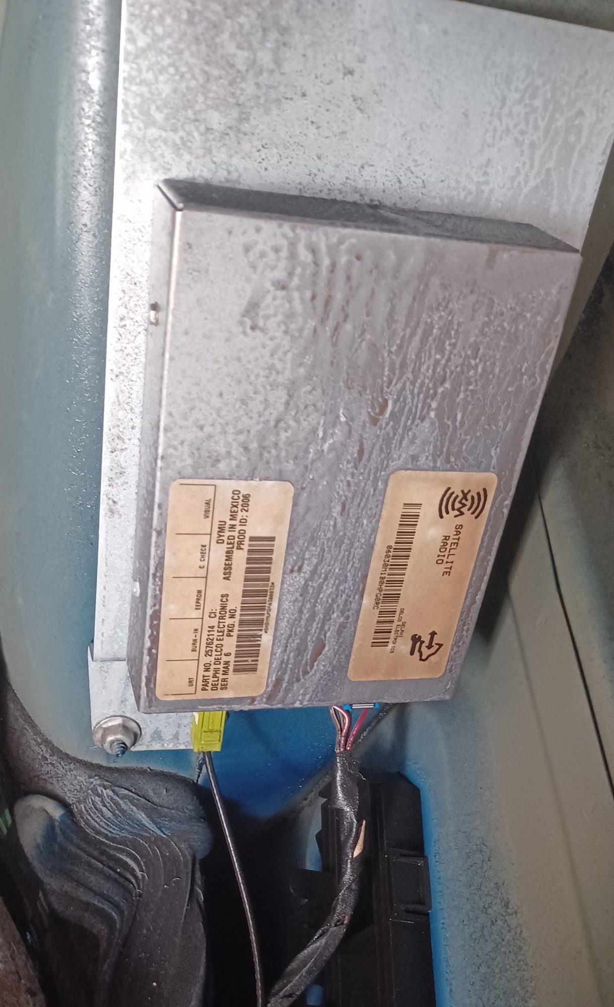

I was addressing a rust issue (imagine that) and pulled the carpet back on the right and there sat what appeared to be a small amp attached to the fenderwell. It says XM on it. So it could just be a receiver. I know my 05 MC had an amp it sounded great.

Also, XM came to the Monte in 2003, the receiver for it is right where you found it. I actually mounted a XM receiver and tied it in so my factory radio has an XM option, I use that to provide an AUX jack (so I never mounted the XM antenna since I never plan to actually get XM). I did mount the receiver in a more concealed space in the trunk, I am a bit surprised GM did not do the same.
