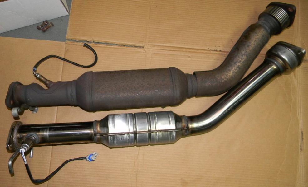

Here is a side-by-side comparison of the stock downpipe and the Magnaflow downpipe. The u-bend in the stock downpipe is a serious kink in the system for sure...Got everything installed and took it for a drive. Sounds good (not any louder), seems to rev a bit easier, runs smooth and strong. Very easy to replace with the car on 4 jack stands.
