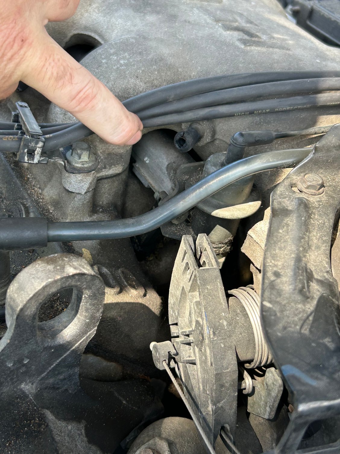

I have had this 2003 Monte Carlo LS 3.4L for 4 1/2 years. As of late, she is 20 years old and recently been acting up. I have an intake issue I cannot find. I am in Florida, I otherwise reside in Green Bay Wisconsin. I happen to be in a town. I do not know a lot of people here, so it is hard to find someone to help me without paying $150 an hour. I Instacart with my car, so she works really hard. My battery light comes on while I’m driving along with the airbag light and it resets from my tack to my original miles along with all the Diles flipping around. When I am on the interstate, she doesn’t act up because she’s getting enough air is what I understand. I’m at my wits end and I don’t know what to do. Any advice?

Believe me, I am way beyond your solutions, I have just yesterday replaced the alternator because the voltage regulator was bad. It was under warranty and I had the receipt, thank God. Previous to that I replace the MAF sensor and unplugged the battery for 15 minutes as instructed. My initial and worst vacuum leak was the turbo hole at the top of the motor. That is sealed off, front yard Mechanic style. But I still have my dashboard going crazy and there is another vacuum leak somewhere. Before all this, I just replaced my starter, I’m talking all this in the last 2 to 3 weeks. I’m hoping the guy that has this thread that is located in Ohio from what I read in another thread would let me stop by on my way back to Green Bay. I need a guru, I really need a pro to find this. She is a great running car, but just a little sick, cars are like pets. They can’t always tell us what’s wrong with them. I need a Monte Carlo whisperer.

Default Turbo hole
I don’t know the correct terminology, but it comes off the top of the motor for a racing addition to the motor.
Old Aug 19, 2023 | 01:09 PM
Posts: 4,160
Manifold/vacuum nipple. Its used on other vehicles with the same engine. Just cap it off.
