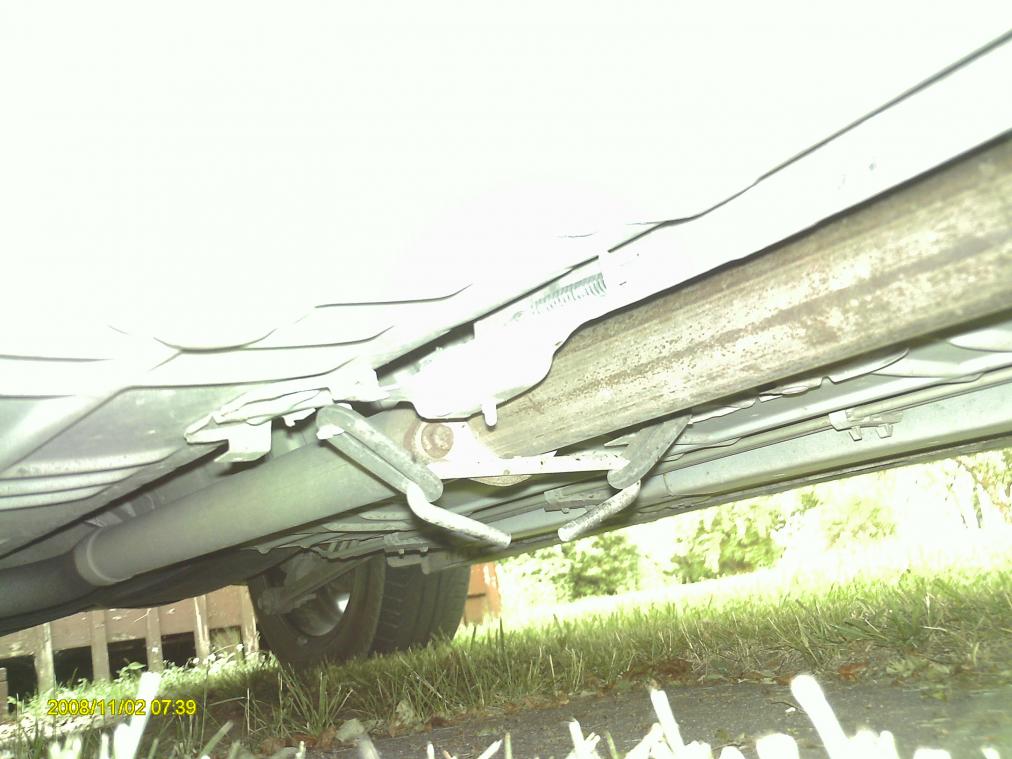

IMHO, and Im not bashing you, if you like em, get them. But I think glasspacks are the stupidest things ever invented, I would get an electric turbo before Id get glasspacks. But what I would reccomend is just piping it from the rear manifold to the mufflers then throw some nice angled 2.75" chrome tips. What I mean by "pipe" it is the downpipe and res delete, somthing else you could do (and this is probably out of the question but, after the 2.5" downpipe you could upgrade the piping to 3" to get a little deeper tone) (I did this cause the guy who did my mufflers did it for free, and he only went up to 2.6" which is better than 2.25" that stock is.) But if you do decide to do the bigger pipes, you need to remember the downpipe HAS to be 2.5" so you have the proper restriction. Heres a pic of the downpipe and res delete>>>>
The pipe towards the right of the pic is the ZZP downpipe and the pipe towards the left that looks newer is the resonator delete pipe.
