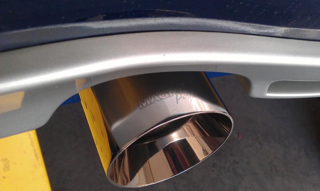

Just get ur mufflers & tips & the exhaust shop will take care of the rest, I got Magnaflow tips on mine i think they look pretty good

Thanks 03JGMonte, Thats about the size tip i'm looking for. The ones that come on the 06 SS are a smaller diameter and they just don't fill the space around them enough
Oh and I have to ask, What is the outlet size on you're tips? Just so I have an idea on what to look for, since I like that size.
Old Jan 30, 2013 | 08:40 PM
There 4" tips so they fill in the space nicely tips can really set off a car, & yeah the factory does put some dinky tips on there cars mine were tiny
