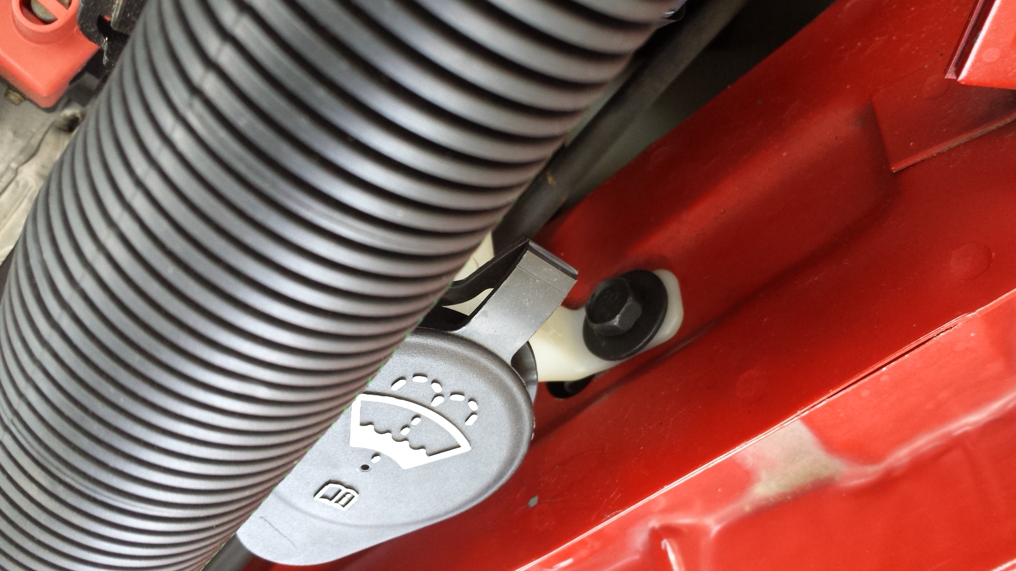

Hi everyone, I have owned 3 different 2000-2004 Monte Carlo SS's over the years and always noticed that the windshield wiper filler bottle neck seemed to be loosely attached with a rubber gasket to the filler bottle. Seemed like they were all missing the bolt to hold it to the fender. A closer look shows that there was never a bolt there in the first place. But for some reason GM designed the front fender with holes in it to put a U-nut in there. I found a large U-nut and a bolt/washer to fit it perfectly. First I put the U-nut into the large hole and tapped it forward until the threaded hole lined up with the small hole in the fender. Then a gear wrench made putting the bolt with washer in nicely. So the final result is how the factory should have done it but to save a couple of pennies never did! Hopefully this tip will help you finish your engine bay and make the filler neck permanently attached to the fender.

Not sure why that photo is upside down lol but you get the idea!
