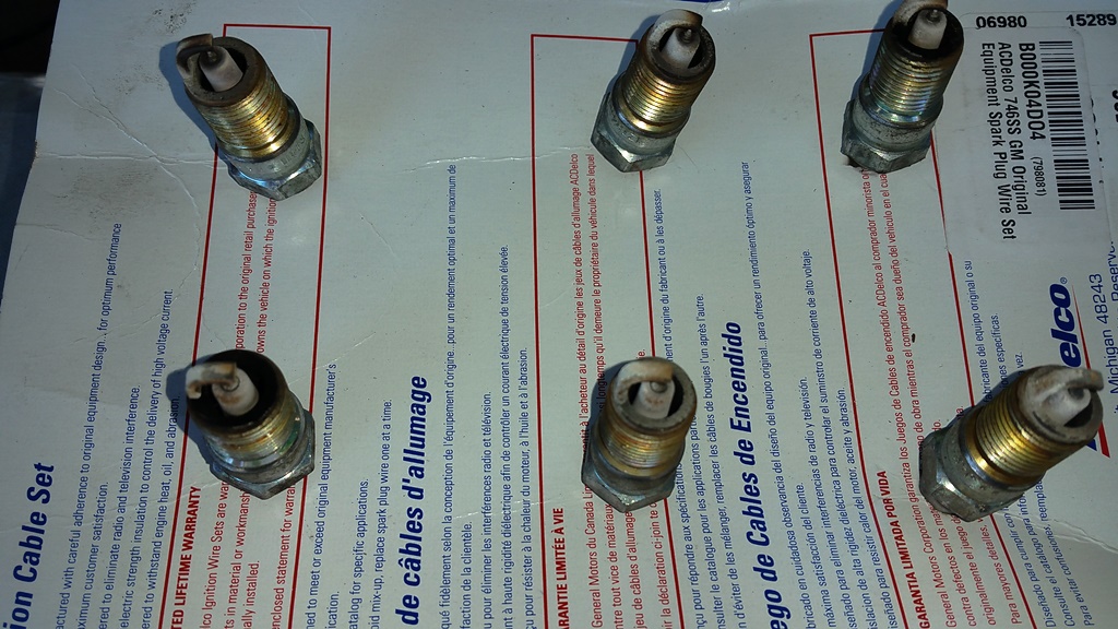

Monte is just a couple thousand miles short of the 200K mark and here I am this week with more time than money (used to be the other way around, ha ha). So with plugs and wires (Delco all the way) ordered online it is time to get dirty. I disconnected the engine mounts and pulled the engine forward with a tie down. Also removed the coil pack since the @#$ boots were stuck on, otherwise would have left it there,
Here are 2 pictures of the removed plugs, they worked for at least 150,000 miles.
What seems to be up with #2 cylinder? too wide a gap leading to fuel fouling?
Driving is mostly highway miles. Car has been a little rough when cruising at 25MPH, I was hoping that new sparks may smooth things out at least. A shakedown ride was good (car still runs, I didn't break anything) and the 25MPH point was behaving.
Thanks for the tips and encouragement -
