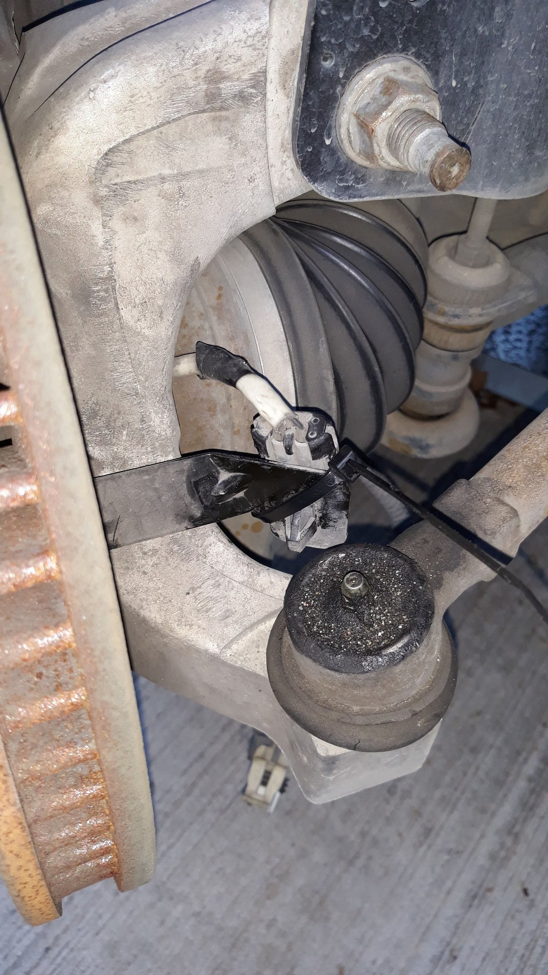

Originally Posted by RedandBlackSS
Now I have an intermittent ABS/Trac control light, I suspect a bad wheel speed sensor.
Working my way through the list of issues, one at a time. Getting there!
Make sure you check the front harnesses, I had the ABS/Traction issue on and off for years, which I temporarily "fixed" by unplugging the harness at the wheel. Eventually, that didn't work and I discovered the left harness had flexed during turns and broke the semi-flexible sheath and the wire was frayed to just a few strands. No problems since I replaced the wires from the cradle to the plug. Also, secure your sensor plug like this to make sure it isn't getting pulled.
