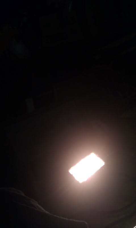

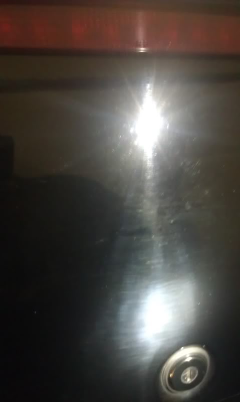

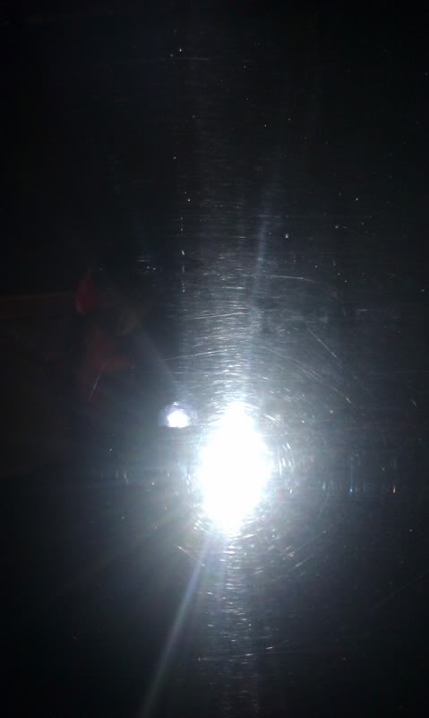

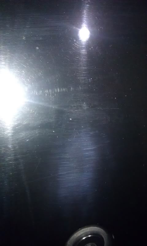

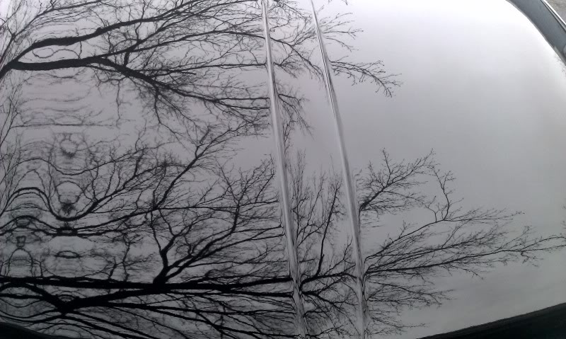

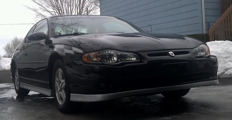

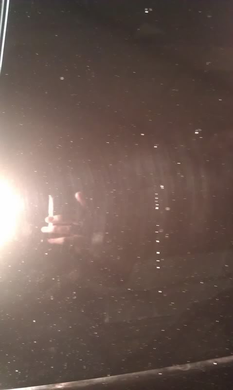

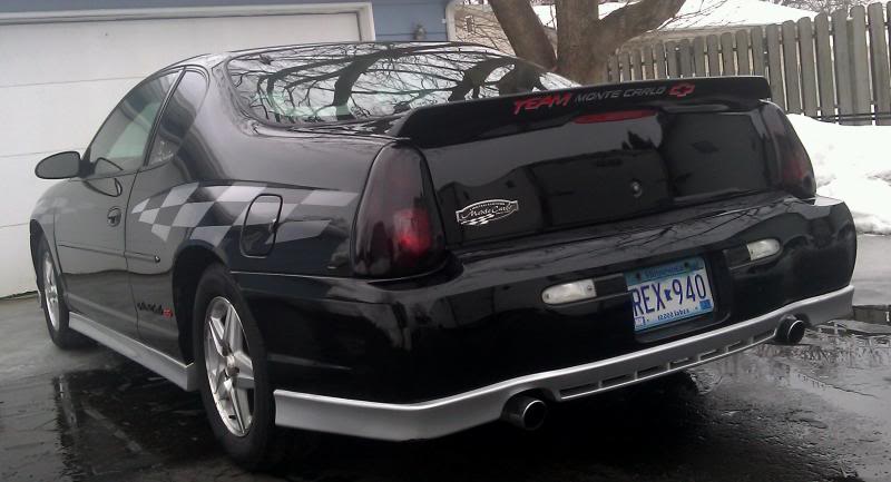

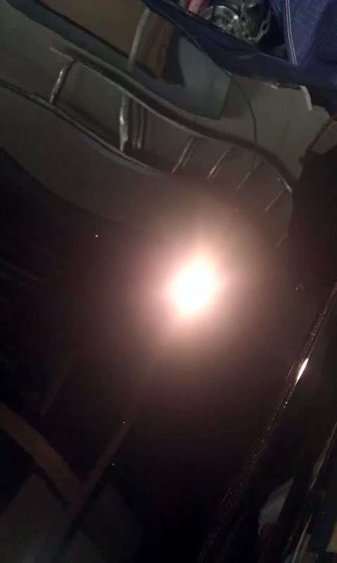

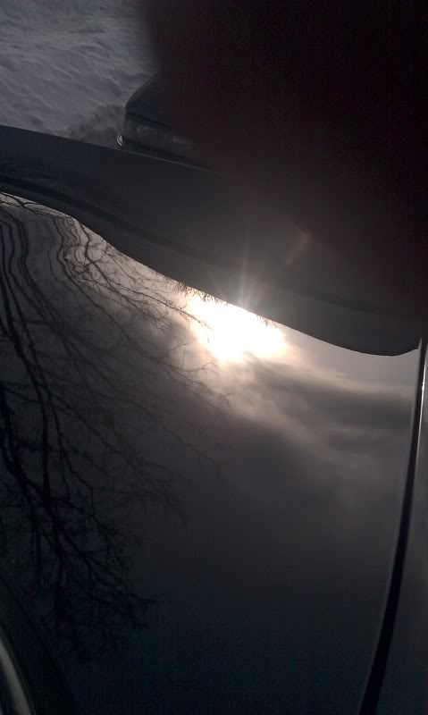

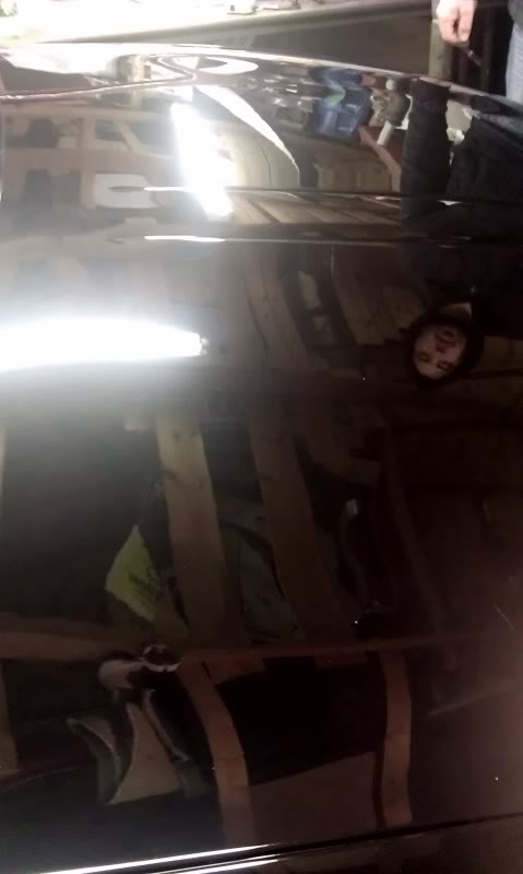

Did a Full Correction on the pace car this weekend here are the pics
Processes
Simple self serve carwash, 2bucket
Chemical Guy's Citrus wash and gloss Diluted to strip old wax
Clayed(Megs Consumer kit)
Groit's Garage 6in Random Orbital buffer(DA)
Meg's D300( correction compound) with 4in Microfiber pad
Megs Ultimate Polish with White pad
Megs M21 Sealant with Black

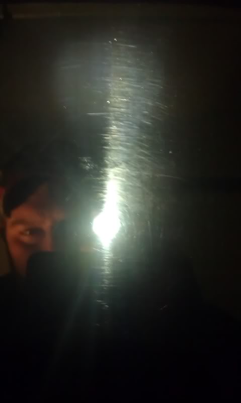

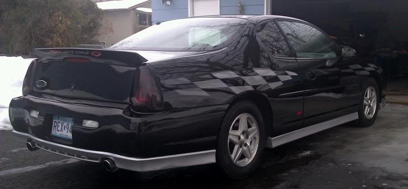

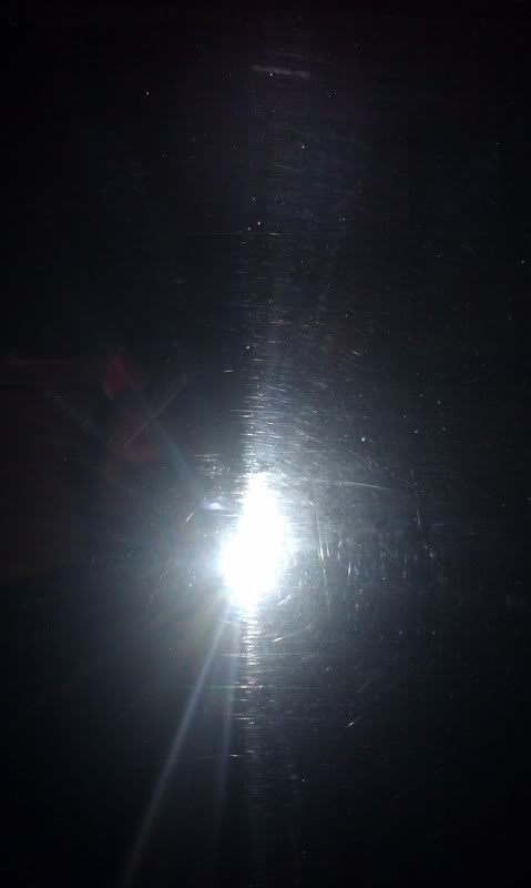

Before shots

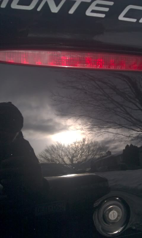

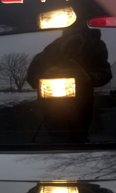

Some Work done on the Trunk
(left, Right untouched)

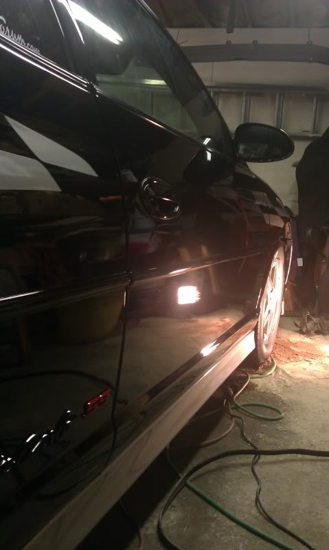

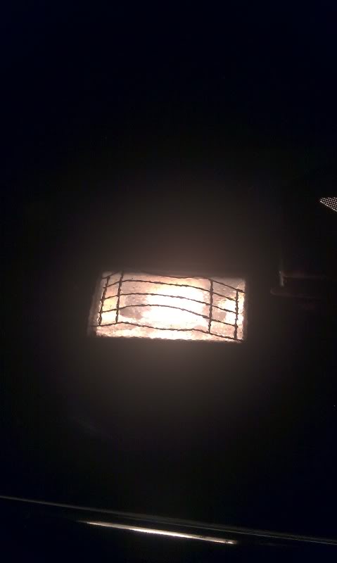

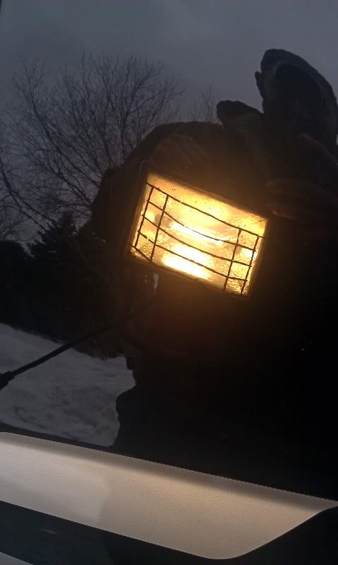

As i worked tool pics

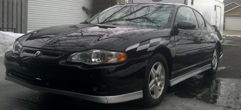

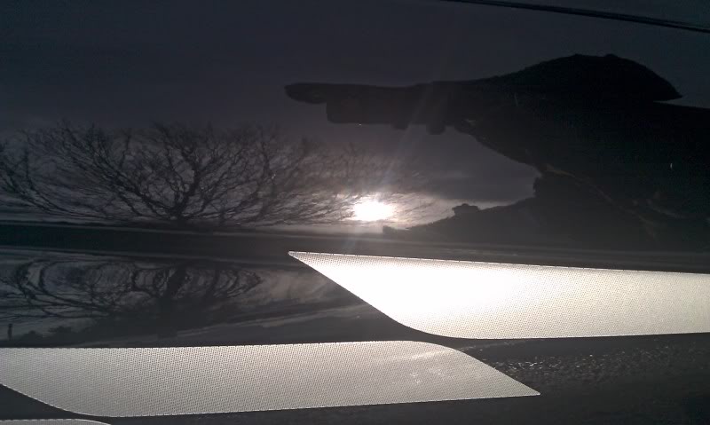

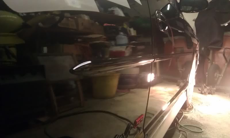

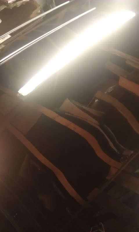

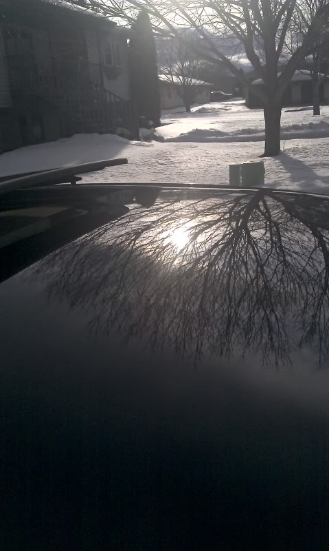

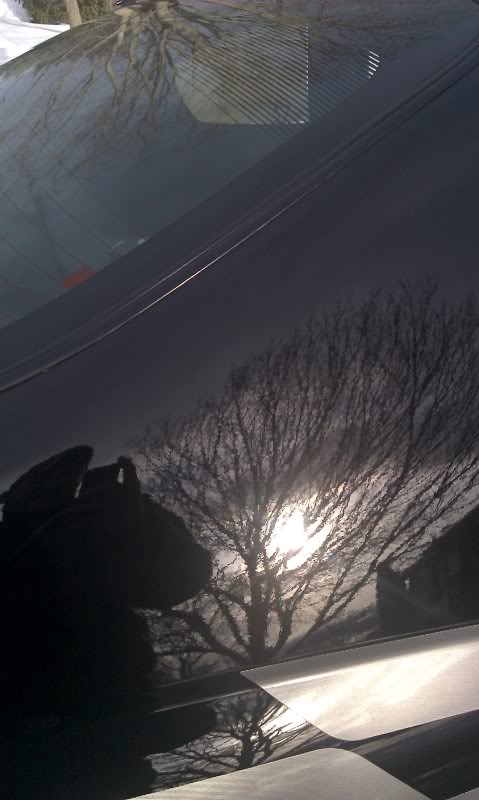

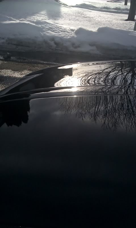

outside/ after pics

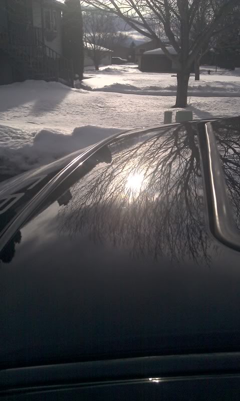

Some sun shots i was able to nab at like 5 only time the sun was out today!

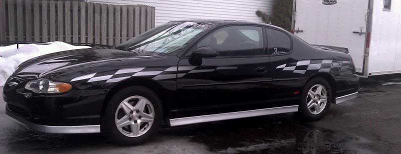

Is working around the pace car decals annoying?

I can't even tell you how much tape i went through taping them bastards off for compounding.... But so worth it being able to get inbetween them!
When i got done i was WOW'ed! Sorry but pics at this point don't do it justic! Dang cloudy day, atleast there was none of that fluffy white stuff falling from the sky!
