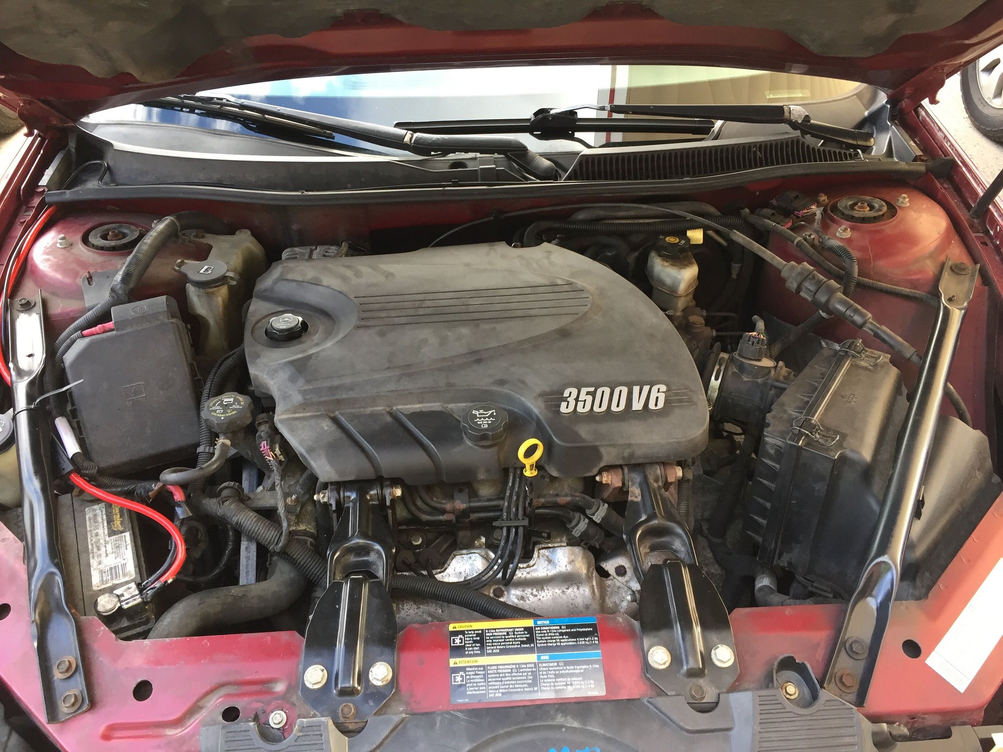

So I bought the car used and I kind of want to just build the whole thing up and make it badass . I’d like to do it myself I do have a decent amount of mechanical experience but not a pro by any means. I just love the car and want to build up the engine with performance parts without turning it into one of those lame fast and the furious cars lol but I wanna do engine , suspension, and whatever else.i have tools and a lift I can use as well hope this helps thank you

The biggest thing with a 3500 is a tune. There isn't too much with performance on those cars unless you start doing some custom fab work yourself. But there is some good performance left on the table with that engine, and the transmission is just awful at stock.
I would clean up that engine bay and make sure you don't have any gaskets leaking, really hard to tell from how dirty everything is.
Depending on the mileage, I would start replacing some suspension parts to get the car riding really well too.
And just clean it up, get a nice new set of tires/wheels, and enjoy what you have. The 3500 can be pretty reliable, though no powerhouse of an engine.

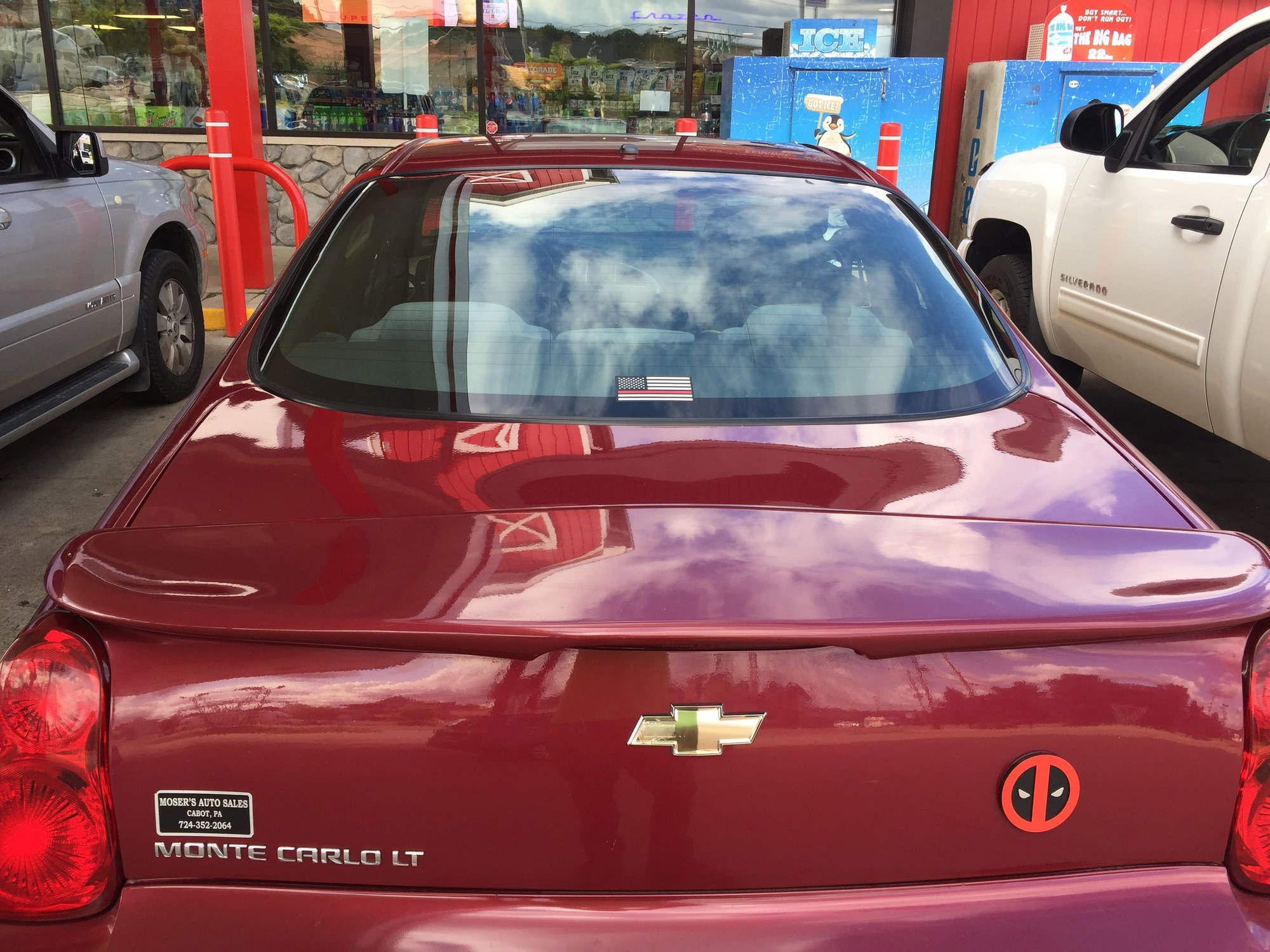

The 06/07 SS stand-up spoiler will be a direct swap for your ugly flat spoiler too if you wanted a little change there. Sometimes the old spoiler will ruin the paint underneath and pull a little far, so the top of the trunklid might need a sanding and respray, but a body shop can blend under the spoiler so it's not a FULL trunk-lid repaint if you don't need it.

A lot of rags that you don't care about, and a bottle of simple green. Just start spraying and cleaning it all up. Right now if you had an oil leak on a valve cover, or something else, the engine is just so dirty that you would never see it.
