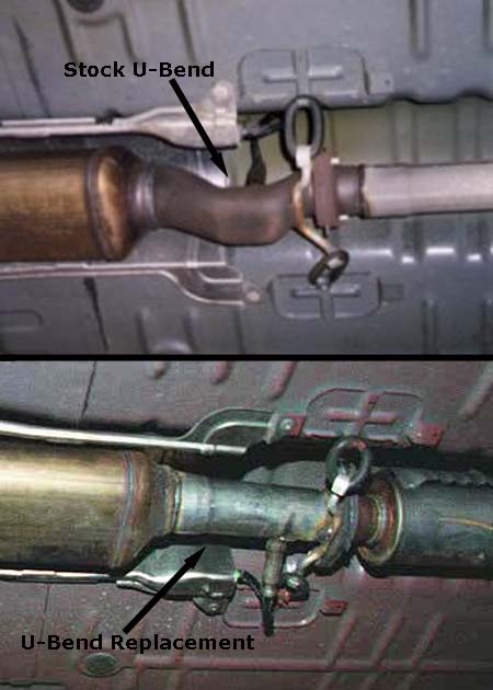

as far as the U-bend, do a search and some pictures should show up in some threads. its a part of our downpipe that was created from GM to increase the longevity of our exhaust systems. it has a big "U" in the pipe to shield the o2 sensor, and that U shape really impacts the power made from the exhaust.
it will give you a seat in the pants difference just from switching the downpipe. no more lag.
if you get the zzp downpipe, you dont need to buy a U-bend delete. the zzp downpipe replaces that and it also includes an o2 sensor plugin.

Here's a pic of the exhaust with and without the U-bend.
The top is with the U-bend, the bottom without.
